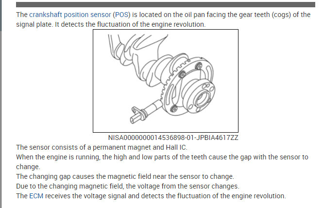

Replaced crankshaft position sensor and cam shaft sensor. engine cranks but want start what is the problem

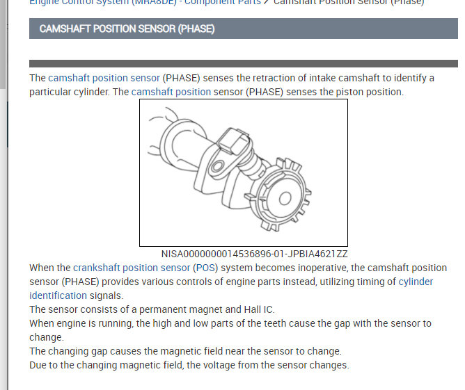

Was the vehicle starting prior to replacing these sensors? If so, what was the reason for replacing the sensors?
The only thing that really makes sense if the vehicle was starting prior to replacement would be one of the sensors is faulty.
What I would suggest doing is reinstalling the other sensors and seeing if the engine starts again. Clearly if there was another issue then you will have that issue return but at least you know one of the sensors was the issue. Which means I would replace one at a time to find out which is the issue.
https://www.2carpros.com/articles/camshaft-angle-sensor-replacement
Below is some info about these sensors as it will help with knowing what the issue was that you needed to replace both these sensors.
Let us know and we can go from there. Thanks
