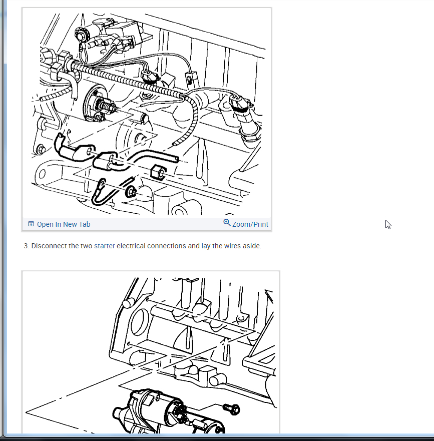

Crank no start
130,000 MILES • 1.9L • 4 CYL • AUTOMATIC
HALEY BROOKE
No RPM's, loud grinding noise.
Dec 25, 2020 at 12:21 PM

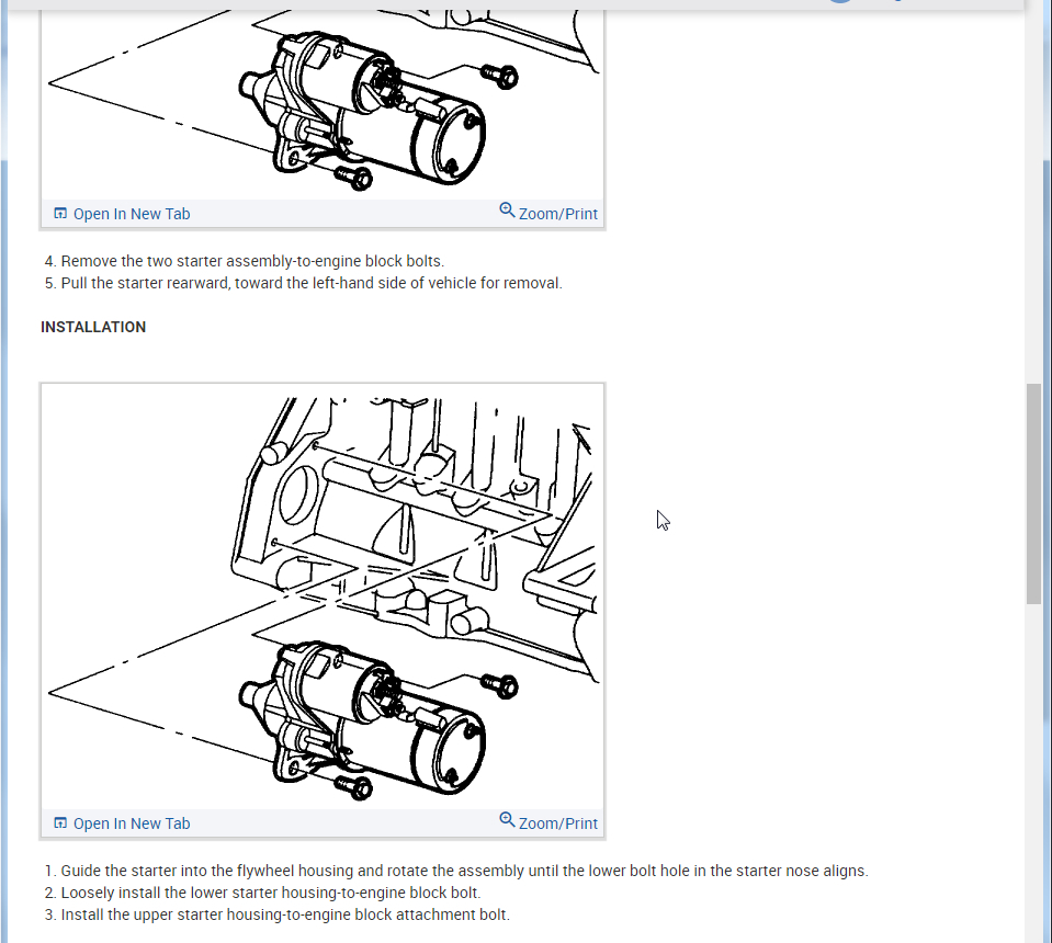

Is the engine not starting and when you are trying to start it you hear the grinding noise? If this is the case, this sounds like a starter issue. However, here is a guide that will help with an engine not starting:
https://youtu.be/dCjmRL3p4Cs

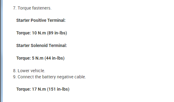

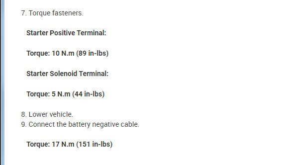

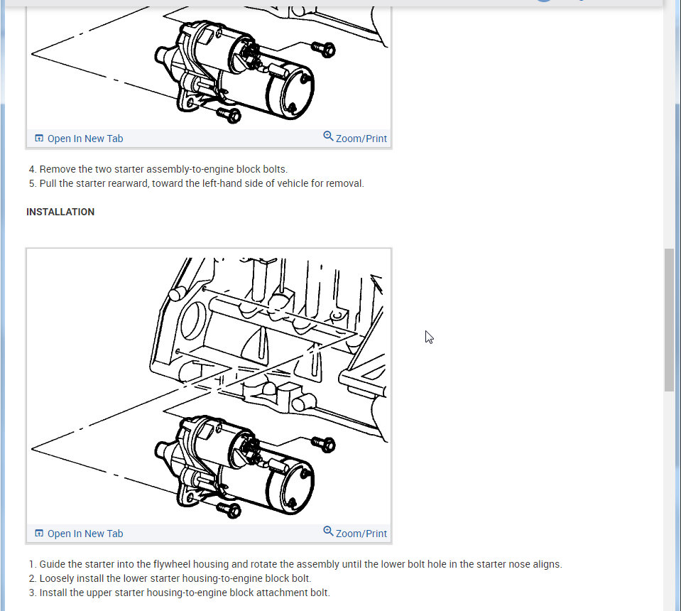

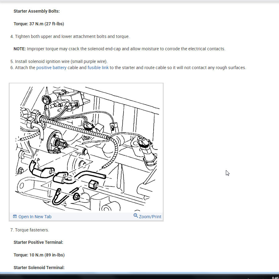

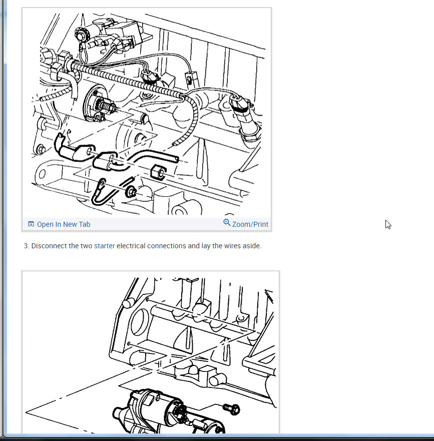

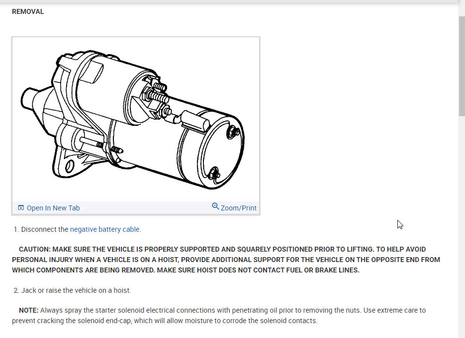

If this is what is happening then I suspect the starter needs to be replaced. Here is a guide that will help with this:
Also, below is attached the process from the manual on how to replace the starter.
