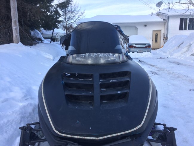

I have a 1996 Polaris Indy XLT Touring that will not start. Fuel not filling the filter and it is a pull start therefore has no electric start. I have tried using starting fluid, no start when put in either intake or cylinders. Oil, coolant, and gas are all full. Attempted to heat carburetors, no luck. Fuel is on and there is no blockage from tank, but filter will not fill. It is cold outside so not sure if there is frozen gas or what but what should I do?

A little squirt of ether, at minimum, should have made a pop or two if spark was present.
as far as fuel moving in the lines, maybe you have a cracked hose/hose loose on a nipple/the fuel pumping system is inoperable.
This is basically like working on a high speed/low drag lawnmower!
Actual hands on and inspecting stuff is what it needs.
I am by no means trying to sluff you off, I promote DIYing when possible!
I did find you the PDF service manual for you.
Maybe it can guide you through the checks and testing. Link below.

Thanks for the quick response! I will check the fuel pump. It does make a pop and sounds like it wants to start, but does not even with no ether it makes a pop sound. Although that sound may just be what the sled makes for a sound. Is there anything that would make the plug not spark while installed?

Do you have the body of the plug body grounded to a good ground while pulling away on the cord?
