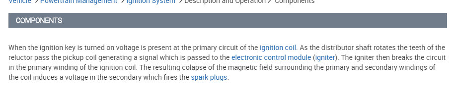

Take a look at this attachment. It explains what is happening in your system which is a pretty standard distributor ignition system.

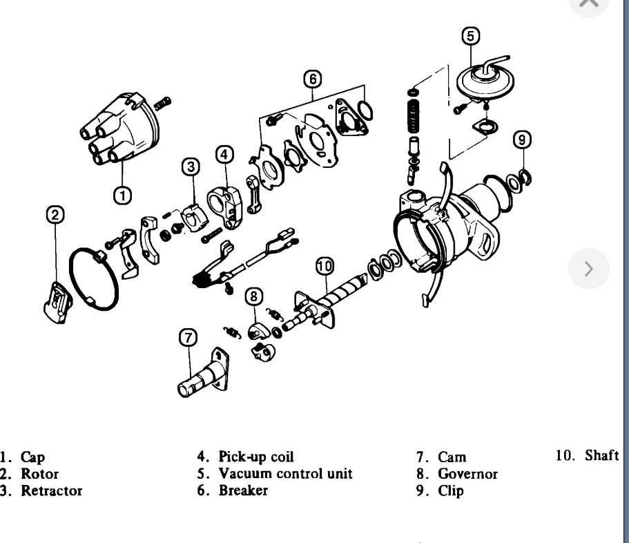

If you have no spark then I suspect your issue is the pickup coil which takes your primary spark from the coil and sends it to the igniter where it breaks the signal which creates your high voltage that the distributor sends to the proper plug.
If I am correct, you may be able to get these part individually (pickup, igniter, distributor) but sometimes your only option is to replace the entire distributor which will come with all of the components.

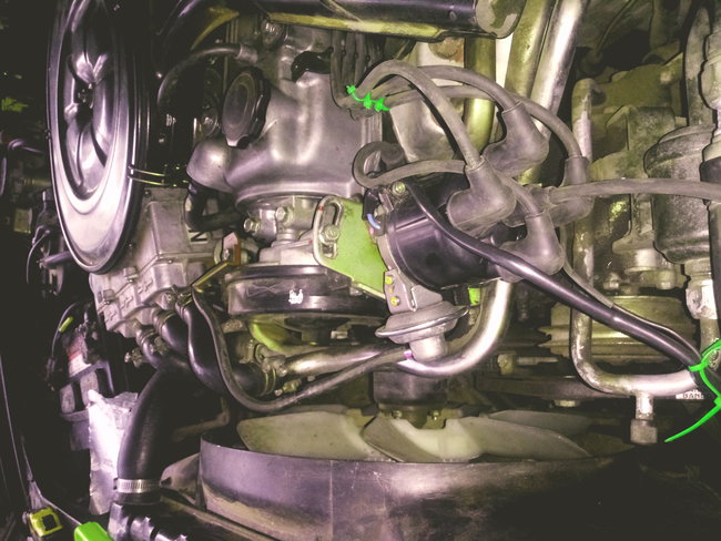

I have replaced the distributor pickup, cap , rotor , plugs , wires and also coil. House for rent all the vacuum lines there were a couple broken fix them and all connections needed a little help. I have 12 volts coming from coil I have 12 volt at pickup in distributor no spark from distributor to plug. I'm at the same spot no spark from distributor.

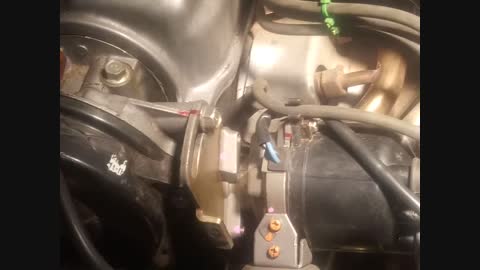

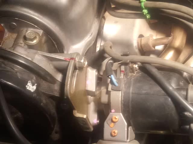

this will be my sixth try to reply to you I don't know why but they're not uploading. anyways, here's a video my timing is out I installed it the same way I took it out. my internet signal is not good so I'm going to send just this part and then I will try and send the video and a separate one. because it won't work through this.

That is great. That engine sounds out of time. You can hear it catching on one cylinder which is typical of an engine that is too far advanced.
So if you said you now have spark and fuel, I would retard the timing a bit. Basically, what I would do is loosen your holding nut for the distributor just enough that it holds it in place but you can move the distributor by hand. This will keep it from moving when you don't want it too and keep you from moving it too much at once. Then retard it just a bit and crank it again. More than likely you will hear a difference in the engine. It may not fire but if it sounds different then you are on the right path. Retard it a little more and I bet it will fire. It may not run well until you tune it in but this is just a feel game until the engine is rolling over smooth. Then tighten everything down and you are good to go.

I have adjusted it this far and it's trying to fire and I ran out of battery juice. so I'm charging the battery. do I need to adjust the distributor back a whole gear? I really have no idea what I'm doing here. might end up calling the mobile mechanic.
Aug 23, 2019 at 12:59 PM
Okay. While it is charging just go back over your plug wires and make sure they are correct. Going to the right cylinders and going around the distributor the right way. I have done that before where the rotor spins in the opposite direction then I thought. Worst case pull the cap and crank the engine to see which way the rotor spins and then you put the plugs in firing order going that direction.
