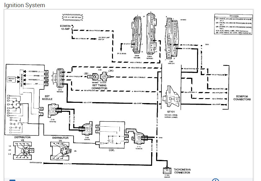

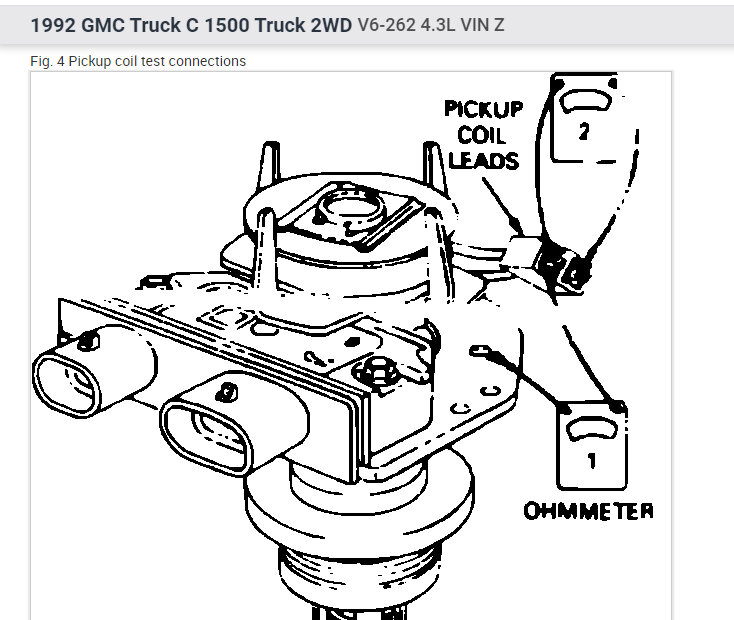

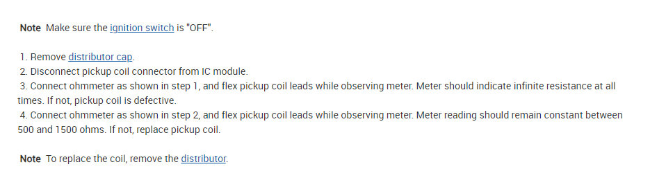

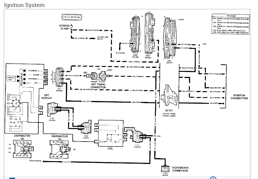

Also, we need to make sure the pick-up coil is working. I attached the directions for testing it below. Note that I also attached the wiring schematic so that you would have a reference. The only one I have is the OEM schematic, so it is a little difficult to follow. Let me know if you have questions.
Let me know what you find.

I hope you had a great holiday – finally got some time to do these tests. The rotor is turning as expected. I'm getting power to the coil testing via the tach connector on the harness. I also back probed the pink connector to a test light and didn't see any pulsing as the truck was cranked.
Checking the pick-up coil resistance, and it was all over the place. I think it's safe to say it's a faulty pick-up coil. I couldn't get a consistent reading off my meter any time I've checked it (even without bending the harness).
Safe to also say, the distributor is original to the truck, so I'll probably just replace the whole assembly – I can only imagine the wear on that gear.
If you have any other ideas or thoughts, I'd love to hear them. Thanks so much for your help!
Dec 2, 2023 at 7:51 AM
  • 110,194 POSTS

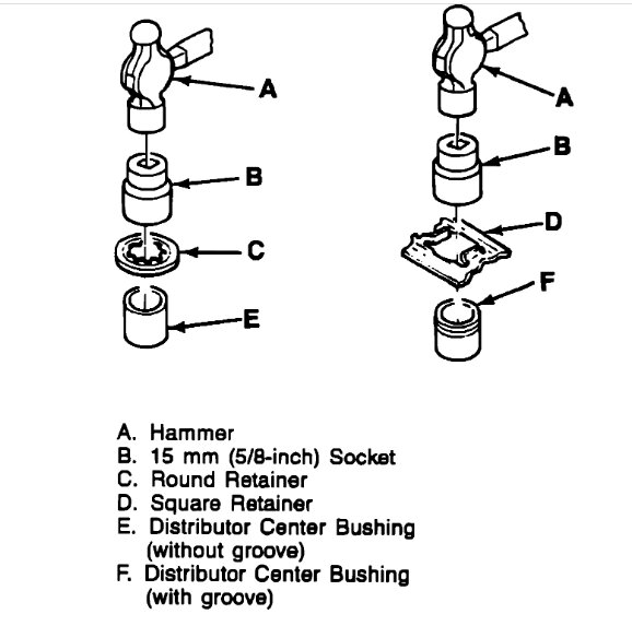

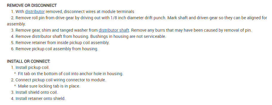

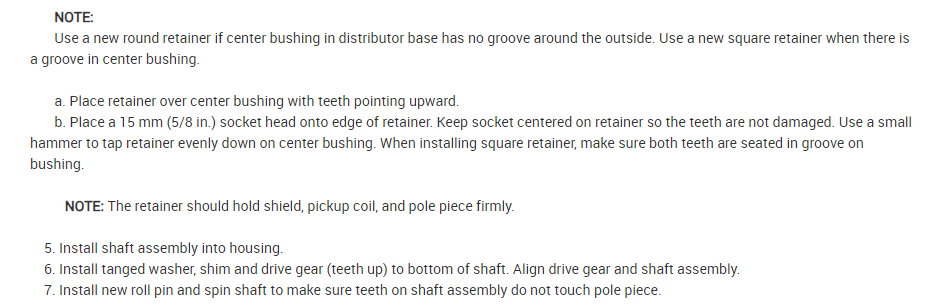

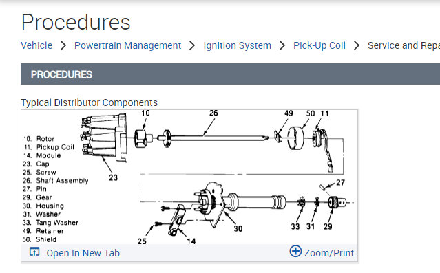

It does sound like that is the issue. I don't know if you want to replace the pick up itself, but I attached the directions below if you change your mind.
If you have a chance, let me know how things turn out or if I can be of more help.
