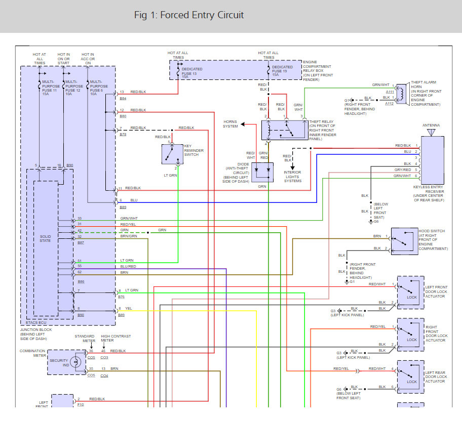

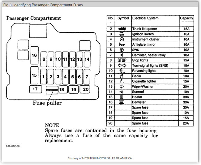

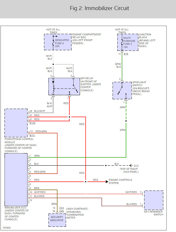

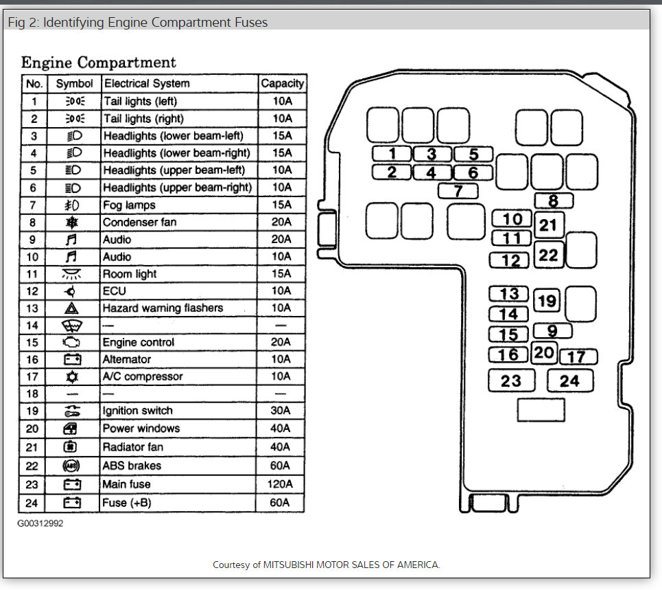

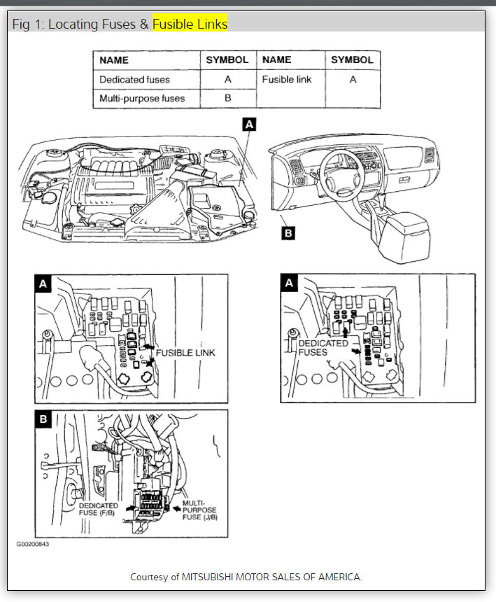

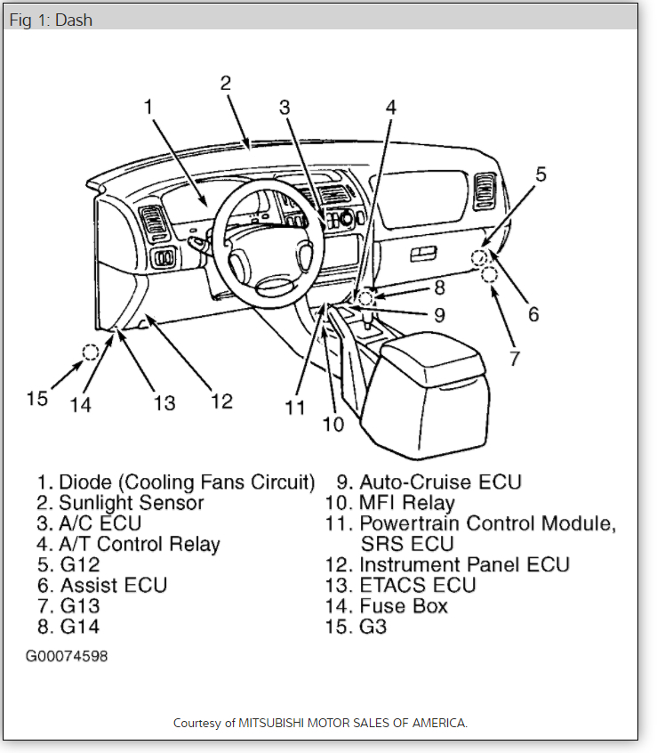

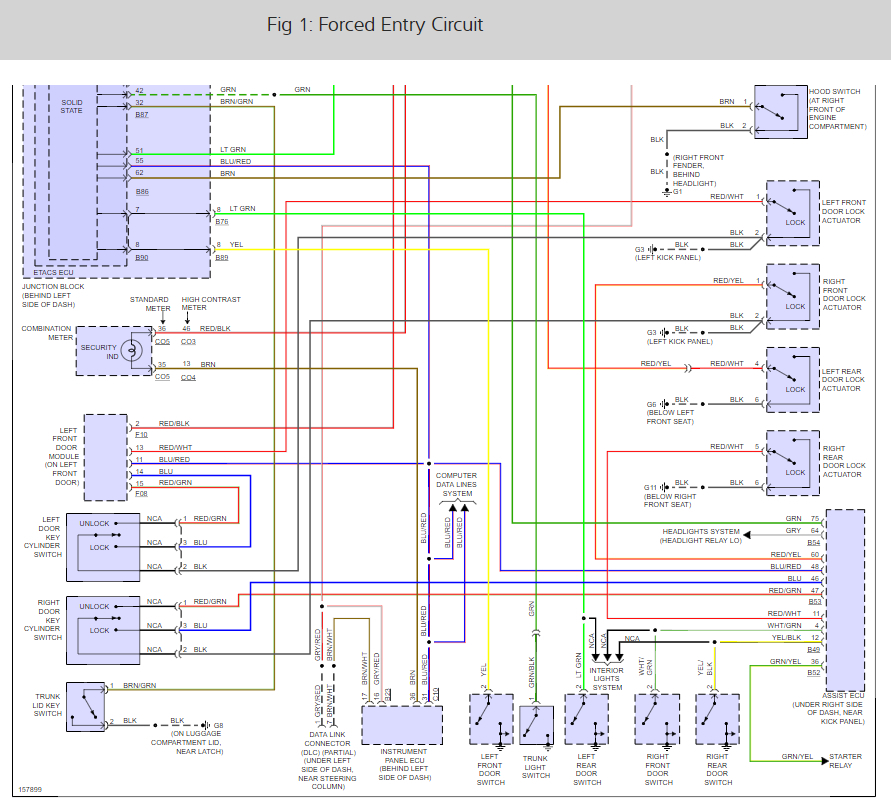

It sounds like the key lost is programming which happens, but first I would check the fuses that run the system.
Please check fuses: 3, 9, 13 and 19.
Jan 23, 2018 at 2:38 AM
BENJAMINESLADIES
  • 5 POSTS
Thanks for the diagrams, very helpful information! I have checked the fuses under the dash thoroughly. I have looked at the engine compartment fuses but I will give them a more thorough look when I get back home later this week.

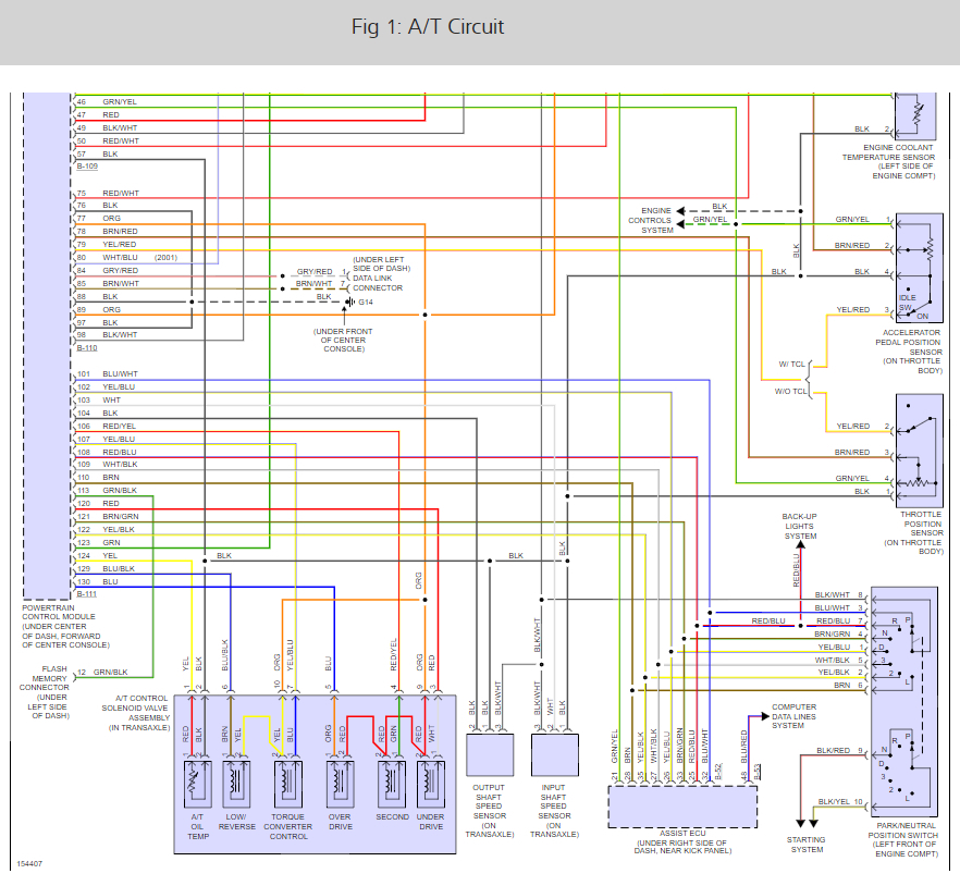

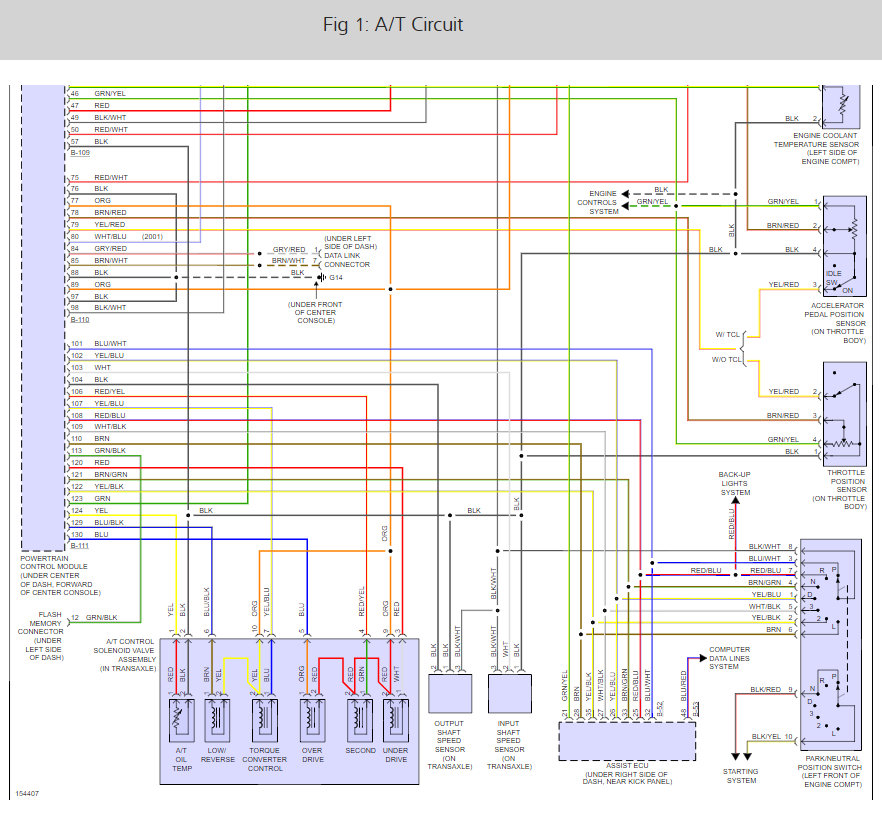

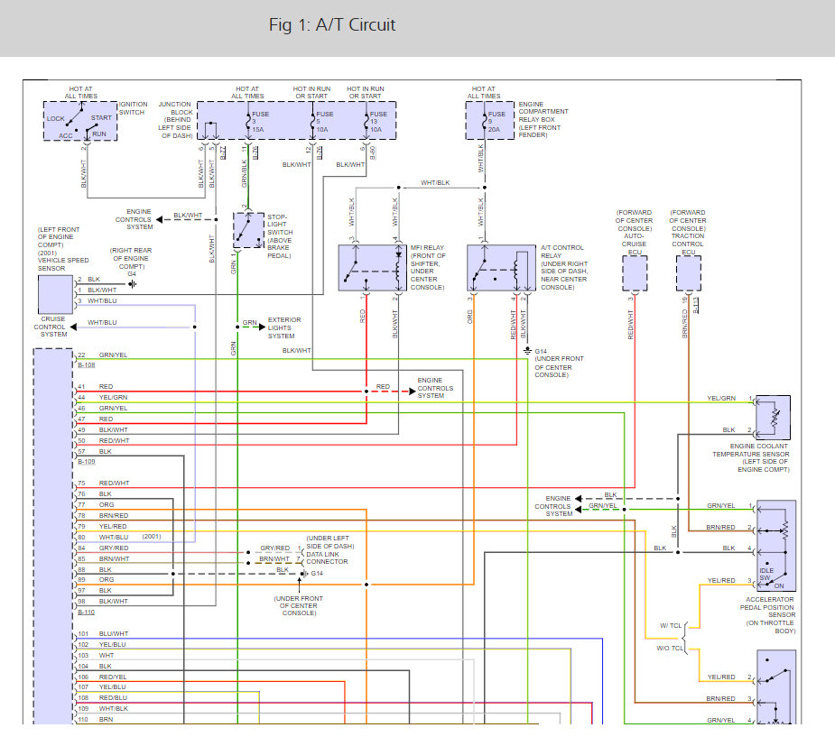

Throttle position sensor installed and good. Put it in gear and nothing. It mechanically shifts in to gear and the indicator light changes on the dash. The engine even changes speed indicating that the transmission speed sensors are working... But no dice. The fluid is full and a nice light red color and does not smell burnt. The best I can figure is the solenoids in the transmission are not engaging. Do you have a wiring diagram for the transmission components?
Feb 1, 2018 at 4:15 AM
  • 55,433 POSTS
Yep here are the transmission wiring diagrams (below)
