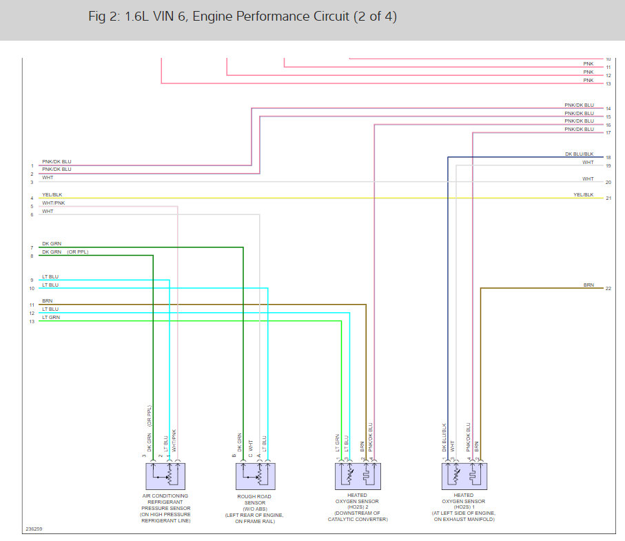

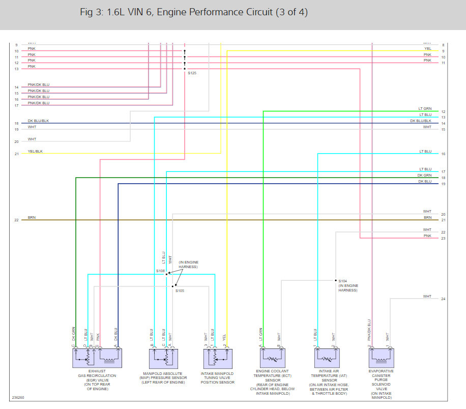

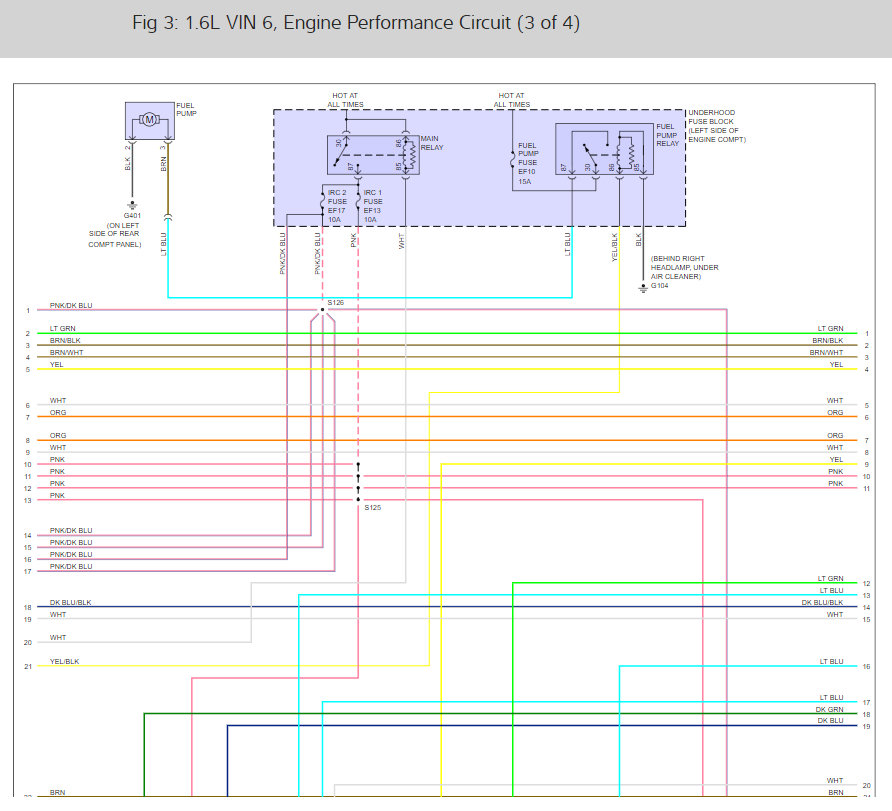

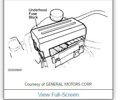

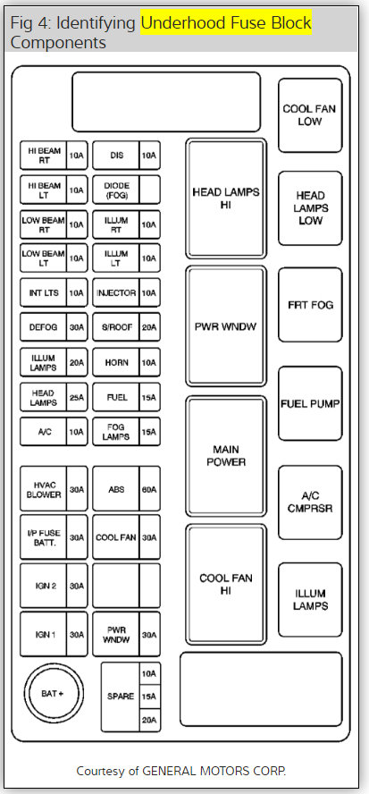

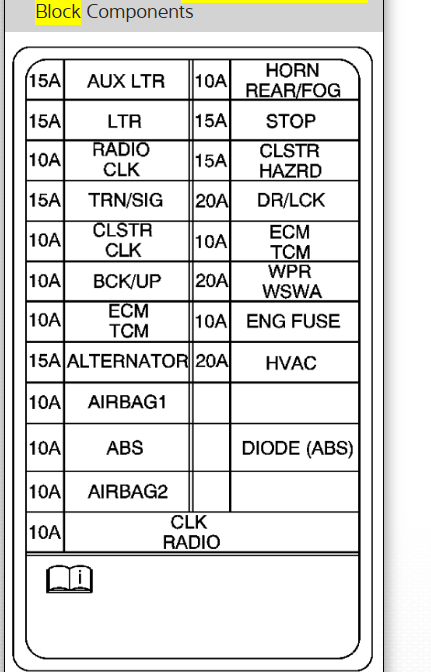

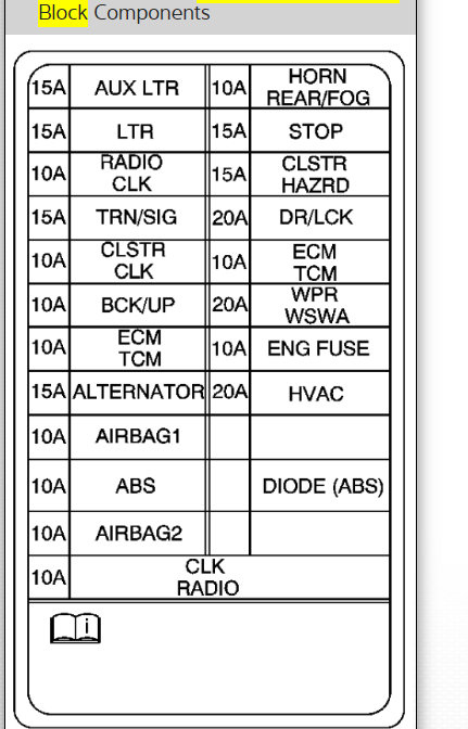

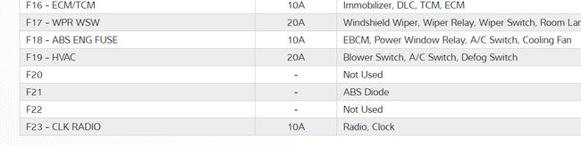

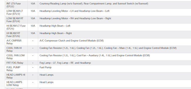

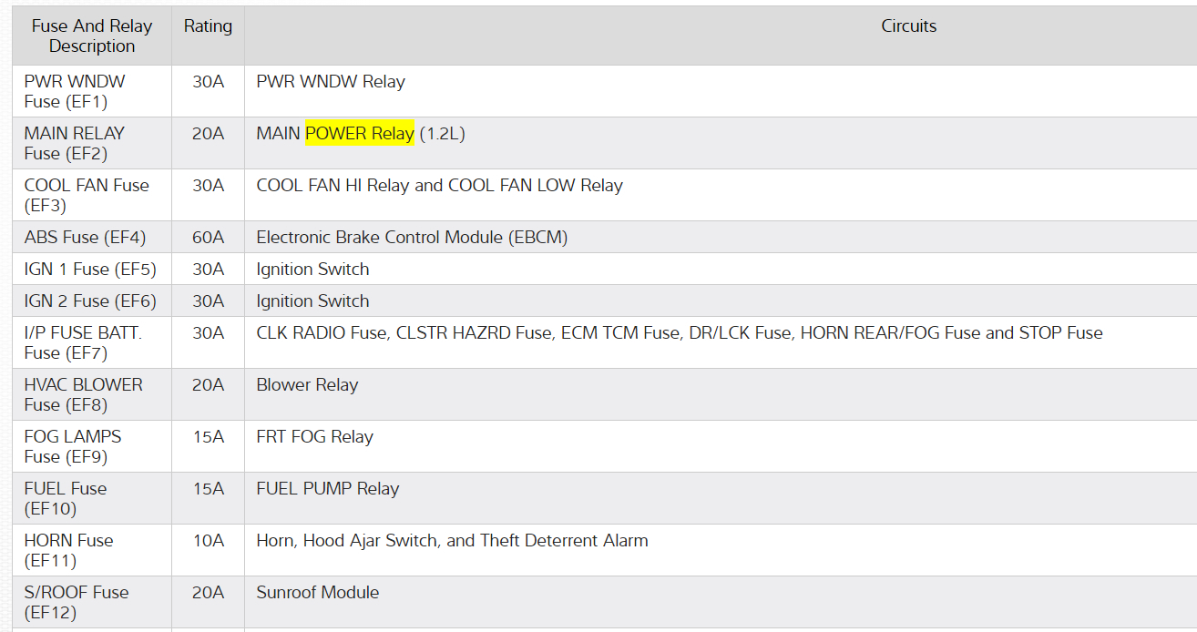

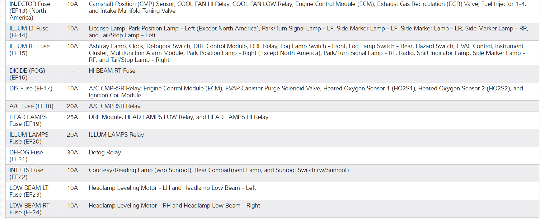

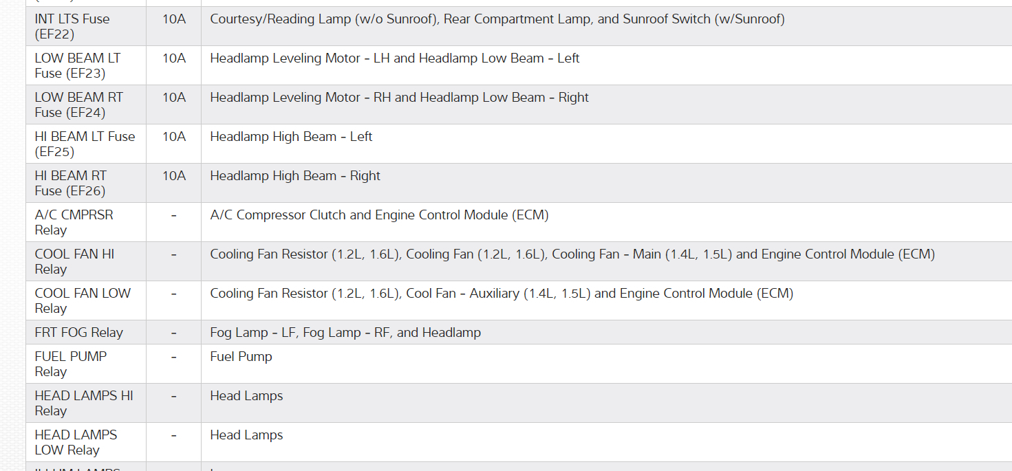

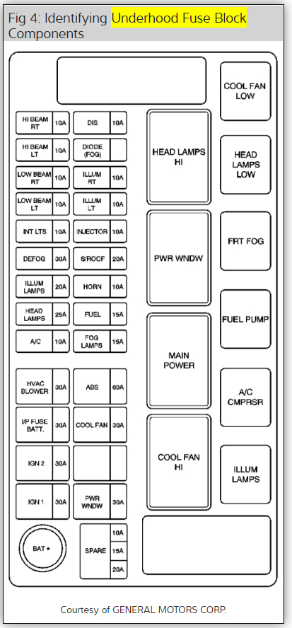

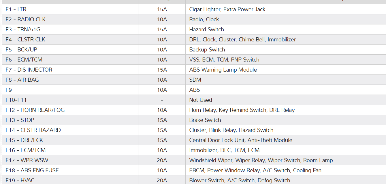

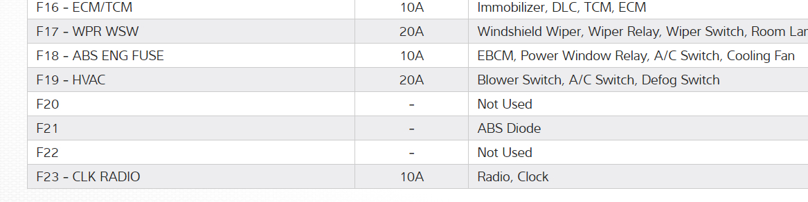

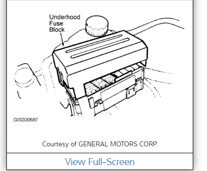

I would start by checking the fuses f16 f6 and f4 In the fuse panel. Here is a guide to help and the fuse locations:

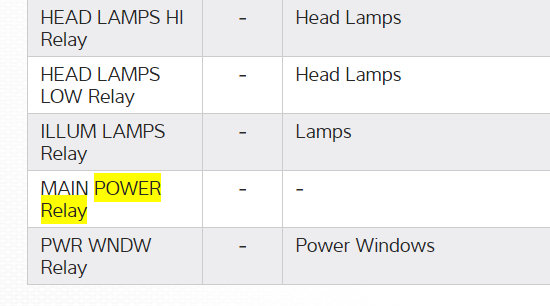

If the fuses are okay please check the main relay.
We should also run the codes to see what comes up.

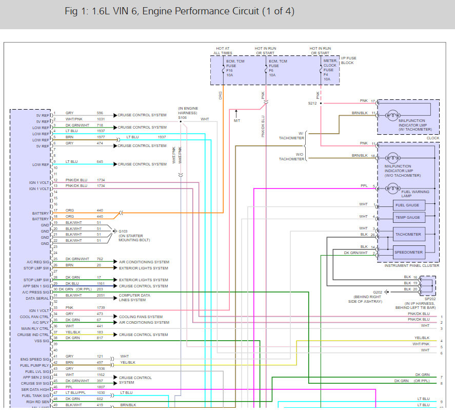

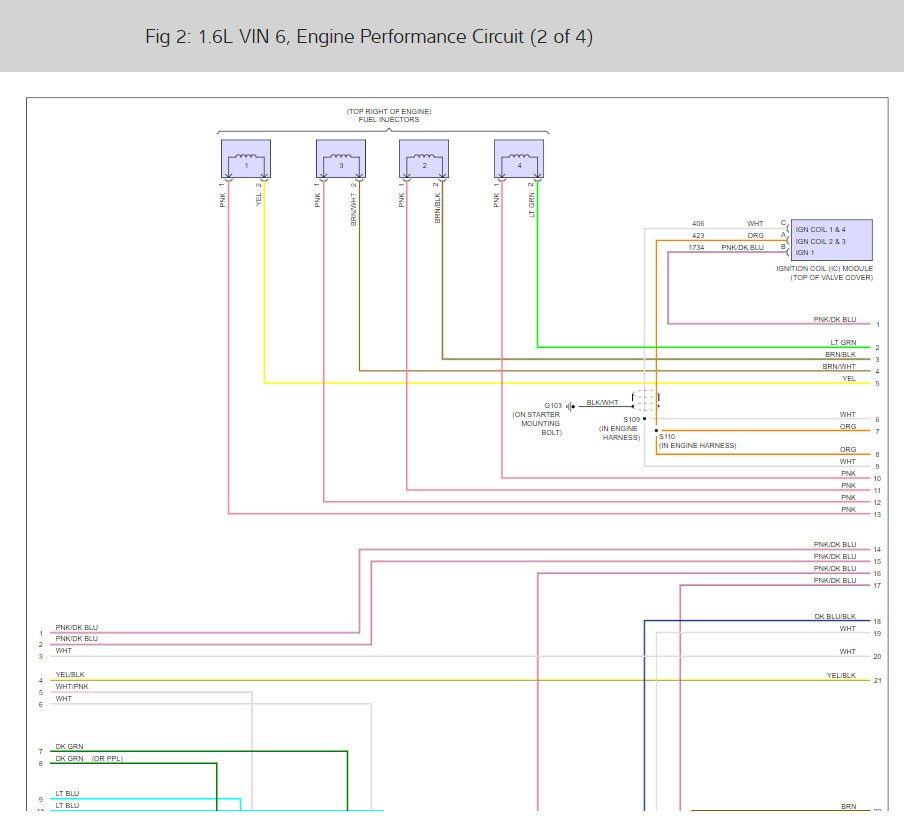

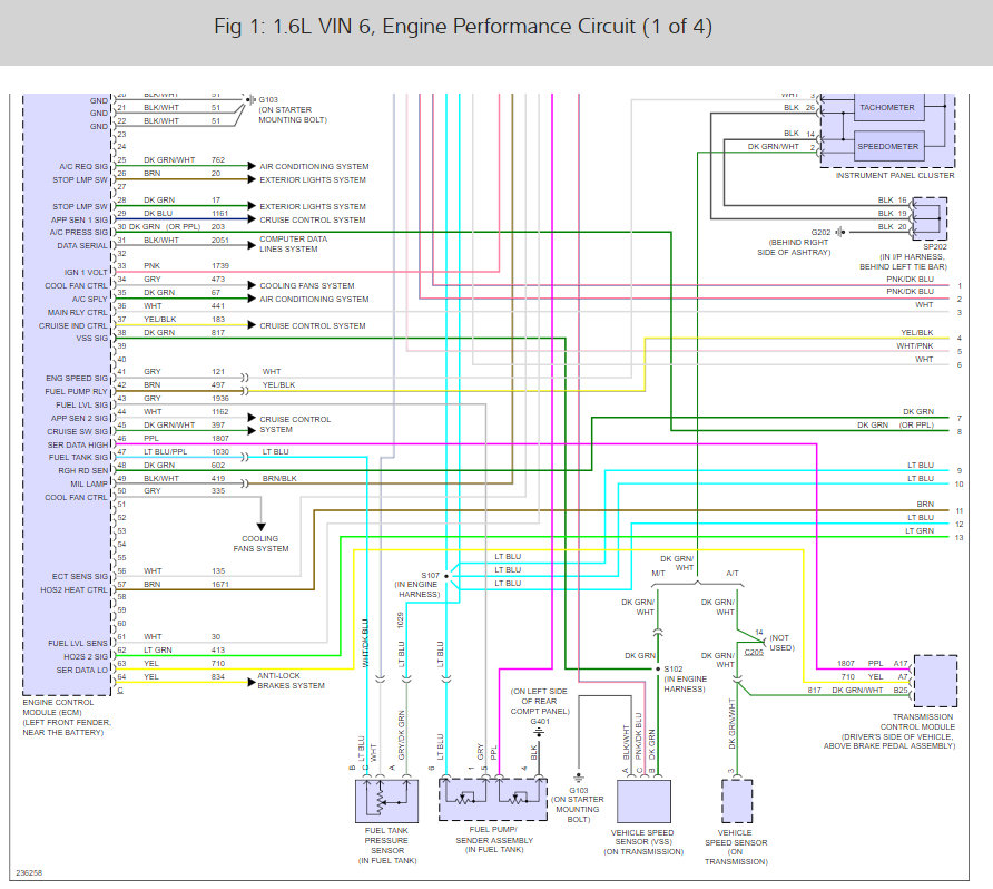

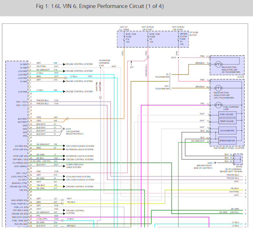

Here are the engine wiring diagrams so you can see how the system works.
Please run down these guides and diagrams and report back.

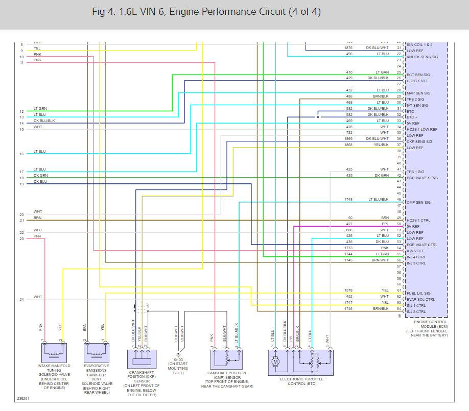

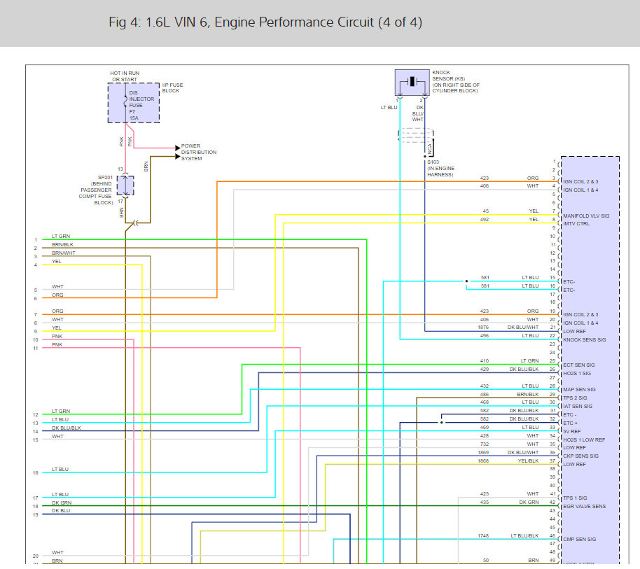

2006 Chevy Aveo LS 1.6L no spark. Has new coil pack.Turn over fine. No Codes. Timing Belt news. Crank and cam both turning. Has Fuel.
Aug 19, 2020 at 1:28 PM (Merged)
  • 55,604 POSTS

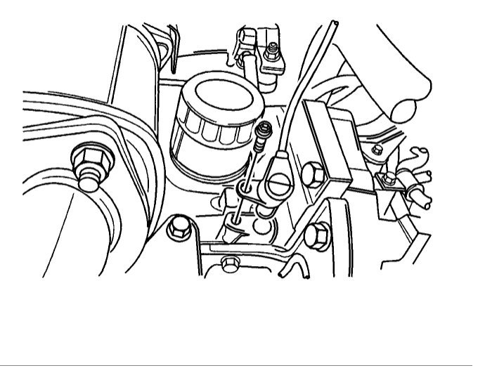

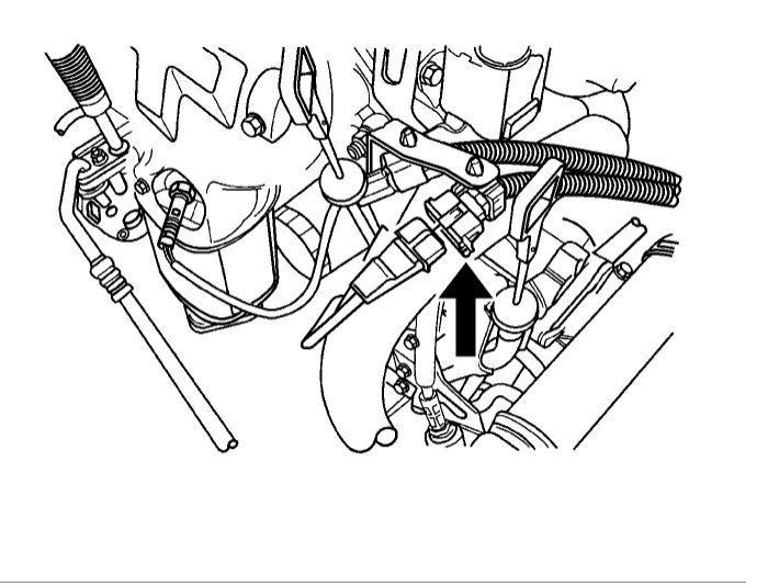

This sounds like the crankshaft angle sensor has gone out and need replacement, here is a guide and a diagram to help you get the job done.
Best, Ken
