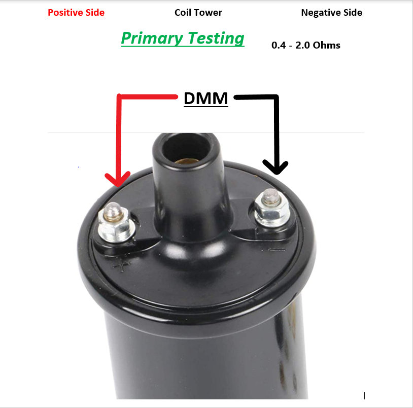

I'm getting 12 volts to coil when turning ignition to start, when I test leads without it hooked to coil i also get 12v but when i hook it up to coil it goes down to 1.5-2.3. also am i supposed to get 12 volts from positive terminal to both leads on coil.

Because of the model year, I have no schematics to work with. So, I have a few questions. First, I believe in 1973 you have a single coil and points and condenser in the distributor. Is that correct?
If you lose that much power with the coil connected, it could be due to an internal short in the distributor, or the wiring to it can have a faulty connection or is broken internally (under the insulation).
When you connect it and it drops, wiggle the wire supplying the power to see if the voltage is consistent or if it fluctuates.
If it doesn't change, we need to confirm there isn't an internal short in the coil. You will need a digital multi-meter (DMM). To check it:
1) Disconnect all wires to the coil.
2) Turn the DMM to ohms to identify resistance.
Primary Resistance Check
3) Primary Resistance check: Touch the red DMM terminal to the + side of the coil and the black terminal to the - side of the coil.
4) Expected Resistance: Many manufacturers indicate variations in the acceptable range, but in most cases, resistance will fall between 0.4 and 2.0 Ohms.

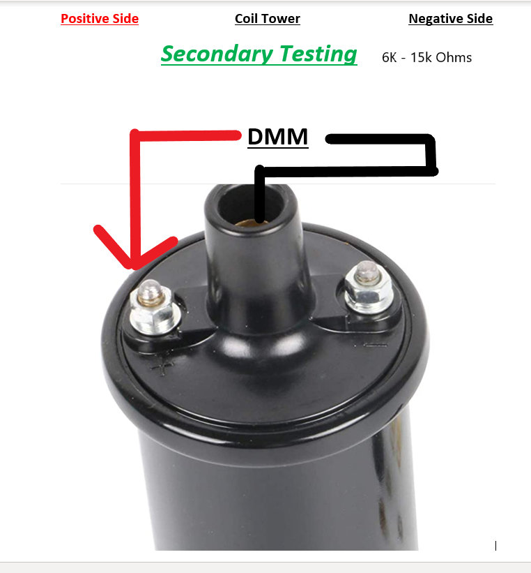

Secondary Resistance Check
5) With the coil still disconnected, place the DMM red terminal on the + side of the coil.
6) Place the DMM black terminal to where the coil wire would go (coil tower).
7) Expected Resistance: Many manufacturers indicate variations considered in the acceptable range. However, in most cases, resistance will fall between 6K and 15K Ohms.
I tried to draw a couple of pics below to help identify where the wiring goes from the DMM.
If the readings are far from what I indicated, I suspect the coil is shorted internally and needs to be replaced.

So took a minute dealing with some health stuff, ugh. but back at it. I measure resistance from red to black and fell to 0, measurement from top coil did read 10,000. Do you think coil is bad sir?
Jun 28, 2022 at 4:04 AM
  • 110,244 POSTS
Welcome back. If you are getting 0 Ohms between the positive and negative sides of the coil, it does sound bad. It should be between 0.4 and 2.0 Ohms.

Hi and Thanks. So, I tested the coil wrong. I had the meter on 20k testing between pos/neg instead of 200k. I have two and both tested fine. I did however check the plug wires and coil wire tip was broken inside distributor cap. I’m getting new wires today. Do you know the correct way to hook up Pertronix ignition? I’m going direct positive to red and black to neg and using red/black from ignition switch to positive coil. They say this connection should work and no other wires or connections are needed. Any idea?
