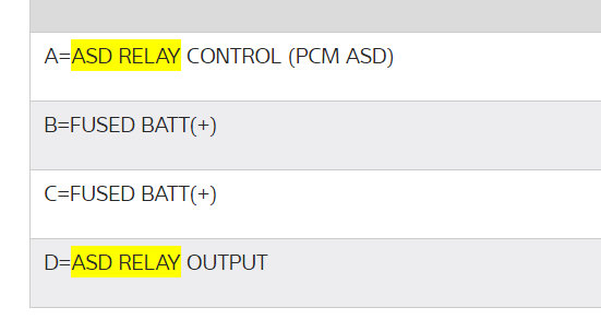

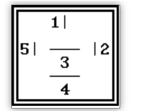

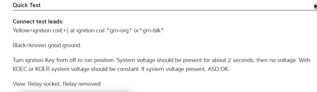

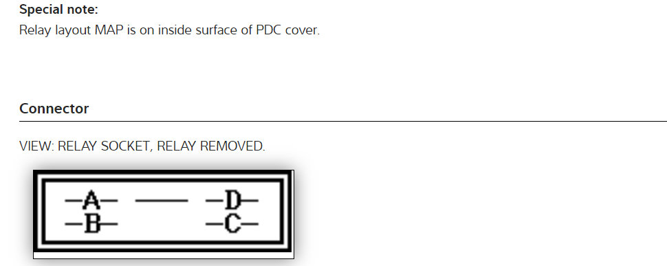

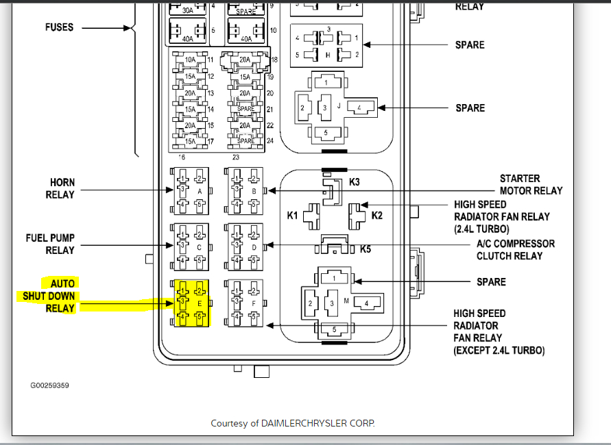

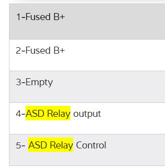

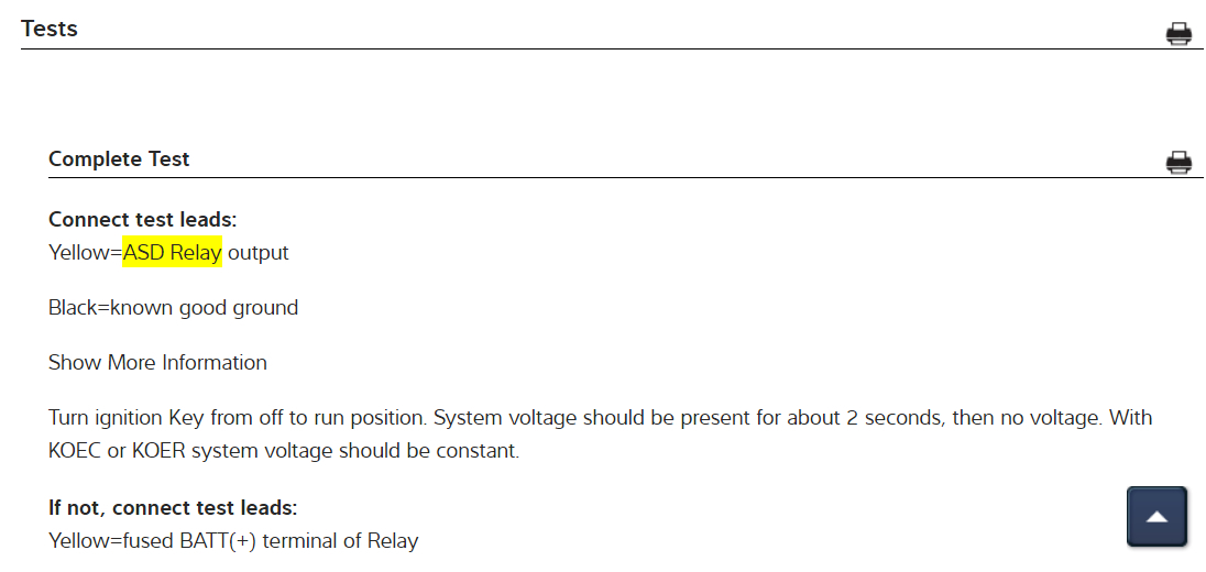

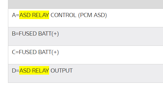

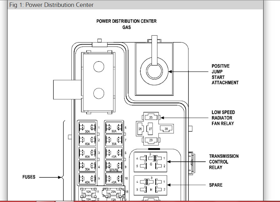

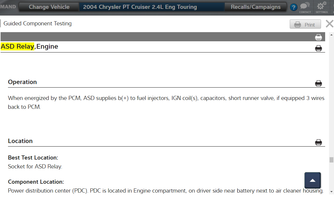

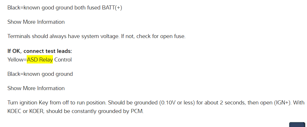

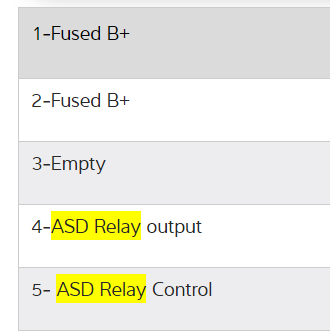

This could be a problem with your vehicle's Auto Shut Down Relay (ASD) which is located in your vehicle's Power Distribution Center next to the battery. In the diagrams down below I have included the location of the ASD relay, diagrams of it's location and a factory troubleshooting guide for how to test it. Please go through this guide and get back to us with what you are able to find out.

Okay, i checked ASD relay and it is good. checked wiring to the coil and there is not spark in the wire. will turn over until battery gets low but will not start. what to try next?
