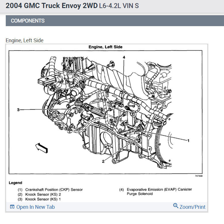

when i turn the key to crank the engine it wont start and sometimes when i turn the key the starter will keep turning for a few seconds. i checked for a spark when cranking there is no spark. what can cause no spark at the spark plugs boot?

It sounds like the crankshaft angle sensor is not working this guide can help us check it with the location of the sensor in the diagrams below.
Check out the diagrams (Below). Please let us know what you find. We are interested to see what it is.
