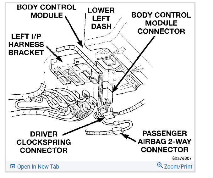

The anti theft system in my vehicle does not arm itself anymore after exiting and locking doors. The security light does not even blink. Information I have found will only be about how to disarm or bypass. In my case just the opposite. I called the dealer and all they said was it is a BCM issue.

I'm having a similar issue now. I originally had a bad power drain from the cd player, HVAC fan, and heated seats. I traced the fuse back to the body control module BCM. I cleaned and reseated the two connectors and it stopped the very inconvenient power drain, but now the anti theft will not alarm. I'm thinking about replacing the BCM. Did you find a solution yet for your wj?

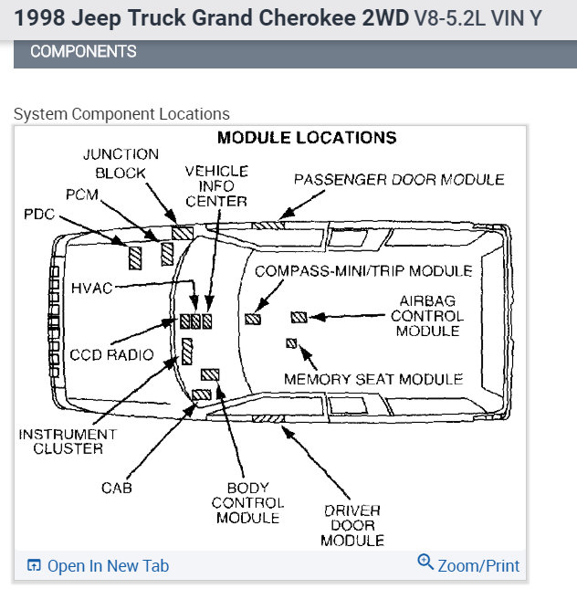

It does sounds like the BCM is going out. here is the location and you will need it programmed it should cost about $130.00 at a shop. Check out the diagrams (below). Please let us know what you find. We are interested to see what it is.
