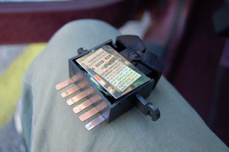

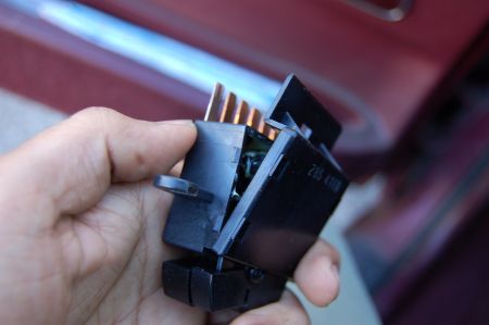

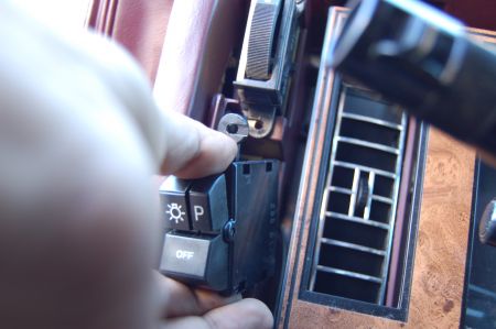

For anyone interested in the switch fix, here's how I did it.

Friday, May 21st, 2021 AT 3:29 PM (Merged)
JDL
  • 16,098 POSTS
Good pictures, that is interesting.

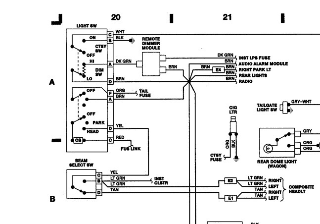

CLINT BLADES
  • 1989 BUICK CENTURY
My tail lights went out as well as my dash lights. The fuses and bulbs are all fine. The head lights, brake lights, and turn signals are working fine. Any idea what my problem could be? As far as I can see none of the wiring has been pinched. Someone suggested that maybe the headlight switch needs to be replaced. Any leads would help. Thank you for your time.
JDL
  • 16,098 POSTS
I'd check the connector at the headlamp switch. You could probably use a jumper on the proper terminals to get the dash and or tail lamps to come on. Did you check the applicable fuse/s for voltage?
+8
JDL
  • 16,098 POSTS
Here is some wiring. I agree with Ras.
+2

CLINT BLADES
I dont think I was getting a good connection when I was crossing the contacts. I tried it again and got the taillights to come on. It has to be the switch, which I am replacing tomorrow. Thank you so much for your time and advise!
+1
JDL
  • 16,098 POSTS
Just to sure you understand. There are two voltage circuits that go to the headlamp switch. One is a fused circuit for the tail lamps--dash and such. The other voltage circuit is only for the headlamps, comes from fusible link. Both circuits are hot, correct?
+2
CLINT BLADES
Yes both are hot. It seems that the switch is not connecting them. I'm going into town today to get a new switch.
+2
