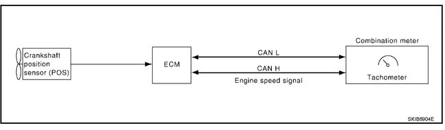

We drove 23 miles and stopped at our destination we put in park still running for a few minutes put in drive to pull off and van didn't want to move. acted as if it where in neutral. turned engine off and restarted pulled to stop sign same thing happened. turned off air conditioning, radio and restarted engine drove fine 23 miles home with nothing on. after returning home left off for a couple hours and tried to start the engine battery/brake caution lights came on and it made a loud rattling noise the service engine light did not come on. we have recently put a new alternator, battery, new camshaft sensor and new power steering pump. what could cause this?

It will rev up but not move like it is in neutral. and now it will start but it makes a loud noise and the brake/battery like shows on the dash. I haven’t tried to move it again.

The rpm gauge does not move, but the motor revs.

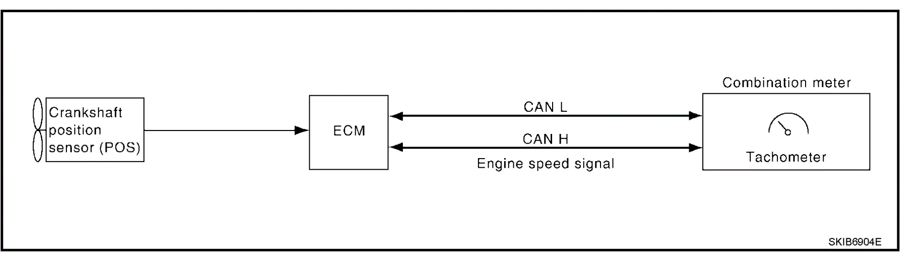

The engine revs but the tachometer doesn't increase. That leads me to think there is a faulty crankshaft position sensor or a wiring issue related the engine control module. I'm not sure how that directly correlates with the transmission issue other than it is related to ECM.
If you look at the pic I attached, it shows that the crankshaft position sensor signals the ECM, which then signals the tachometer. It's done via CAN, which stands for computer area network. Since the CAN system is involved, you really should scan the can system Here is a video that explains it:
