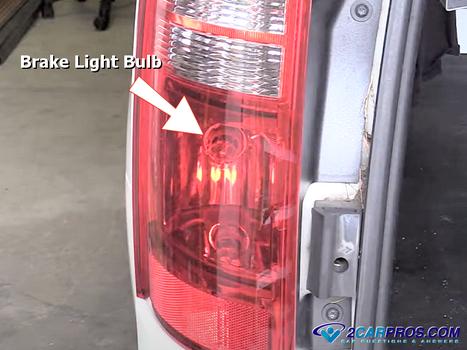

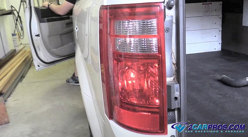

1. Locate the brake light bulb that is not working by having a helper press on the brake pedal while you watch. In the image below the driver's side bulb is out and needs to be replaced, which we will do in the following guide and video below.
brake light bulb

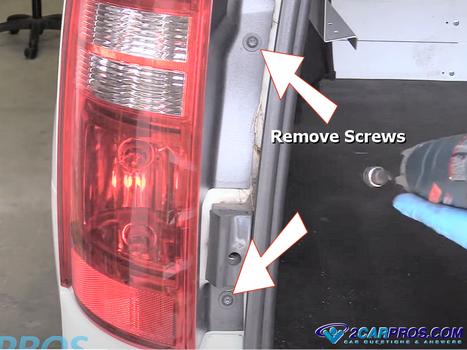

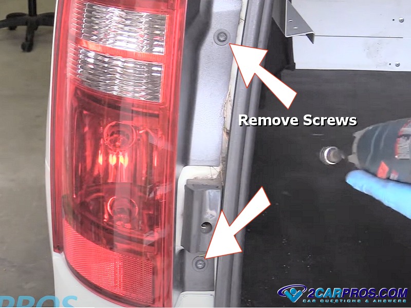

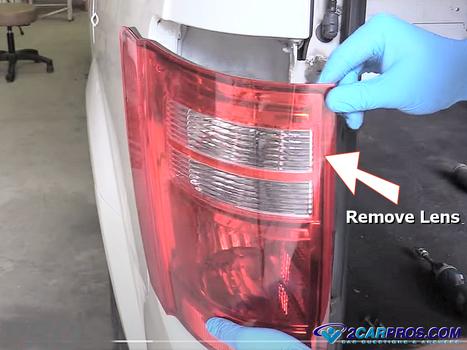

2. There are two types of brake light bulb service arrangements, either you can gain access to the bulb from the rear of the lens, or you will need to remove the lens to be able to service all of bulbs, such as the reverse, brake and running light bulbs. To start, remove the lens mounting screws after opening the lift gate, tailgate, hatch, or trunk lid.
remove brake light lens screws
3. Grasp the lens firmly and pop the clips loose on the opposite side of the screw mounts, these clips are usually mounted in plastic or rubber.

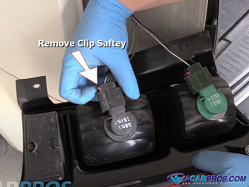

4. Once the lens is loose from the car you can access the bulb sockets, which will have an electrical connector attached. This connector may have a safety clip that will need to be removed or released as in the example below, then just unplug the connector from the bulb socket.
remove eletrcial connector safety

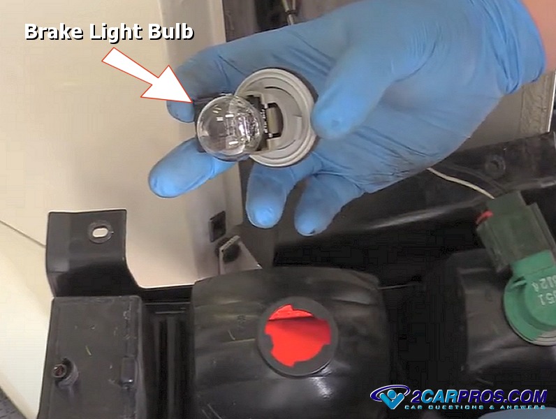

6. The brake light bulb and socket are now loose from the lens and ready to be replaced.
brake light bulb removed

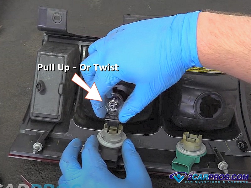

7. There are two types of bulbs, one will need to push down and twist counterclockwise, the other is featured here in the image below. While holding the bulb socket firmly, use your opposite hand to pull up on the bulb to remove it. Match the new bulb to the old bulb to ensure a proper installation and then reinstall, you will hear an audible click when the bulb is fully seated. When the bulb is removed, clean the socket with a shop towel and inspect the contacts. Use dielectric grease before the new bulb is installed to help prevent corrosion.
remove brake light bulb

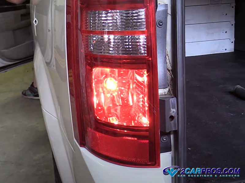

8. Reassemble the bulb socket back into place and reattach the wiring connector, then remount the tail light lens and reinstall the mounting screws and you are all set. Again, have a helper step on the brake light pedal to make sure the new bulb is working correctly.
