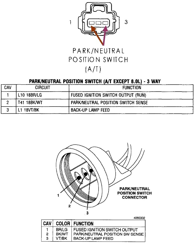

I'm a bit stuck trying to get reverse lights to come one. I have changed both bulbs, fuse also changed and replaced neutral safety switch on the transmission (rebuilt under 3,000 miles).
Checked. well traced the wires under the bed and didn't find any cracks or disconnections all the way to the bulbs.
Now the previous owner put in a 30 where 20 fuse should go in the fuse box in the engine bay. So, I placed the correct fuse.
I'm very new to trouble shooting electronics so bare with my novice questions. Will be getting a voltmeter from a friend this weekend.
The truck listed above is a 1500.

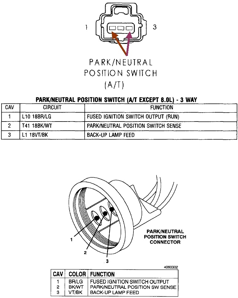

For the benefit of others researching this problem, please allow me to start with the normal order of diagnostic steps, even though you replaced parts already. The most common cause of no back-up lights is the neutral safety switch. A real fast way to verify that is to turn the ignition switch to "run", then crawl underneath, unplug the neutral safety switch, then jump the two outer terminals in the connector with a stretched-out cotter pin or paper clip. If it's relatively dark down there, watch closely for a tiny spark when you do that. If you see that, it proves current is flowing, then you know at least one of the back-up lights is working. Of course, you can look at the lights to see if they're on. If they are, you know the fuse and every other part of the circuit has to be working, and the switch must be replaced.

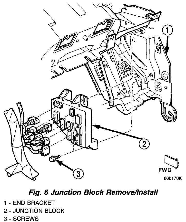

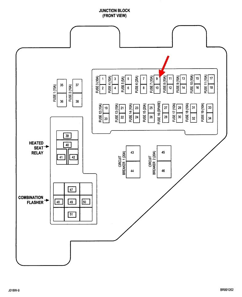

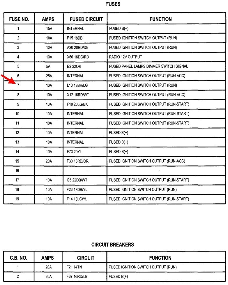

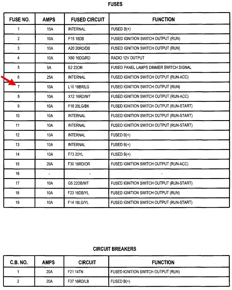

Most people would start by checking fuse # 7 in the Junction Block, but that circuit and fuse actually feeds a number of other circuits not shown in these drawings. If the fuse was blown, you'd have other symptoms. It's designed that way because you would never know if the back-up lights weren't working, but you will notice other things are dead when that fuse is blown.
If jumping the two terminals in the neutral safety switch connector did not turn the back-up lights on, check for 12 volts on both of those terminals. There should only be 12 volts on terminal # 1 corresponding to the brown / light green wire, but rather than trying to figure out which one is the 12-volt feed wire, it's faster to just check them both. If that 12 volts is missing, we have to look between the fuse box and that terminal for a break in the wire. If you do have 12 volts, the break is after terminal # 3, the violet / black wire. There is a splice, S316 in that circuit. Those are always good places to find corrosion, although usually one back-up light would still work.
Very often in this type of circuit, a digital voltmeter can give misleading readings. That won't happen if all of the readings are taken while everything is plugged like normal, but then you'd have to take readings at the neutral safety switch by cutting the wires' insulation. That is never acceptable. Instead, you are more likely to get valid readings by using a test light instead. It has to be the older, inexpensive type with an incandescent light bulb inside, not one of the newer ones with LEDs. Here's links to articles that show how to use both of them:
The article shows them using an auto-ranging meter. That's an expensive option that most meters don't have. If you need help setting up a regular voltmeter, I can help with that. Harbor Freight Tools has a perfectly fine voltmeter for around $8.00, and a test light for $4.00. You can find both at Walmart or any hardware store or auto parts store too.
Let me know what you find up to this point, then we'll figure out where to go next.
