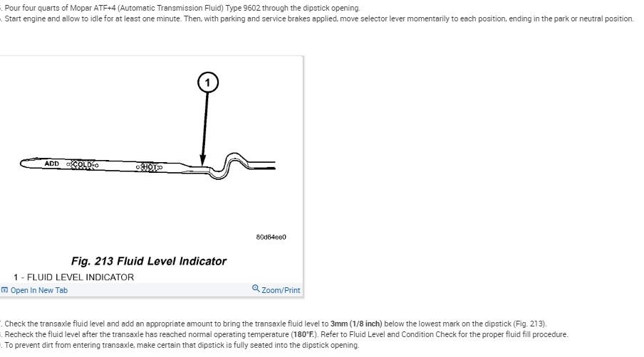

I purchased the van used and I've been driving it now for about a year was curious to know why or what would possibly be causing not to get engaged in reverse? And recently is starting to feel as if it's surging or shuttering as I'm driving. More so kind of high mileage or higher miles per hour. Can you please give me some feedback? I would appreciate that. Thank you.
Feb 9, 2020 at 9:19 AM
94 TRANSAM
  • 680 POSTS
Reverse is the first to go when you have low pressure issues as reverse requires the highest pressure.
This could be caused by low fluid, a plugged filter, a bad pump, blown seal, bad solenoid or the least common a worn out clutch pack.
As for the other issue, that sounds like you have clutches slipping which could again be low fluid, or a plugged filter or worn out clutches. Given the mileage you likely need to rebuild the transmission. You have all the symptoms of it being at the end of its life span.
If it is slipping and not at the end of its life and the slipping is a result of another issue you will burn out the clutches if you continue to drive it.
I would recommend taking it to a transmission shop and have it diagnosed.

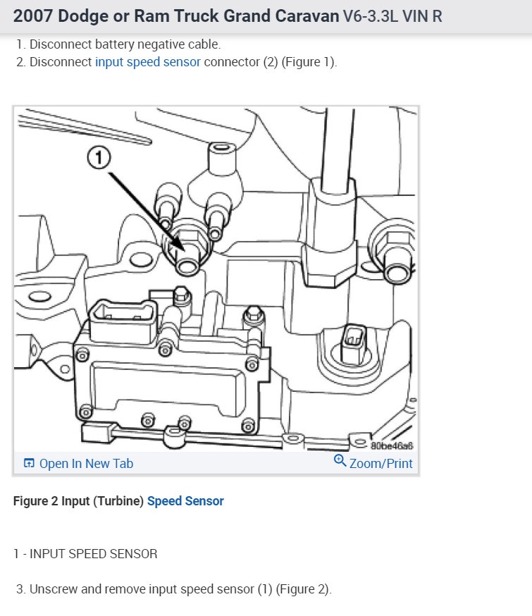

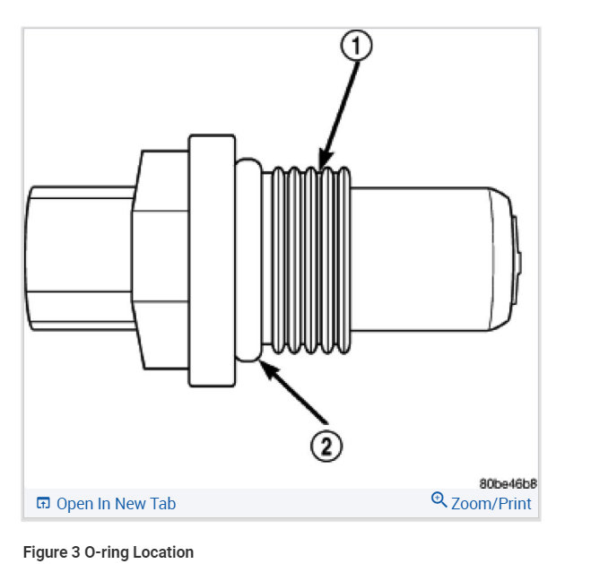

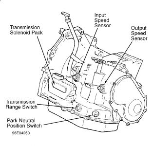

I have seen the input shaft speed sensor cause this issue and sometimes cause a code. here is a guide to help you retrieve the codes and the sensor location so you can check it out:

https://images.2carpros.com/forum/automotive_pictures/99387_Graphic9_51.jpg
have to check for TCM codes most common speed sensors and or tranny solenoid packs

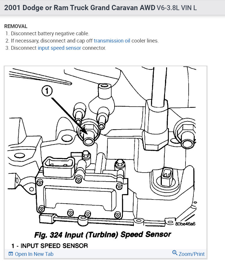

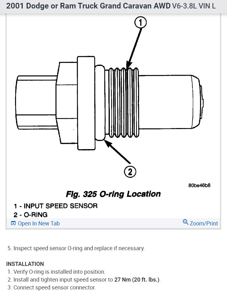

I have seen the input shaft speed sensor cause this issue here is the location so you can check it out. Check out the diagrams (Below). Please let us know what you find.

1st step I would take would be replacing speed sensors you have two input and output
https://images.2carpros.com/forum/automotive_pictures/99387_Graphic9_56.jpg

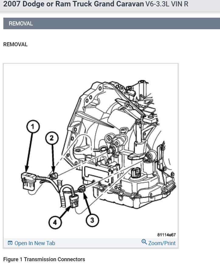

here are the sensor locations
https://images.2carpros.com/forum/automotive_pictures/99387_Graphic1_150.jpg

BMRFIXIT
  • 19,053 POSTS
https://images.2carpros.com/forum/automotive_pictures/99387_Graphic_92.jpg
You have two speed sensors input and output unscrew old one and screw new one in
