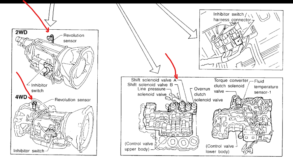

So, I accidentally hit the gear shift into the 1st gear position going 70 MPPH quickly put it back, didn't notice much until I stopped it would go in reverse or first gears. I put it drive and it goes but feels like it's actually in second. My question is, will I have to replace my transmission or what? It's still drives and the 4x4 still engages and seems to work it also drives great with cruise control, but cc doesn't always work. please help.

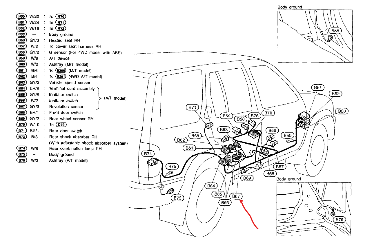

You could have knocked out the first gear shift solenoid or the revolution sensor. we should run the codes to see what comes up. here is a guide to help:
Here is the location of the shift solenoid and the revolution sensor in case you need it. Check out the images (below). Let us know what happens and please upload pictures or videos of the problem.
