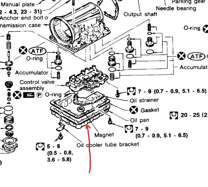

no reverse or 1st gears makes winding sound. although it still drives.

The winding sound could be a clogged fluid filter which will cause the transmission not to work correctly.
Here is a generic guide on how to do the service with a video to show you how on your vehicle:
This is done on a similar truck, but the process is the same. I have instructions below for your truck.
https://youtu.be/FglBsUEOSEk
Fluid Types
Automatic Transmission Fluid Type
USA & Alaska .................... Nissan Matic "D" Fluid
Canada .................... Nissan ATF or DEXRON III / MERCON
Capacities
Fluid capacity
With torque converter .................... 8.3 liters (8.75 US qt)
Also, we should run the codes as well.
