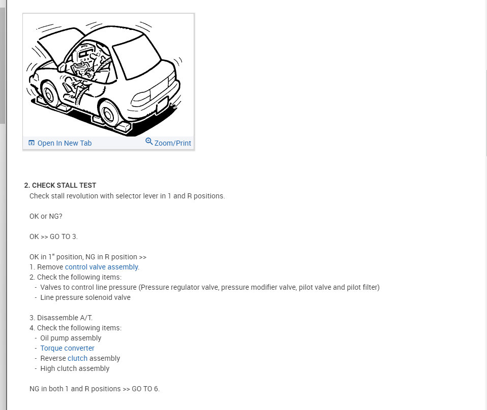

Just all of a sudden transmission does not go into reverse. All forward gears work fine. No noise from transmission at all. Could it be the LPS switch?
Dec 21, 2021 at 2:39 AM

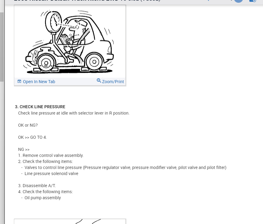

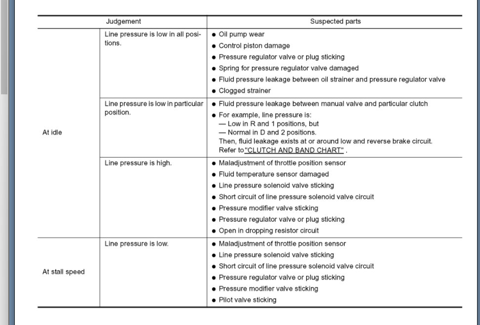

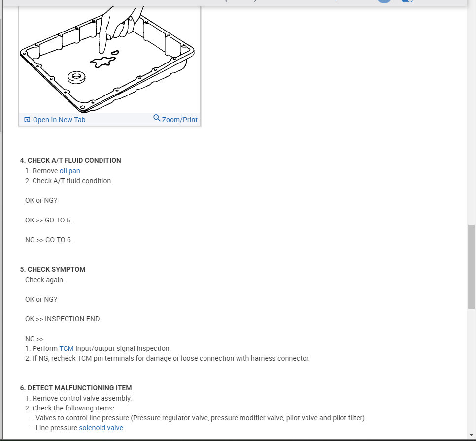

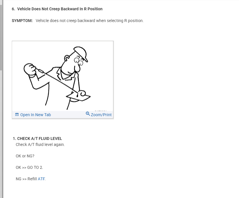

The pressure switch could be the issue, but the most likely issue is the fluid, so we need to start there.
Let's check the fluid and find out if that is full and in good condition.
https://www.2carpros.com/articles/how-to-check-and-add-transmission-fluid

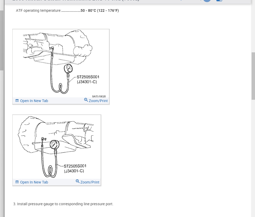

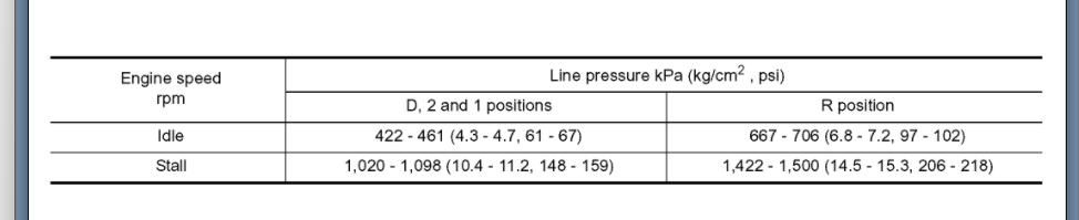

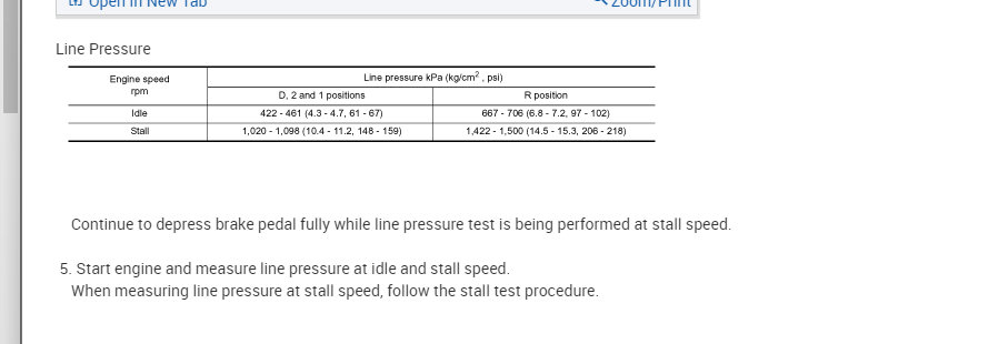

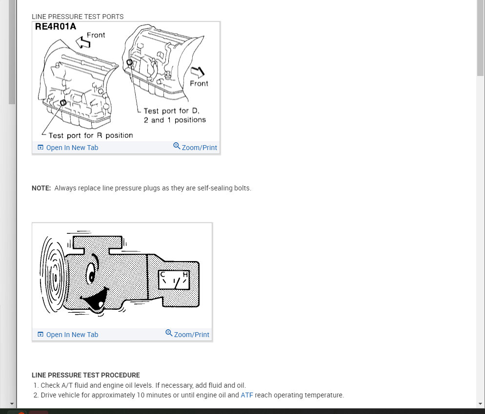

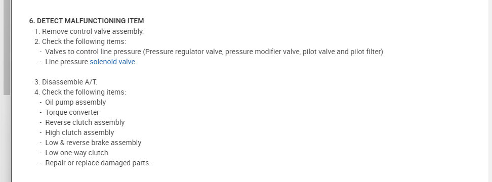

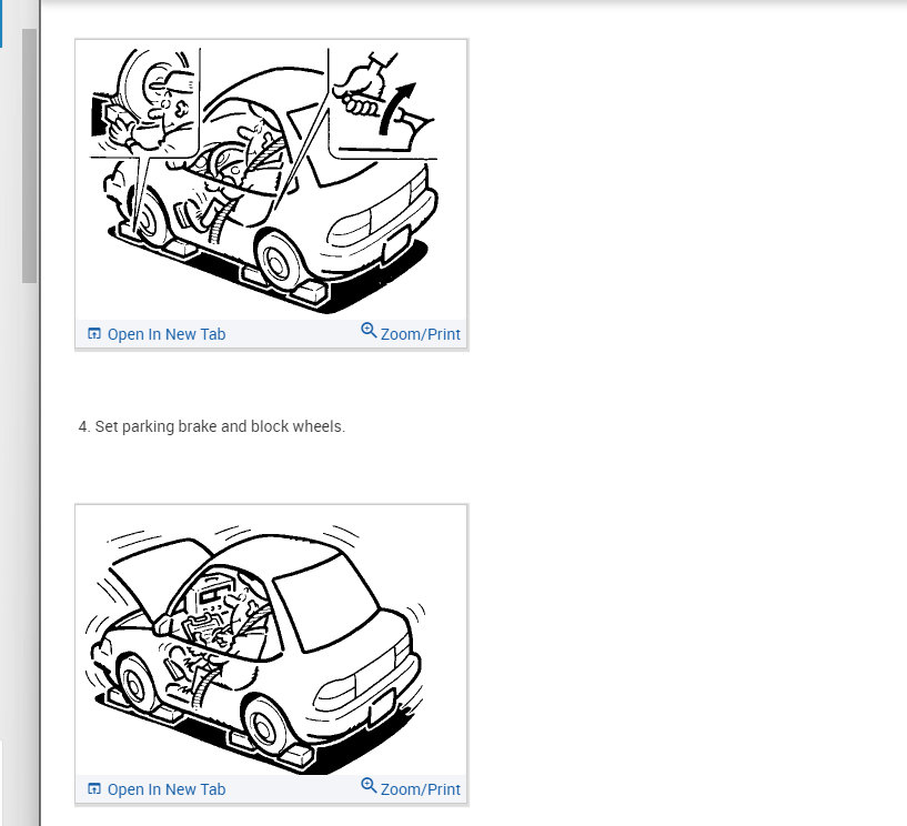

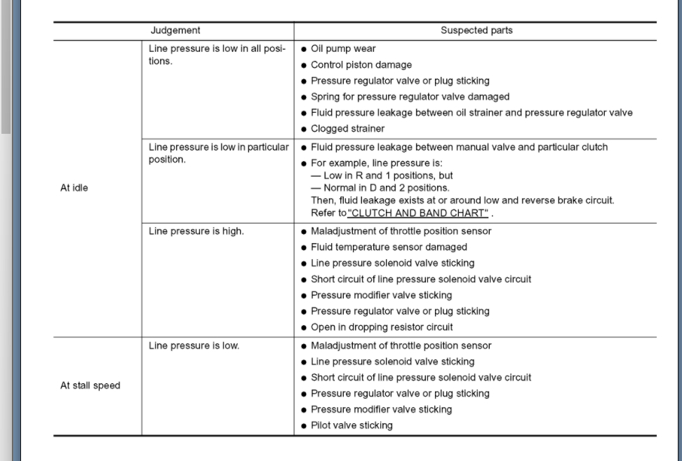

If it is, then we need to move onto check the line pressure to find out what the next steps are.
You can try and replace the switch but at this point that would be a guess so I would suggest running through this material and let us know what you find.
Please let me know if you have questions and we can go from there.
Thanks
