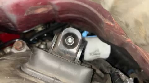

Are you able to see the slave working? If you haven't checked, have a helper operate the clutch pedal while you watch to see if it is moving the release lever.
See attached pic.

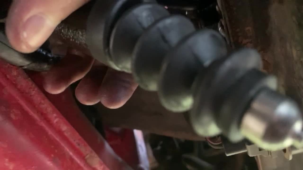

This is me trying to pump the slave by hand. is it suppose to come out that slow?
Sep 20, 2020 at 3:11 PM
  • 110,194 POSTS
Ty,
No, it should come out quickly and smoothly each time the pedal is depressed. Either you have a bad master cylinder, slave, or there is air in the system

I have bled and bled and even bled some more out the master. I get a squirt type deal out the slave it’s more of a stream but it doesn’t come out as fast as the master stream does.

V
Sep 22, 2020 at 6:08 PM
TY KEITH
  • 24 POSTS
If that fork is vibrating like that would that mean something is wrong with it ?
Sep 22, 2020 at 6:22 PM
  • 110,194 POSTS
I wonder if the external balance weight would have prevented that from happening. Keith, the slave looks like it's working properly and not slowly like the other video.

I just replaced the slave and have the same problem lol . I can drop the transmission and post pics of that might help ? At this point it’s looking like I’m going to have to anyways.

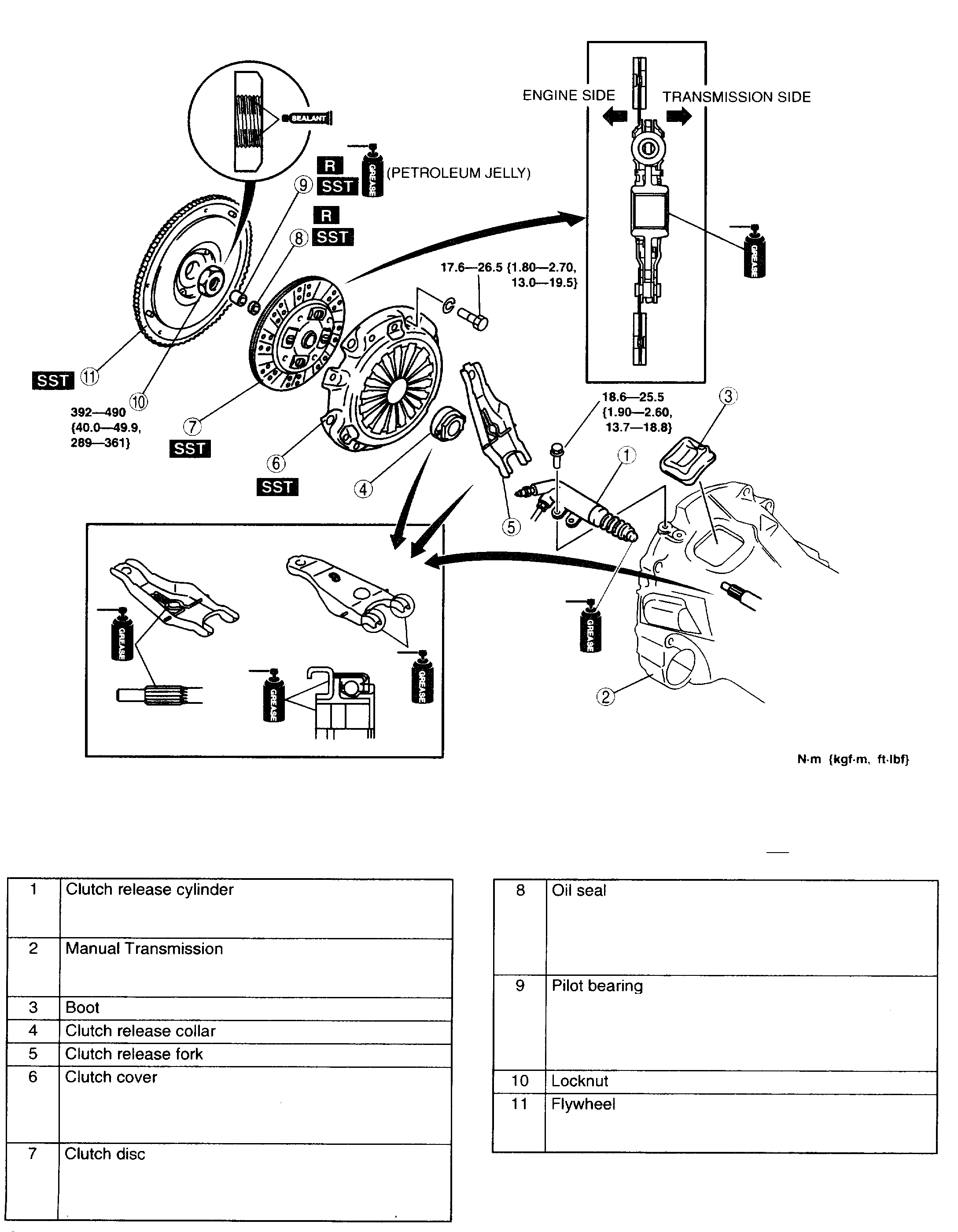

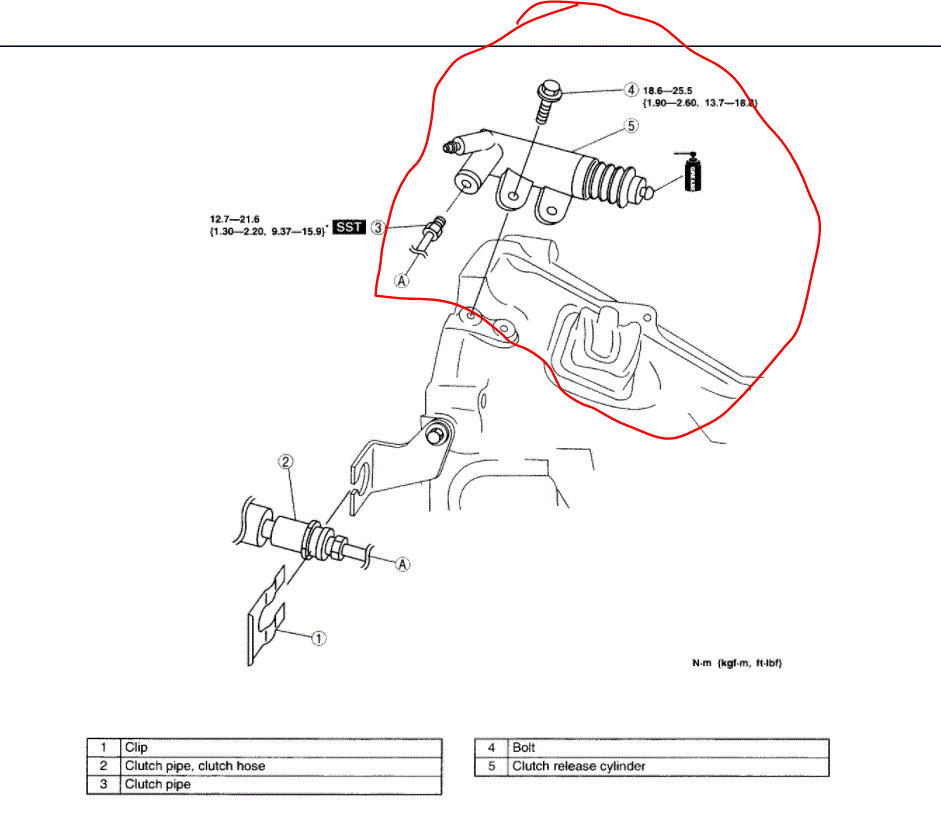

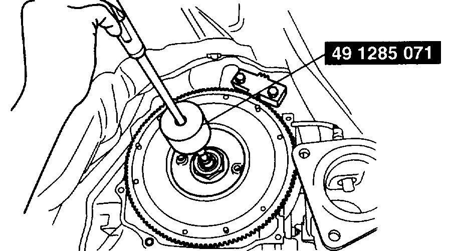

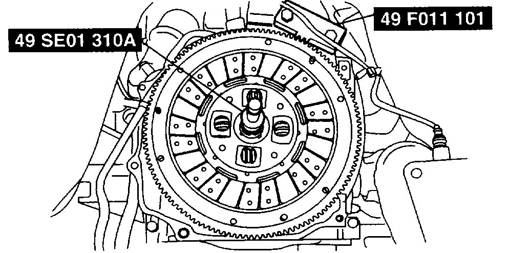

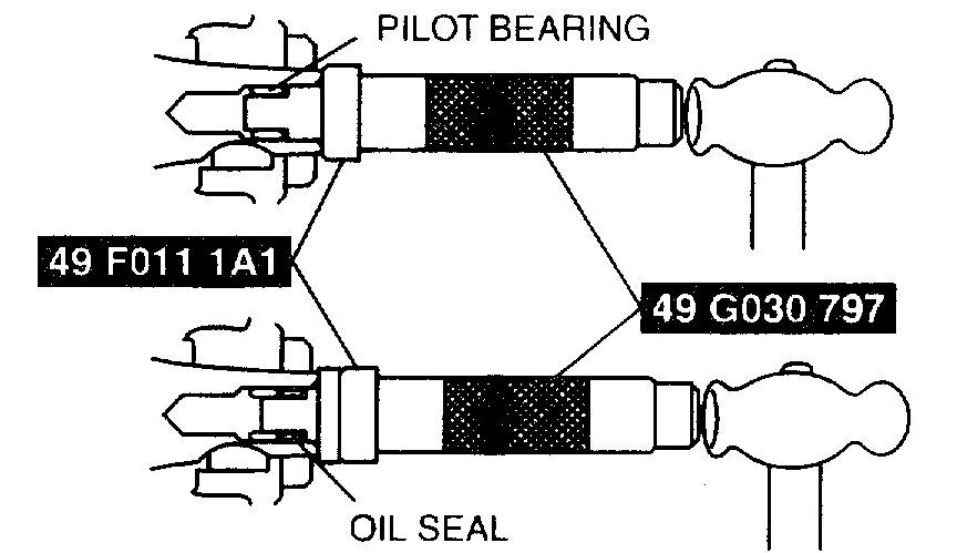

I don't know if you need them, but here are the directions for removal and replacement. the attached pics correlate with the directions.
____________________________________________
2004 Mazda RX8 2RTR-1.3L
Clutch Unit Removal & Installation
Vehicle Transmission and Drivetrain Clutch Service and Repair Procedures Clutch Unit Removal & Installation
CLUTCH UNIT REMOVAL & INSTALLATION
CLUTCH UNIT REMOVAL/INSTALLATION
pic 1
1. Remove in the order indicated in the table.
2. Install in the reverse order of removal.

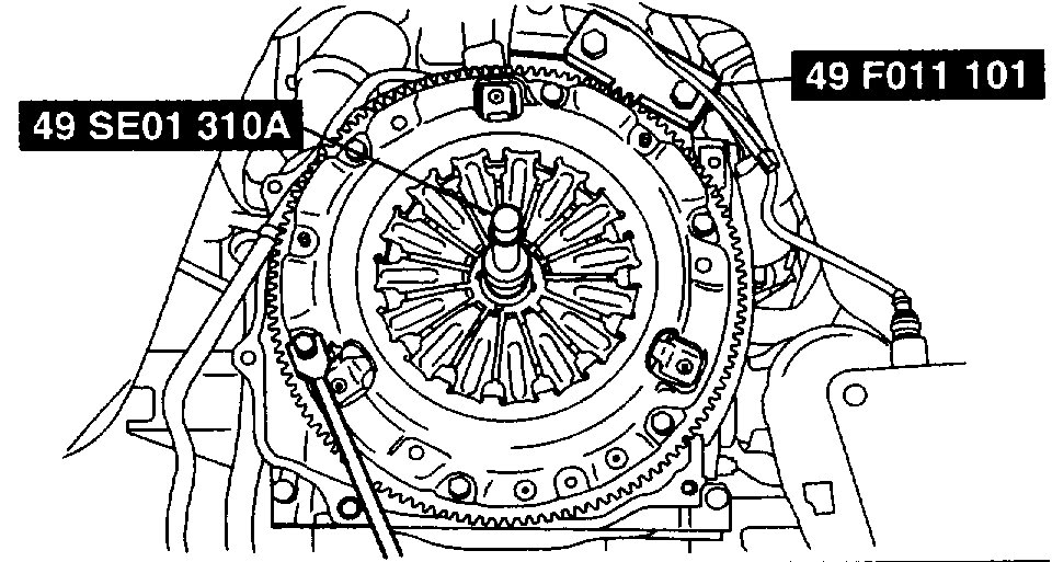

Clutch Cover, Clutch Disc Removal Note
pic 2
1. Install the SSTs.
2. In cries-cross pattern, loosen the bolts one rotation at a time until there is no remaining spring pressure.
3. Remove the clutch cover and the clutch disc.
Oil Seal, Pilot Bearing Removal Note
Note:
^ Remove the pilot bearing only if there is a malfunction.
pic 3
1. Remove the pilot bearing and the oil seal together using the SST.

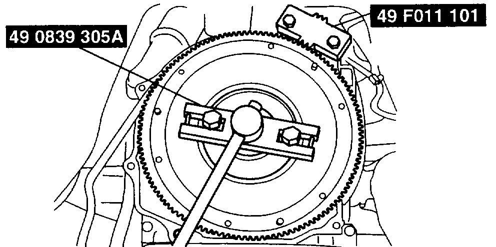

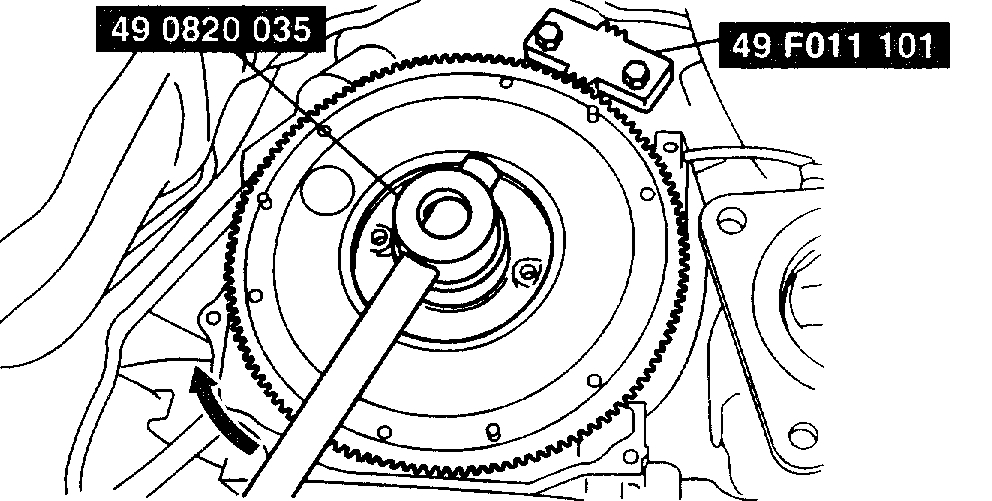

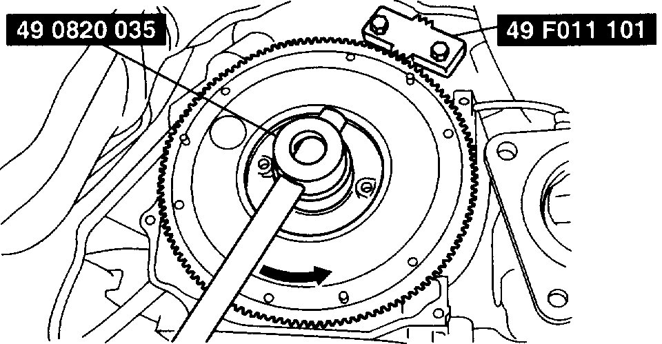

Flywheel Removal Note
pic 4
1. Install the SST to the flywheel.
2. Remove the locknut using the SST.
Note:
^ Inspect the eccentric shaft for oil leakage after removing the flywheel. If necessary, replace the oil seal.
pic 5
3. Remove the flywheel using the SST.
4. Remove the key from the eccentric shaft.

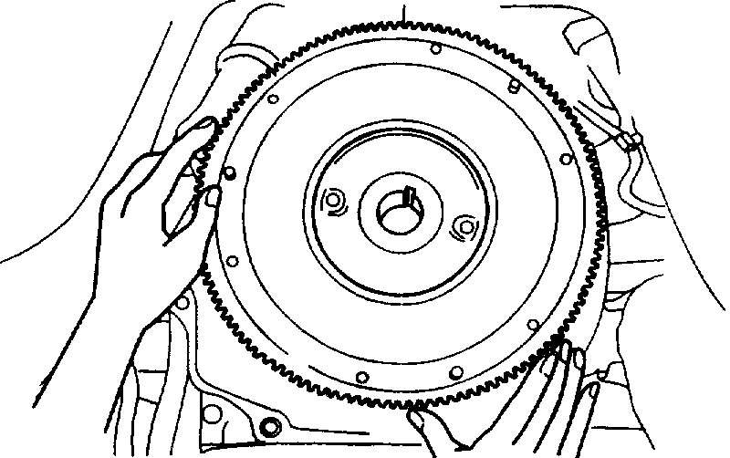

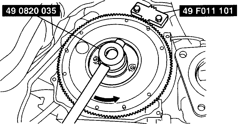

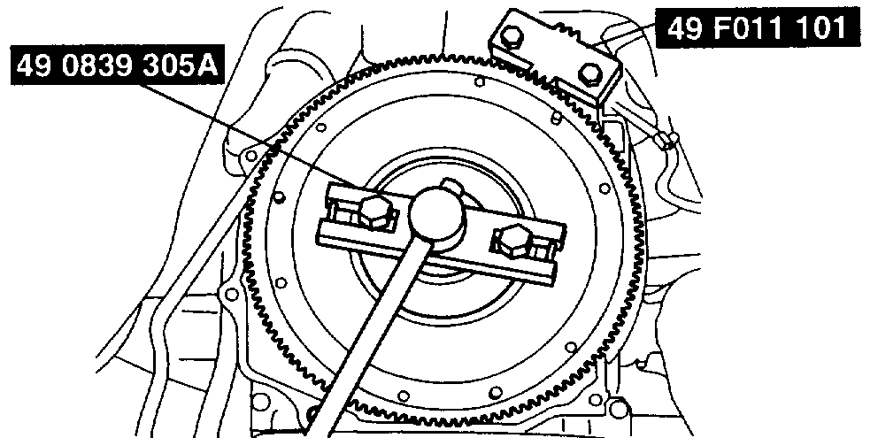

Flywheel Installation Note
pic 6
1. Install the key to the eccentric shaft.
2. Align the flywheel key groove with the eccentric shaft key and install.
3. Install the SST to the flywheel.
pic 7

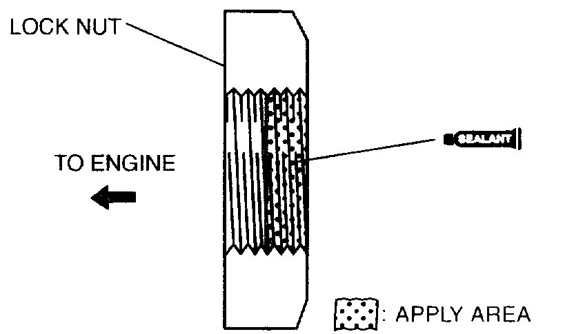

4. Apply silicone sealant to the locknut thread.
pic 8
5. Tighten the locknut using the SST.
Tightening torque 392 - 490 Nm (40.0 - 49.9 kgf-cm, 289 - 361 ft. lbs.)
Caution:
^ Remove the seal protruding from the threads without it becoming caught in the pilot bearing.

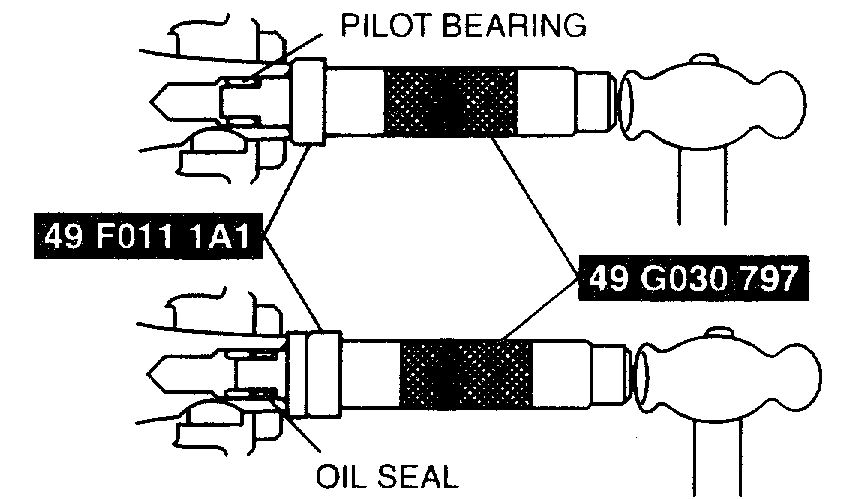

Pilot Bearing, Oil Seal Installation Note
pic 9
1. Install the pilot bearing using the SSTs.
Note:
^ Bearing outer diameter: 20 mm (0.787 inch)
^ Press-in depth: 11.5 - 12.25 mm (0.453 - 0.482 inch)
2. Install a new oil seal using the SSTs.

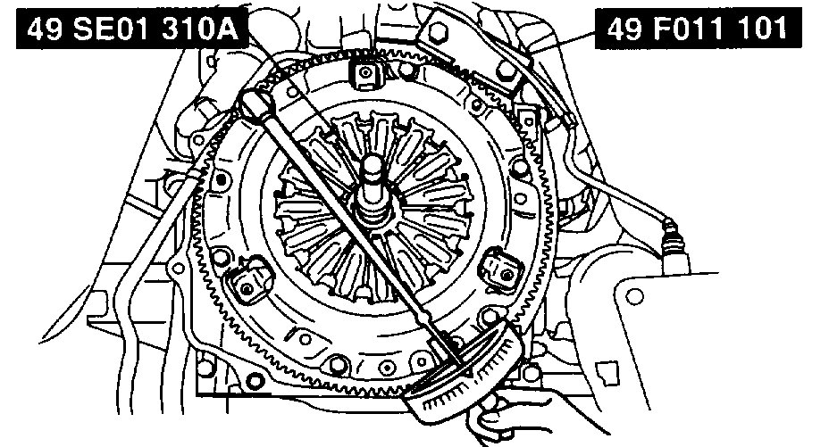

Clutch Disc Installation Note
pic 10
1. Clean the splines of the clutch disc and the main drive gear with a brush.
2. Spread a thin layer of clutch grease on the splines.
3. Secure the clutch disc to the flywheel using the SSTs.
Clutch Cover Installation Note
pic 11
1. Alien the clutch cover with the flywheel knock pin and install.
2. Tighten the bolts evenly and gradually.
Tightening torque 17.6 - 26.5 Nm (1.80 - 2.70 kgf-cm, 13.0 - 19.5 ft. lbs.)
__________________
Let me know if this helps.

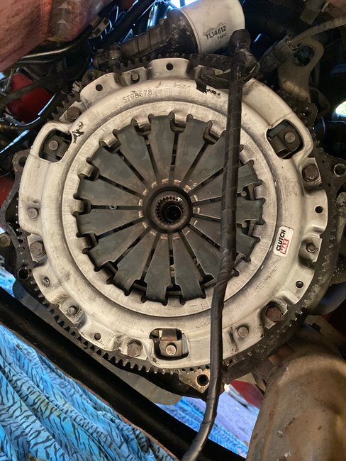

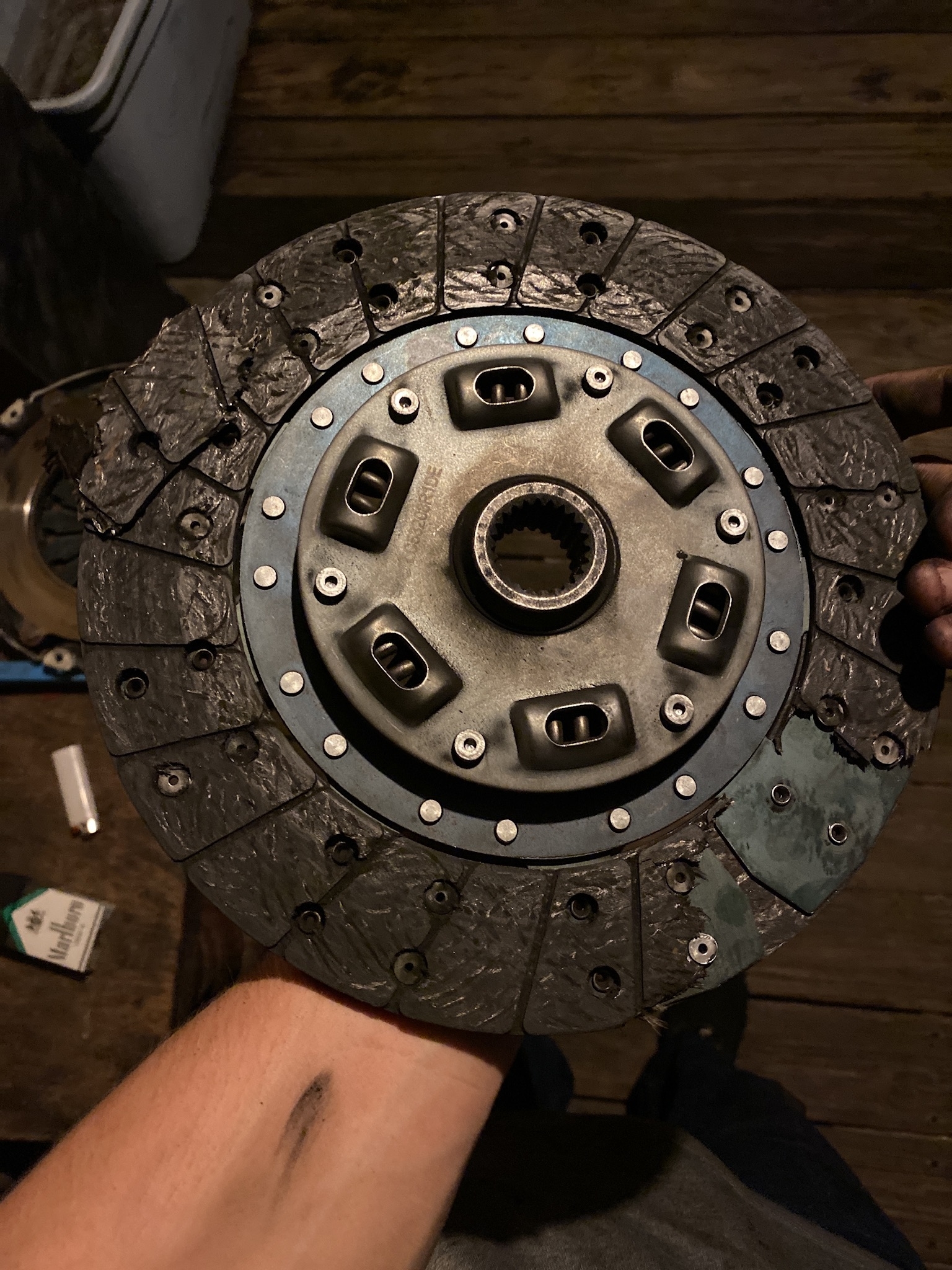

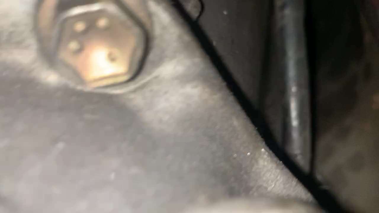

I’ve taken it apart this is the only thing that seemed off it’s grinder where the throw out bearing hits and it looks like a chunk of my clutch is gone. would either of these cause pressure loss?
Oct 18, 2020 at 5:05 PM
TY KEITH
  • 24 POSTS
And sorry it took so long, I was fighting with a stripped bolt on transmission.
Oct 18, 2020 at 5:08 PM
  • 110,194 POSTS
No problem with the time. A stripped bolt doesn't make thing go smoothly.
As far s the clutch, wow. I don't think I ever saw one break like that. To answer your question, yes. I feel you found the issue.
Oct 18, 2020 at 8:46 PM
TY KEITH
  • 24 POSTS
Thank you for your help. The thing is that’s brand new as well as pressure plate and flywheel . I’m replacing the whole kit today. I will update !
