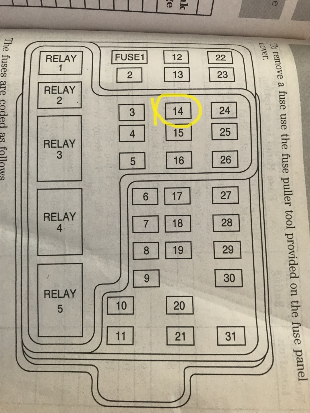

Solved! After i posted this question i'd seen some tips regarding the delay relay switches. Now it makes sense that the windows, dome light and stereo are all on a delay. When you turn off your vehicle you can still control all of the above for around 30 seconds to a minutes, then the relay shuts it off.
It wasn't a relay issue however. I found the fuse that controls that relay and yep, it was bad. Note that i'd done a continuity test. I used my multi-meter to test each fuse inside and out, and they all tested fine. Well, i won't be using that test any longer. It may take time to pull them all out, but that's what i'll do next time. I pulled fuse #14 and it was broken in the middle but seemed to have just a hair of a connection still. I replaced it and bingo.. The dome light, stereo and windows all work now.
