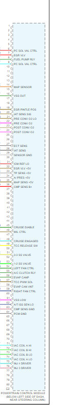

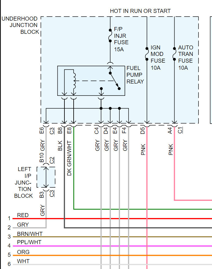

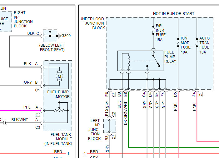

Okay, In the diagrams below I have included the wiring diagrams (enlarged just to show circuit) for the fuel pump circuit. It consists of a fused power supply to the pump, PCM controlled power, a 4 pin relay, the fuel pump, and three (3) ground locations, along with six (6) wires and a junction box. I also have included a link on how to use a multi-meter for you down below. Please go to the link and familiarize yourself with how to use a multi-meter if you need to.
Okay, I need you to get me a voltage reading at pins E6 and E8 at the under hood junction box (diagram 1). Please make sure you have your key in run/"on" and not start. Please get back to us with what you find out.

Sorry, what I need is to get a voltage reading from pin E8 in the Underhood Junction Box. It will have the dark green wire with a white stripe going to it. You will need an assistant trying to start the vehicle while you are getting your reading. Let me know what you find out please.
