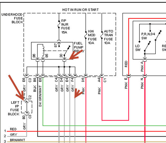

Trying to figure out whether my fuse box is bad or pcm is bad. replaced fuel pump (turns out old one was still good) [live and learn] Anyway, My f/p relay is good but the socket it plugs into is not showing constant power on pin 87 with key on as its my understanding that it should. I thought it got its power from the f/p inj fuse but that fuse tests goon AND works. Now also, I have no power for 2-3 seconds on pin 86 when key is turned on or cranking. Pin 30 (grey wire to f/p) shows continuity and pin 85 shows good ground. So, is it more likely my fuse box or the pcm? Ps: I actually havr the car running to get me by till payday till I can replace fuse box or pcm. I have a jumper from 30 to 87 and then a hot wire from battery clipped to that for power and connected to a switch.

the connection can always go bad to the pcm instead of a pcm if it sits low put some dielectric grease on the connectors then plug back in to the pcm. then make sure that the pcm is putting power out andi'd bet its 'either a poor connection or connector on pcm. pin 86 wont' get any power because it's the ground. what engine is in this so I can trace this down the relay ONLY works when the key is first turned on for a couple of seconds then when car is starter the pump runs off of the oil pressure sensor pin 85 comes from the pcm and pin 30 goes to the injectors if this is a2.4L pin 87 is hot when running you are trying to guesstimate your way through this without giving US all the info that is required, like engine size for one. PCM's don't go bad that often although not to rule it out.

Thank you sir for replying and bearing with me. And yes, there is a certain amount of guessing on my part, but only because I have asked 3 different "experts" so far about my problem and have gotten 3 different answers. This is a 2000 Oldsmobile Alero with a 2.4 L engine. I'm sorry but I thought I had said that before. Some say pin #85 is ground and pin #86 is hot coming out of the PCM. Others say the opposite. Some say pin #87 is always hot with the key in the "on" position. You seem to be telling me that pin #87 is getting it's hot from the oil pressure sending unit (which would only be hot once the engine achieves oil pressure, ie; during cranking or running) That makes more sense to me at least over the others. Also, some say pin # 30 is the grey wire leading straight to the fuel pump. You seem to be saying that it powers the injectors.Unless, you meant that it powers both.If I understand you correctly, you seem to be indicating that 86 is always ground to the coil inside the relay and 85 supplies hot from the PCM to the coil for 2 seconds which closes the contacts between 87 and 30 and primes the fuel pump.Where I'm getting confused is this: With the key in the "on" position (and not cranking or running) then how is 87 getting power from the oil sending unit to power the fuel pump on for 2 seconds? Are you saying that THAT power comes from the PCM itself via pin 85 for 2 seconds and then once cranking or running the coil opens back up and then the power comes from the oil sending unit? ( In other words the little coil inside the relay is only energized for 2 seconds to prime the pump and then the rest of the time it's open as long as the engine is running and has oil pressure?) But wait, what would be holding the contact between 87 and 30 closed then? I thought the little coil did that. Now, I've confused myself even more. I thought I was on the right track for a minute at least.Could you do me a favor and run it down for me step by step as for example:

see pic, 86 is ground 85 from pcm 87 hot when key turned on 30 goes to injectors and pump. see pic

Thanks! It looks like my fuse box is the culprit. The female socket for spade 85 of the relay is very loose and shows no power with key on for 2 seconds.I have the fuse box out right now and am going to test the green and white wire inside it and see if there's power there when I turn on the key. If there is then I'll be certain. Those fuse boxes won't let you take the tops off to fix a loose connection like that because of the 3 threaded female studs I guess.Do you know if the top will come off if I keep prying or is it made to not be taken apart? I'm afraid I might break it and then be in trouble. Dealers no longer sell those boxes either so I'll have to try one from a salvage yard if I can't fix this one. Do you know if a box from a v6 engine would work the same as my 4 cyl? I guess I could always just take out the wires going to the f/p relay and wire it up on the firewall or something. I now know the green and white wire is #85 and the grey wire is fuel pump and ground is probably black. I see that # 87 comes straight off the f/p- f/inj fuse, but don't see what color wire that would be. Do you know off hand?

we don't have a color either it doesn't give it and not sure a v6 box will work. the 87 should be the only one that is hotwith key on or look on bottom of box where relay is plugged in.
