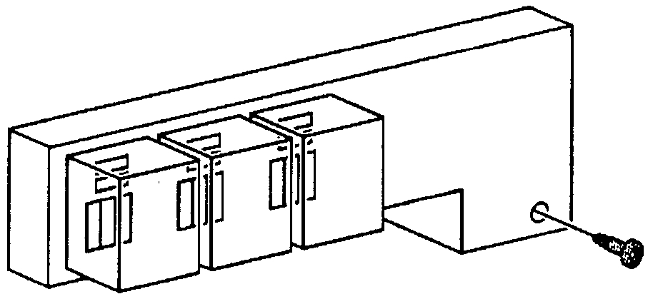

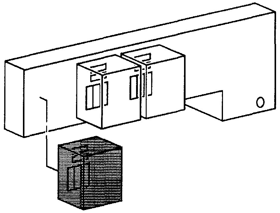

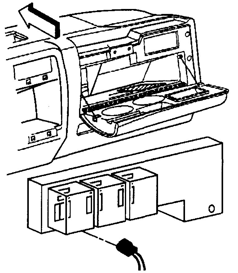

Here are the directions. That attached pictures correlate with the directions.
1996 Chevy Truck S10/T10 Blazer 4WD V6-4.3L VIN W
Fuel Pump Relay
Vehicle Powertrain Management Fuel Delivery and Air Induction Fuel Pump Fuel Pump Relay Service and Repair Procedures Fuel Pump Relay
FUEL PUMP RELAY
pic 1
Fuel Pump Relay Retainer
Pic 2
Electrical Center Connector
Pic 3
Fuel Pump Relay
pic 4
REMOVAL PROCEDURE
NOTE: The relay center is located in the glove component.
1. If installed, remove the retainer.
2. Remove the electrical center connector.
3. Remove the relay by depressing the bracket clip at the rear of the relay or by removing the bolts from the retaining bracket.
INSTALLATION PROCEDURE
Is the reverse of removal

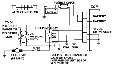

First thing will be to test the pump and it's wiring to see if it works. To do that go to the relay box under the hood. and look at the harness coming out of it, there will be a short Red wire that isn't connected to anything. That is the fuel pump prime connection. If you apply battery voltage to it the pump should come on. If it doesn't pull the fuel pump relay and you will see a diagram on it showing what the blades do, you want the ones numbered 30 and 87 Those are the feed to the pump and the battery feed from the ECM BATT fuse (#9). Take a test light and connect it to battery positive and touch those two contacts in the relay socket. On pin 30 the light should come on if the circuit through the pump is good as it will be a ground through the pump. If no light you have a problem in the Gray feed wire in the harness to the fuel pump. If it seems to work then connect the test light to ground and touch the 87 connector. This is the battery feed to the relay and the light should come on.
If those show good put a jumper across them and the pump should come on. If it does then you need to test the control side of the relay. Those are pins 85 and 86. With a test light connected to battery positive touch pin 86, it should light as this is the ground for the relay. Next connect the light to ground and touch terminal 85, then turn on the key, the light should come on for about 2 seconds. If it does the control side is working.
As it has been setting I would suspect either the pump connector to have corrosion (very common) or the pump itself is bad.
The other circuit that can verify this is to crank the engine until the oil light goes out or the gauge shows pressure. That will trigger the power feed through the pressure switch and send power to the fuel pump. If the pump doesn't come on in either case you will likely be dropping the tank to get to the pump connector and pump. You might be able to disconnect the pump pigtail without dropping the tank, if you can reach it.
Another test is to give the fuel tank a couple solid hits with a rubber mallet or similar, if the pump is marginal and sticking on a bad segment this can sometimes shock it enough that it starts working at least enough to test it, if it does start working this way do not trust it to keep working though.
Dropping the tank on these isn't that bad but you need to watch all of the vapor and vent lines as you lower it, and disconnect them as soon as possible. Be sure to replace the pump pigtail on the harness as well, they have a very bad habit of heating up and losing contact.

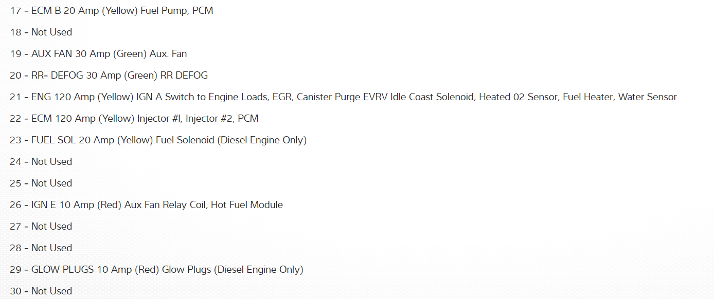

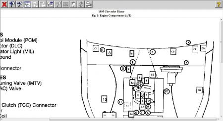

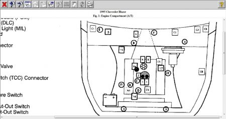

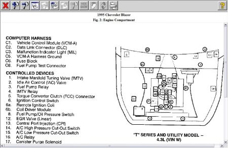

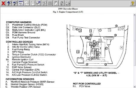

first, which relay is for the fuel pump, there are 3 relays right beside each other on firewall behind intake,

See below to locate the pump relay
https://images.2carpros.com/forum/automotive_pictures/12900_pumprelay1_1.jpg
https://images.2carpros.com/forum/automotive_pictures/12900_pump_relay2_1.jpg
https://images.2carpros.com/forum/automotive_pictures/12900_oil_sending_unit_and_fuel_pump_circuit_14.gif

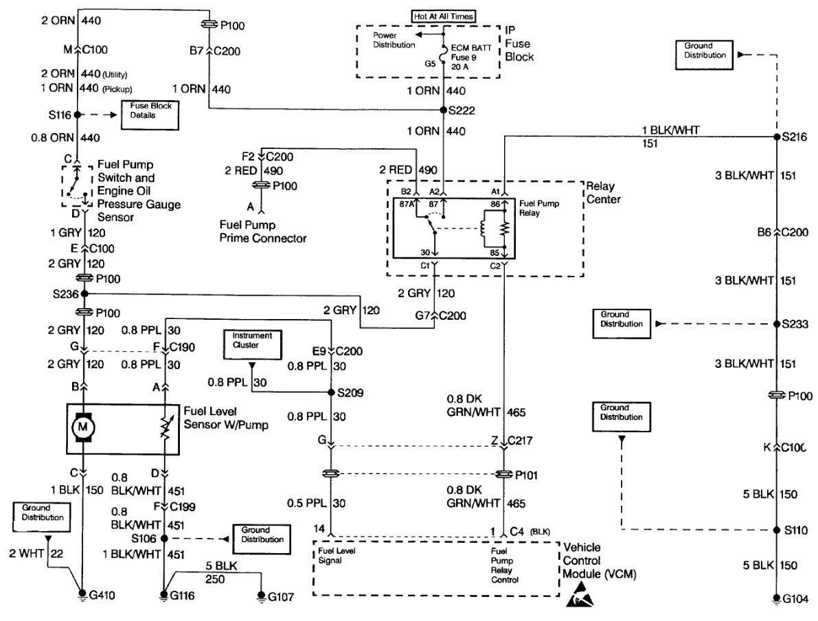

I have a 1995 chevy blazer v6 4.3 vortec and it ran ok but we had to start it with starting fluid. We replaced the fuel pressure regulator and now it wont run for more than a few seconds. everything is hooked up we replaced the fuel pump, map, maf, and tps sensors it seems like its not getting gas but theres no leaks. checked the fuel pressure before and after fuel pump change and its the same 60 then it leakes down very quickly. the car is throwing codes 22,34,and 43 for tps, map, and knock sensor. could my knock sensor do this? is there something else i should check?
Jan 30, 2021 at 12:35 AM (Merged)
HMAC300
  • 48,601 POSTS
1. Relieve fuel pressure. See FUEL SYSTEM PRESSURE RELIEF. Connect Fuel Pressure Gauge (J 34730 1) to fuel pressure connector. Turn ignition on. With ignition on and engine off, pressure should be
54 64 psi (3.8 4.5 kg/cm2 ) and should hold steady.
2. If pressure is within specification and holds, go to next step. If pressure is within specification but does not hold, go to step 4). If fuel pressure is not present, go to step 7). If pressure is greater than specification,
go to step 9). If pressure is less than specification, go to step 5).
3. Start engine. With engine at operating temperature, open throttle quickly and note fuel pressure. If fuel pressure is not close to64 psi (4.5 kg/cm2 ), replace CPI assembly. If fuel pressure is close to 64 psi (4.5
kg/cm2 ), problem does not exist.
4. Check for leaking injectors or fittings by pinching off fuel return line. If pressure does not hold, replace CPI assembly. If pressure holds, check for faulty in tank fuel pump or pump connections.
5. Check for restricted delivery line or fuel filter. Repair as necessary. If no restriction is evident, apply battery voltage to fuel pump test connector using a 10 amp fused jumper wire. For location of fuel pump test
connector, see COMPONENT LOCATIONS in SYSTEM/COMPONENT TESTS  4.3L article.
6. Gradually pinch off flexible fuel return line between CPI assembly and fuel tank. If fuel pressure increases to within specification, pressure regulator is faulty. Replace CPI assembly. If fuel pressure does not
increase with line pinched, check for faulty in tank fuel pump, loose pump connections or partially blocked fuel strainer.
7. Use a 10 amp fused jumper wire to apply battery voltage to fuel pump test connector. For location of fuel pump test connector, see COMPONENT LOCATIONS in SYSTEM/COMPONENT TESTS  4.3L
article. Observe fuel pressure reading. If fuel pressure is still not present, check wiring between test connector and fuel pump. If wiring is okay, replace fuel pump.
8. If fuel pressure is present with voltage applied to test connector, test fuel pump relay and voltage supply to relay. See SYSTEM/COMPONENT TESTS  4.3L article.
9. Relieve fuel pressure. Disconnect fuel return line. Attach a 5/16" flexible fuel line to CPI side of fuel line. Route hose into appropriate container. Turn ignition on, and note fuel pressure. If fuel pressure is within
specification, locate and repair restriction in fuel return line. If fuel pressure is still greater than specification, replace CPI assembly.
also a new regulator doesn't mean it's good either. also check battery and clean terminal ends. load test battery. Check out the diagrams (Below). Please let us know what happens.

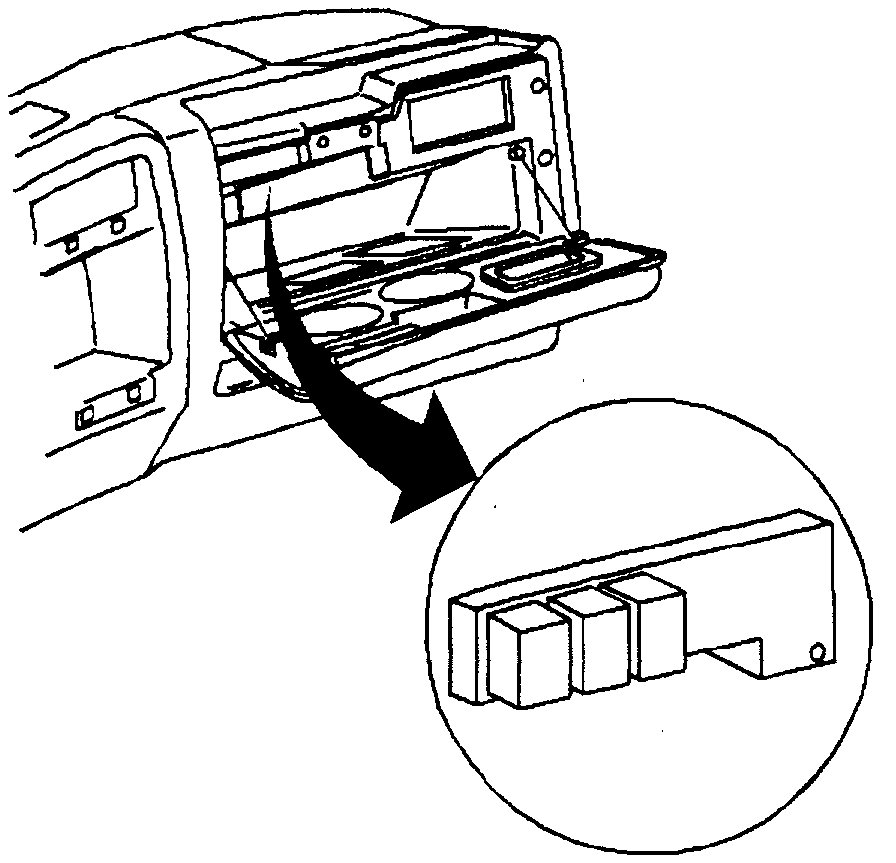

MICHAELLOVETT123
1995 Chevy Blazer 6 cyl Two Wheel Drive Automatic
i have a 1995 chevrolet blazer. i was told by a mechanic at a local shop that the problem to my truck was the fuel relay switch. Upon asking how to fix it, the man didn't know where the fuel relay switch was. Do you know where the relay is?
  • 75,988 POSTS
The fuel pump relay is in the convenience center see below
https://images.2carpros.com/forum/automotive_pictures/12900_fp_relay_9.jpg

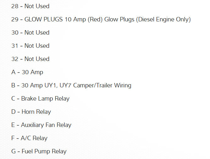

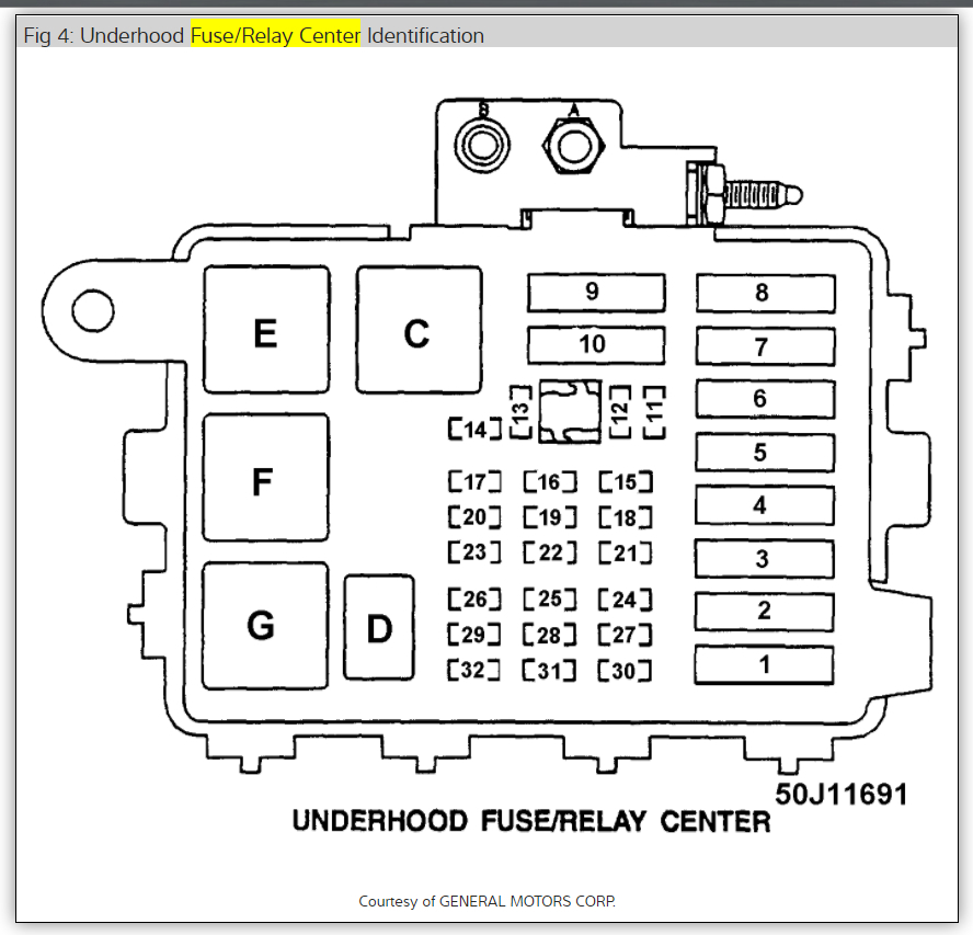

CHARLIE_CRUZ
Where is the fuel pump relay located?
Jan 30, 2021 at 12:36 AM (Merged)
  • 75,988 POSTS
Its in the convenience center see item no.3 for location
https://images.2carpros.com/forum/automotive_pictures/12900_fp_9.jpg

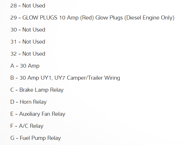

CBBECK
Will not start fuse is good. Need to check relay next but don't know where it is
WRENCHTECH
  • 20,758 POSTS
It's located behind the glove box but this truck is designed to run without aq fuel pump relay. https://www.2carpros.com/images/external/83268759.gif
