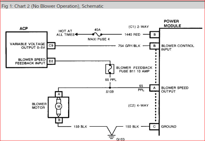

My blower motor made a terrible noise and completely quit working. I replaced the blower motor and resistor in my car. I checked the fuses and relays and every was fine. I ran a power wire from the battery to the blower motor and it worked. So I know it’s not getting power but not I’m not the greatest at electrical issues. Any help would be greatly appreciated!

Hello, I'm Danny.
Here is a wiring diagram for you cars blower motor. I'm also attaching a tutorial for you to view about blower motor operation. Here's the link:
https://www.2carpros.com/articles/blower-fan-motor-works-on-high-speed-only
Below is a picture of the diagram.Hope this helps and thanks for using 2CarPros.
