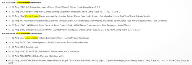

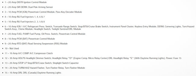

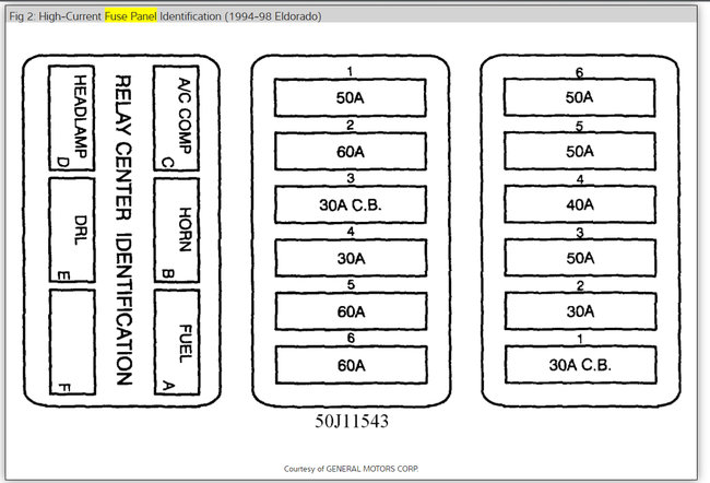

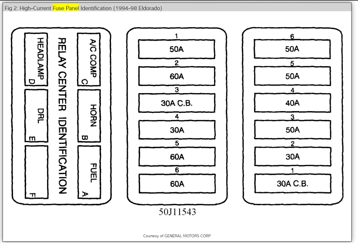

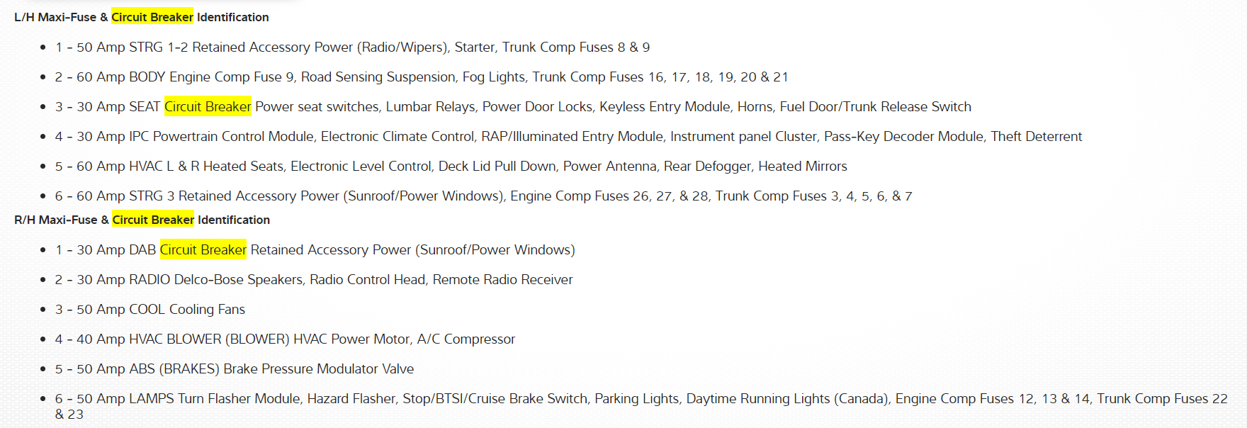

When I select AC, heat or defrost the fan won't start . I'm hoping it's just a fuse. Where are the fuses located
Aug 2, 2010 at 9:54 AM
BLUELIGHTNIN6
  • 16,542 POSTS
fuse blocks are located to left of the steering column under the dashboard, behind a carpeted cover on right side of the dash, behind a panel inside the glove box in the trunk compartment or under the hood. #4 fuse 40 amp

SCOTTGUN
That did the trick thanks guys!
