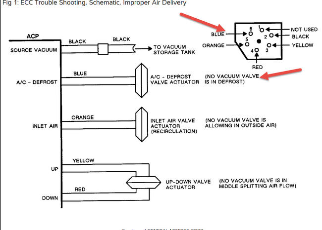

No air coming out of front vents ( from defroster & floor vents only).I saw in one of your 2012 blogs that blower speed module is probably the culprate, you did not give a real clear discription of what it looks like and where exactly it is located. Please give me this information, it would be highly appreciated. Thank You! Frank. P.S. Please see (2) pictures , is this the Blower Speed Module?

there are no pics if it is lowing out of floor and defrost then it's not the module. check vacuum motor in pic to see if it is getting vacuum or not if it is the motor is no good if it's not getting vacuum the control is bad.
