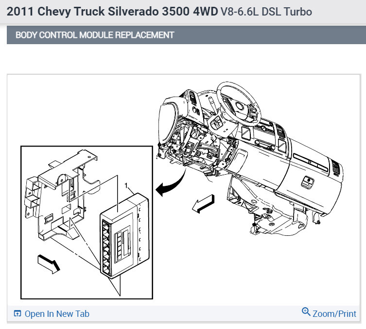

I have. The truck listed above is a 3500 Duramadre diesel. Several times this has happened. Upon acceleration the motor trips and shuts off but cokes right back to like nothing happened. I have changed the fuel pump, put in 2 new batteries and even changed the computer. Today it did the same thing but shut down and did not start at all. Nothing works when I turn the key. I’ve watched videos but can’t seem to find really the same issue.

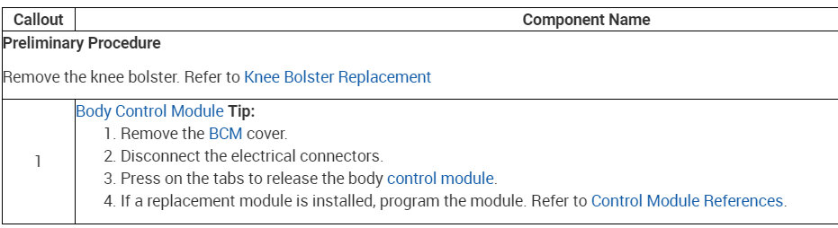

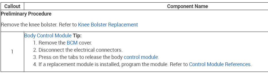

If the fuses are okay, it sounds like the BCM is going out but to be sure let's run a CAN scan. you can get a CAN scanner (Controller Area Network) which will work on most cars from Amazon.
https://youtu.be/u-4syLc-ifQ
Here is how to change the BCM out in case you get a code for it, you can get a preprogrammed unit by searching Google or Ebay. Check out the images (below). Please let us know what happens.
