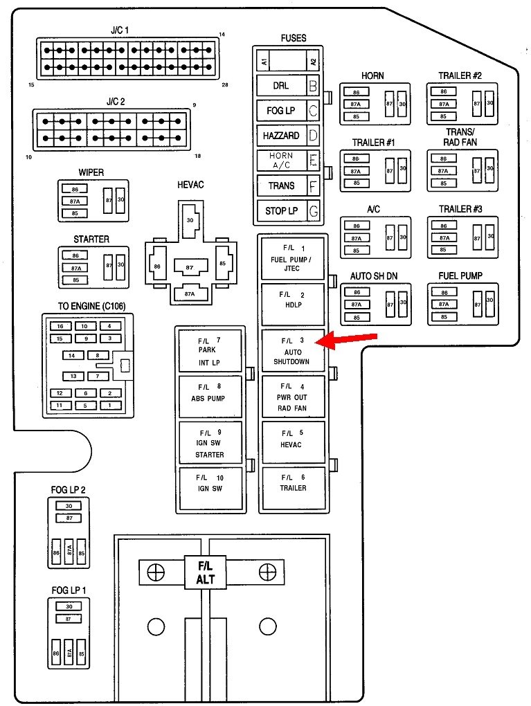

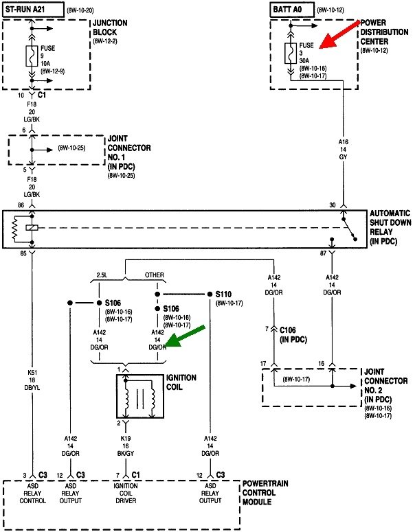

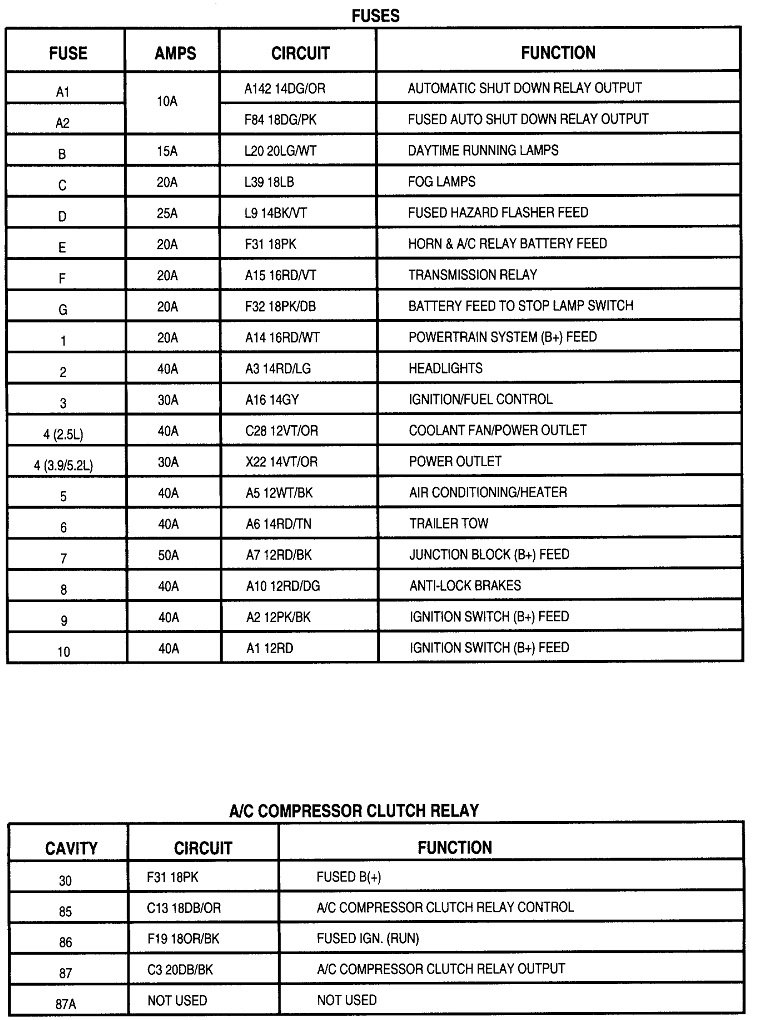

Whether or not a fault code has set related to the problem, a quick test is to check for 12 volts at the ignition coil, any injector, or either smaller terminal on the back of the alternator. You can use a digital voltmeter but most of them don't respond fast enough. A test light is a better choice for this test. Use the wire that is the same color at each of those places. On most Chrysler products that's a dark green / orange wire as shown with the green arrow in this diagram. Your test light should light up full brightness for one second when you turn on the ignition switch. In the rare event it does not, check fuse # 3 in the power distribution box, (under-hood fuse box). If that is blown, the best suspect is the wiring harness to an oxygen sensor has fallen down onto hot exhaust parts.
Next, the test light must turn on again when you're cranking the engine. If it doesn't, you can see the missing signal from the distributor on a scanner, but since this is so common, just replace the pick-up assembly. Many people carry a spare in the glove box. If you installed a used distributor, there's also a good chance it has a defective pick-up assembly.

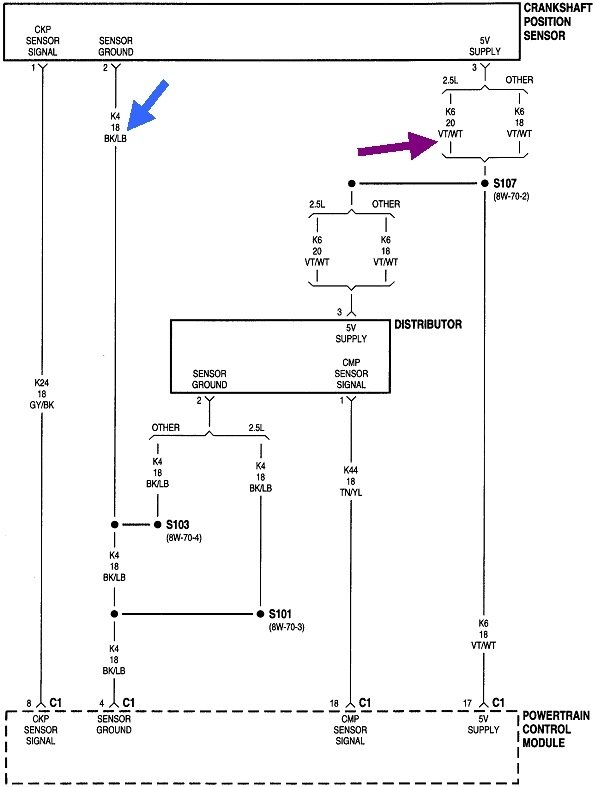

There's no easy way to test the crankshaft position sensor other than to check the supply voltages. There should be 5.0 volts on the violet / white wire. Expect to see 0.2 volts on the black / light blue ground wire. Beyond that, the best way to see if both sensor signals are showing up at the computer is to view live data on a scanner. Each one will be listed with a "No" or "Present" during cranking. I use a Chrysler DRB3 for all of my vehicles. Aftermarket scanners will have a similar way of showing this.
