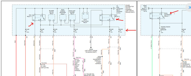

The test light helping the circuits is a clue, I would check the ground cable from the battery to the chassis and to the engine block, if one of these got pulled off during the roll over it will cause this issue. This sounds like a major electrical supply issues. Here are the major fuses and relays to look at to make sure they are good and none of the relays have fallen out, Check out the images (below). Please upload an image or a short video in your response, so I can see what's going on.

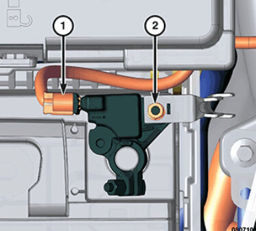

So does the car have any electrical at all? Did you remove the main battery and have it load tested? Can you upload as short video on what the car is doing so I can see it? Also, most 2016 Cherokees have a pyrotechnic battery disconnect that fires in crashes. I would see if you have power at the main cable after this device. That way you can tell if is good or not. Check out the images (below). Let us know how it goes

thanks, i have replaced that but not checked the wire down from it will do that. i also found that when i checked the starter relay plug i had ground with test light plugged into the positive terminal but no power when plugged into Neg i also checked starter switch no power. i also checked all the ground wires in the engine bay and even added a couple more. sorry i don't know how take photo and download.

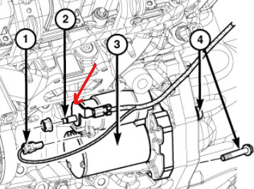

So to confirm this is the cable you have no power at? To upload an image use your phone and upload the image in your response. Check out the images (below). Do you have power at the main power lug of the starter?

yes, have power to the starter, having test light to neg. on battery to power on starter the light comes on.

So when you turn the main systems of the car on do they work? Also, while the systems are on did you double check all of the fuses? This guide can help
Please go over this guide and get back to us.

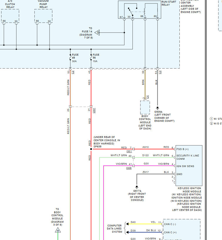

Yes, the power for the ignition switch module is supplied from the #56 fuse, does it have power? Check out the images (below). Let us know how it goes

yes, their is power to the fuse and it looks good

Yes they work good for probing for power to see where you are losing it, use the wiring diagrams I gave to double check everything, we must be missing something.

I found that when i took off the connection to the switch i do have power to the switch but i don't have and ground.

Check out seems to be good. I went back to the voltage sensor on the neg. battery cable, i was checking the 2 wires a red one that checked out ok but the orange one had a weak signal open wires up found a place it had spliced together may be the problem, but i have a little darker orange wire coming from another area going to i think both connecting the same wire going to inside of the car only found that one wire is that possible they should connect together and should i wirer it together that way? I ordered a new plug and wires to go into voltage censor.
