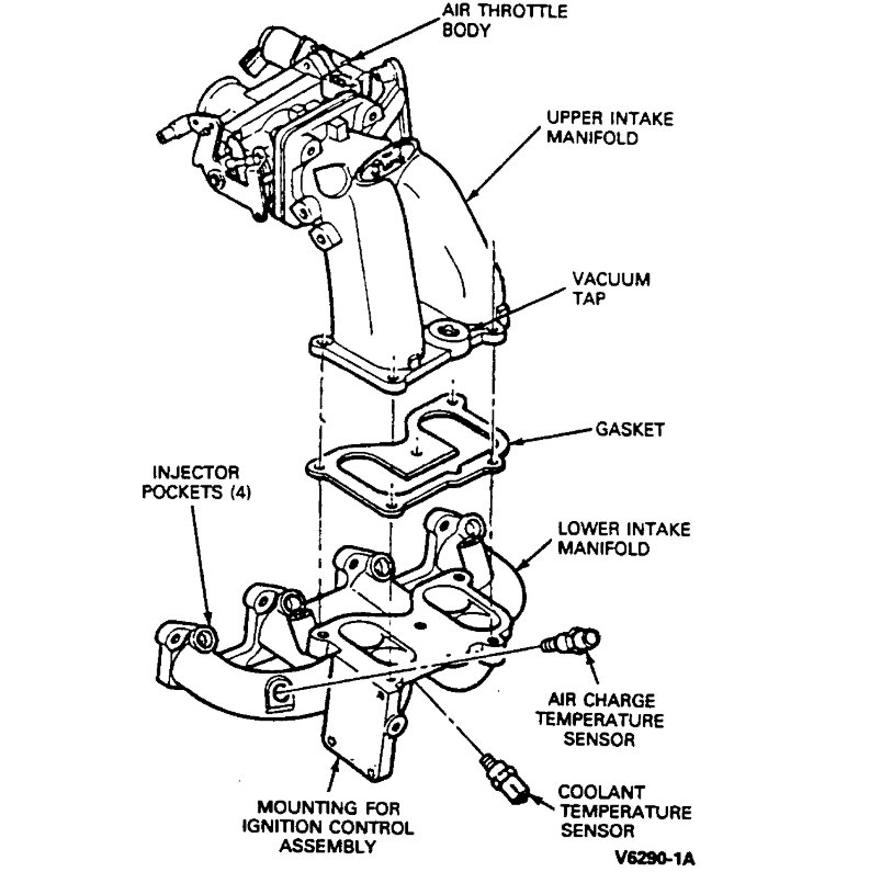

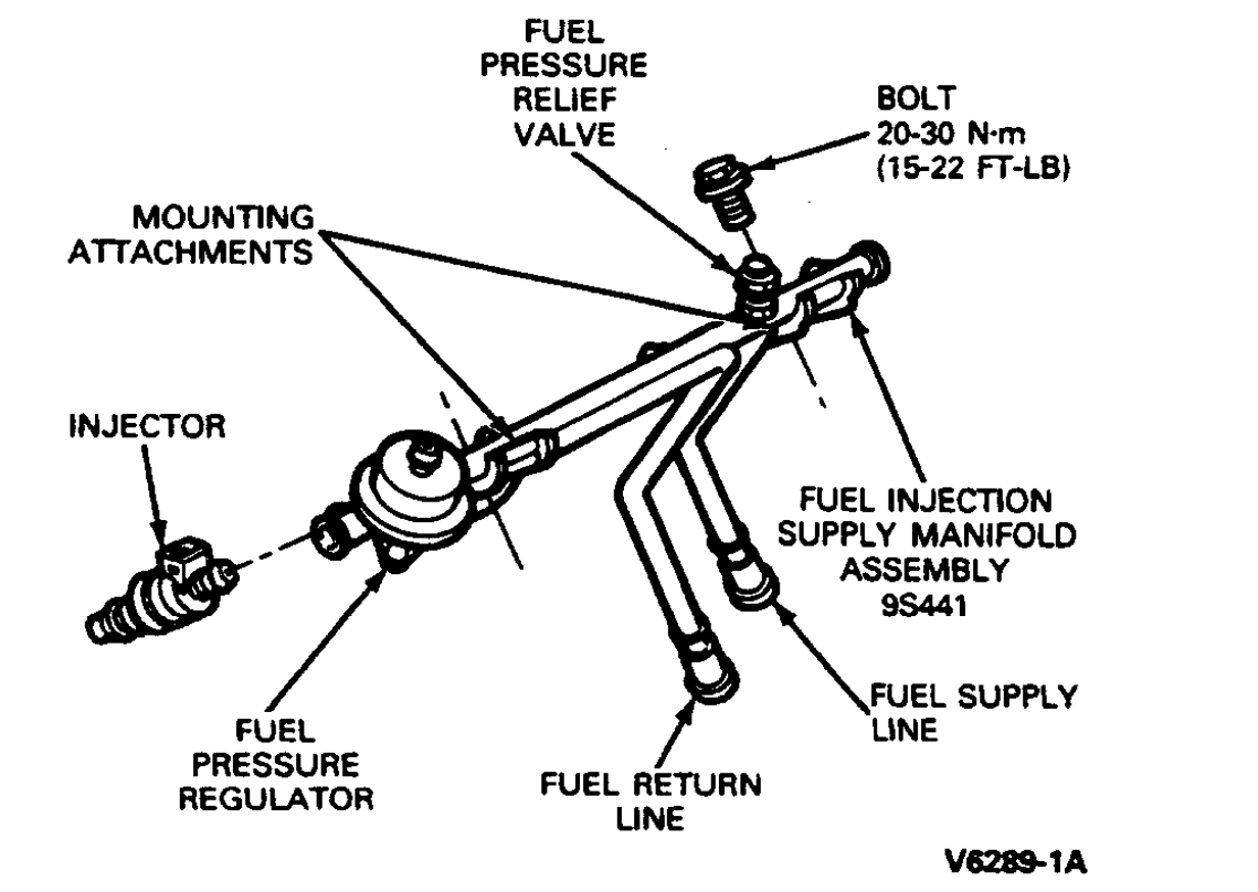

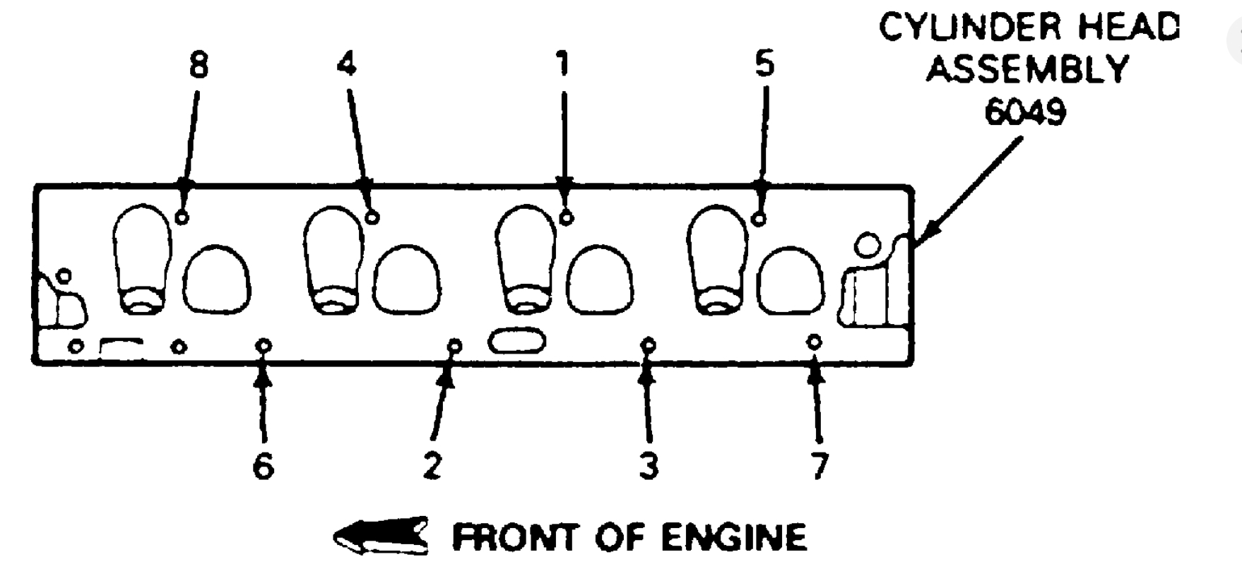

If it stalls like this, you have a good chance of the intake manifold gasket is leaking vacuum. That will cause the engine to stall.

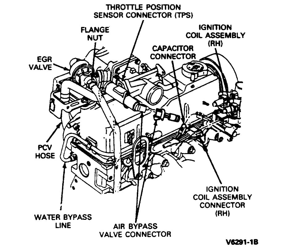

REMOVAL
1. Open hood and install protective covers.
2. Ensure ignition key is in OFF position.
3. Drain coolant from radiator.
4. Disconnect negative battery lead and secure it out of the way.
5. Remove fuel cap to relieve fuel tank pressure.
Fuel Pressure Relief Valve/Test Port
6. Release pressure from fuel system at the fuel pressure relief valve using EFI Pressure Gauge T8OL-9974-B or equivalent. The fuel pressure relief valve is located on the fuel injection supply manifold assembly in the upper RH corner of the engine compartment. To gain access to the fuel pressure relief valve, the valve cap must first be removed.
Connector/Component Locations
7. Disconnect electrical connectors at:
a. Throttle position sensor.
b. Air bypass valve.
c. Injector wiring harness at main engine harness and at water temperature indicator sensor.
d. Air charge temperature sensor.
e. Engine coolant temperature sensor.
f. Ignition control assembly.
8. Disconnect upper intake manifold vacuum fitting connections by disconnecting:
a. Vacuum lines at upper intake manifold vacuum tree. Labeling the hose locations with tape is recommended to aid reinstallation.
b. Vacuum line to EGR valve.
c. Vacuum line to fuel pressure regulator.
d. Canister purge line.
9. Remove throttle linkage shield, and disconnect throttle linkage, cruise control. Unbolt accelerator cable from bracket and position cable out of the way.
10. Disconnect air intake hose and crankcase vent hose.
11. Disconnect PCV system by disconnecting hose from fitting on underside of upper intake manifold.
12. Loosen hose clamp on water bypass line at lower intake manifold, and disconnect hose.
13. Disconnect EGR tube from EGR valve by removing flange nut.
14. Remove five upper intake manifold retaining bolts.
15. Remove upper intake manifold and air throttle body assembly.

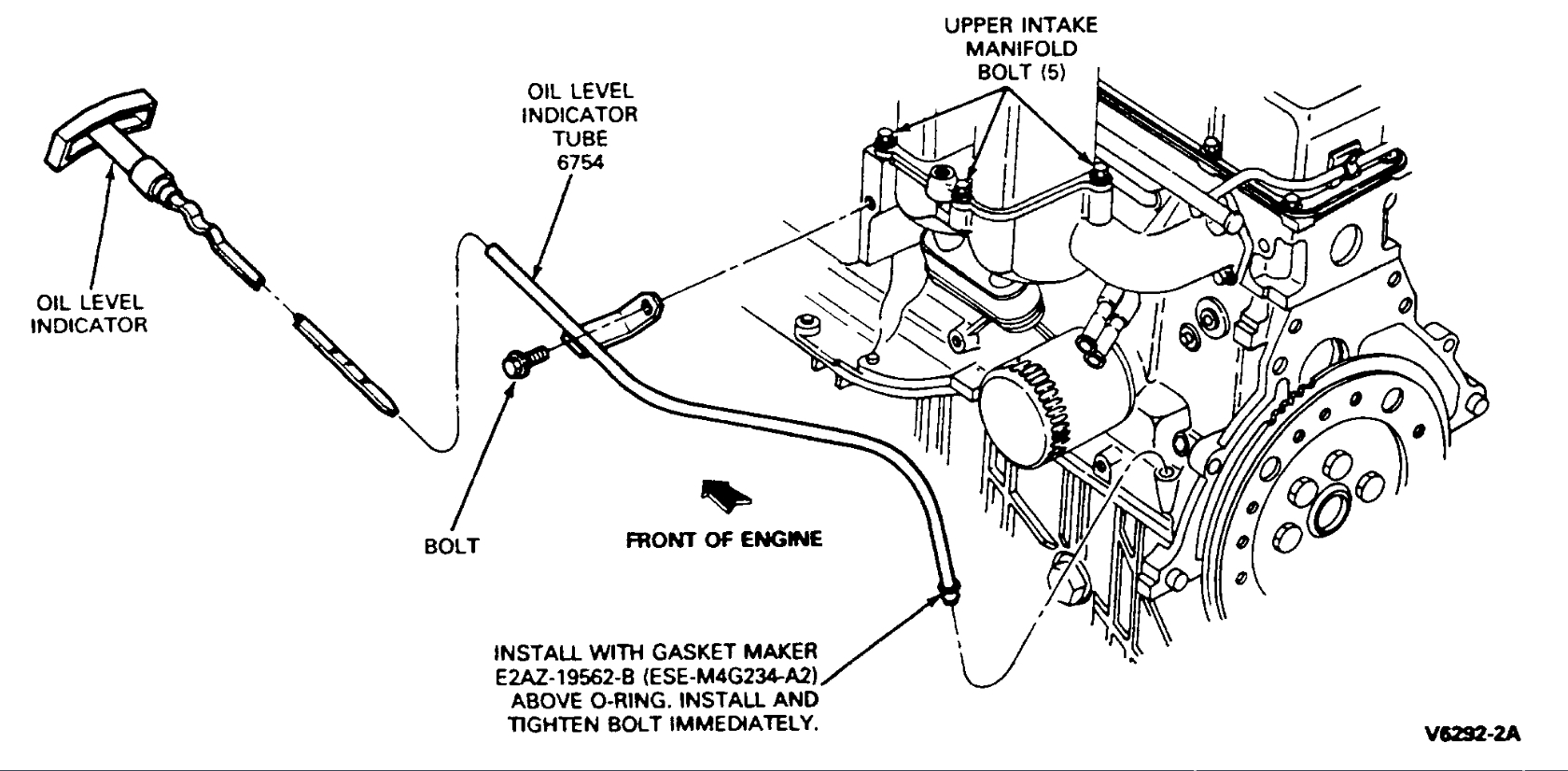

Oil Dipstick And Bracket
16. Remove engine oil dipstick bracket retaining bolt.

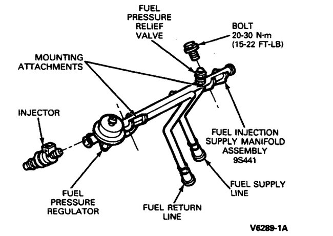

17. Remove springlock coupling retainer clips from fuel inlet and return fittings.
WARNING: Relieve fuel system pressure before disconnecting coupling.
18. Disconnect the push connect fitting at the fuel supply manifold and fuel return lines.
19. Disconnect the electrical connectors from all four fuel injectors and move harness aside.
20. Remove two fuel supply manifold retaining bolts. Carefully remove fuel supply manifold and injectors.
NOTE: Injectors can be removed from the fuel supply manifold at this time by exerting a slight twisting/pulling motion.
21. Remove four bottom retaining bolts from lower manifold.
Intake Manifold Assembly
22. Remove four upper retaining bolts from lower manifold.
NOTE: The front two bolts also secure an engine lift bracket. Remove lower intake manifold assembly.
INSTALLATION
1. Clean and inspect the mounting faces of the fuel charging manifold assembly and the cylinder head. Both surfaces must be clean and flat.
2. Clean and oil manifold bolt threads.
3. Install a new gasket.
4. Position the lower manifold assembly to head and install engine lift bracket. Install four upper manifold retaining bolts fingertight.
Fig. 5 Lower Intake Manifold Bolt Tightening Sequence
5. Install four remaining manifold bolts. Tighten all bolts to 20-30 Nm (15-22 ft lb) following the tightening sequence.

8. Ensure that gasket surfaces of upper and lower intake manifolds are clean.
9. Place a new service gasket on the lower intake manifold assembly and place the upper intake manifold in position.
Fig. 4 Upper Intake Manifold Tightening Sequence
10. Install five retaining bolts and tighten in sequence to 20-30 Nm (15-22 ft lb).

11. Install engine oil dipstick and retaining bolt.

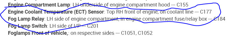

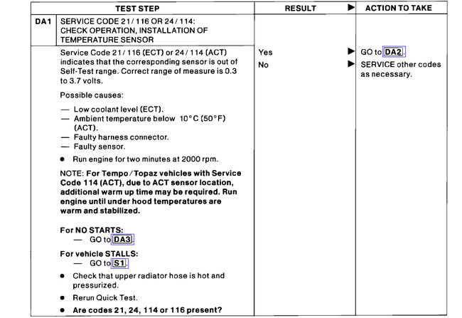

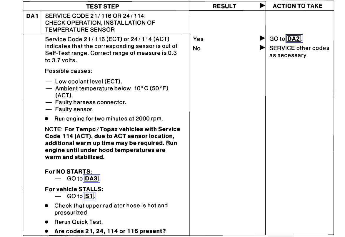

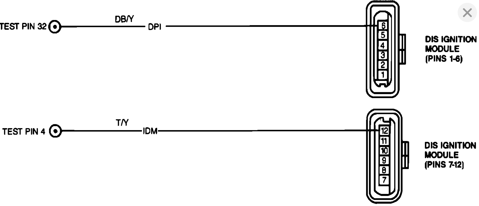

Ran a self check with check engine light i got 21121 and 111111. what do these codes mean?
Jul 18, 2020 at 5:29 AM (Merged)
Okay, the 11 series means it passed. No issues with that one
The other is code 21 and code 211.
I posted the possibilities for the 211 below.
The 21 is for the coolant sensor for the engine by the thermostat.
https://www.2carpros.com/articles/how-a-coolant-temperature-sensor-works
None of these codes have anything to do with the bad valve issue.

211
REMEMBER
To prevent the replacement of good components, be aware that the following non-EEC areas may be at fault.
DIS ignition module
DIS coil pack(s)
Spark plugs and high tension cables
Crankshaft sensor.
Camshaft sensor, if equipped.
Arcing of secondary ignition components
This Pinpoint Test is intended to diagnose only the following:
Harness Circuits: IDM, DPI, SAW
Processor assembly
DESCRIPTION
The Ignition Diagnostic Monitor is an input signal to the processor that verifies spark function based on the flyback voltage created by the ignition coil primary discharge, otherwise known as TACH. This signal is transmitted from the DIS module to the processor. The IDM signal consists of a single pulse for each successful ignition event. Lack of an IDM pulse is used as an indication of intermittent and/or missing spark event.
Coolant sensor
REMOVAL
NOTE: The Engine Coolant Temperature (ECT) sensor is located in a tee in the heater water hose.
1. Disconnect negative battery cable.
2. Partially drain cooling system.
3. Disconnect ECT sensor electrical connector.
4. Remove ECT sensor from tee in heater water hose.
INSTALLATION
1. To install, reverse removal procedures.
2. Tighten the ECT sensor to 8-13 Nm (6-8 ft lb).
3. Refill cooling system.
NOTE: When the battery has been disconnected and reconnected, some abnormal drive symptoms may occur while the powertrain control module relearns its adaptive strategy. The vehicle may need to be driven 10 miles or more to relearn the adaptive strategy.
