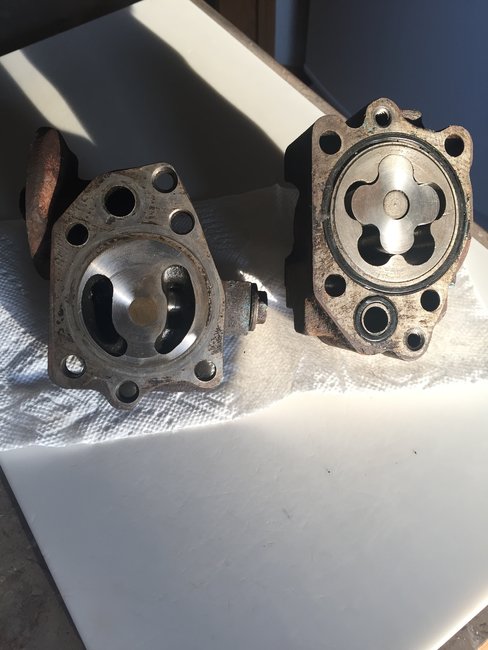

Lately I started this beast and immediately saw that the oil pressure light stayed on. I shut it off and began my search for the problem. When I removed the sending unit and turned the engine over, no oil came out of the hole. I removed the oil filter, turned the engine over and found that the oil pump is working. Have you ever heard of a Fram oil filter blocking the oil flow due to some manufacturing defect? Is the next step pulling the oil pan and checking bearings?

With much effort I got the pump removed and measured some of the clearances. The clearance at one wear spot on the cover was a tight .002. At the tip of one lobe of the rotor to the inner lobe of the outer race it was .012. The others were within specs. After the fun of looking for a piece of pipe for a suitable extension handle for my ratchet and a pry bar to hold the socket in place so I could get the pump off, I think I will try to jury rig a vacuum setup to see how easy it is to draw up oil from the pan. If it is easy to draw up then the problem has to be the pump or further up the line. Someone had mentioned a burr on the pressure valve in the pump that caused low oil pressure but I'm not that lucky this time.

My pump is an exterior mounted unit, On my first page of posting I gave some wear measurements on my pump but have not found any information as to how much wear causes pump failure. It's unfortunate that we weren't able to take all the failed pumps that were replaced and the low oil pressure issue solved with a new pump. Those pump measurements would be handy now.

Can you post a picture of the pump?

I got the pan off today. No metal in the bottom. Nothing looks discolored from heat, thankfully. No debris clogging the pickup. Here is a pic of the pump. I gave some wear measurements earlier. With the moderate use this vehicle has seen, if a bearing has spun would it be most likely a rod or main?

Looking at the pump, physically it looks good. However, if I recall, there was excessive clearance.

Since my last post I had a close look at the o-rings under the pump cover. The body of the large one looked more square than round in cross section. Maybe it was this way new. The smaller one was round in cross section and appeared to have a small dent in it. My local bearing store had o rings that would fit so I replaced them in the pump and gave the pump a good oiling. After reinstalling the pump I spun it with a drill with a container of oil under the pickup. I got oil dripping from various engine parts but no oil at the sending unit. Today I moved the crankshaft a few degrees so I could see further up at the front of the camshaft to check for any problems there. Then I removed the sending unit and my helper ran the pump. The oil appeared and gave me a mess to wipe up. I replaced the sending unit, checked the oil pressure light with the pump turning and the light went out. I have to clean up the pan, get gaskets, etc before I start the beast and see if all is well. Thank you for your responses. I'll post the later results.

'Thanks to all for being a sounding board for this sudden problem. It appears that all I did was change the oil pump o-rings which solved it. I was doubtful that oil pressure would return when I ran my pump with my drill and no oil came over the lifters but it did come out of the oil sending unit opening. With some concern I started the engine. The lifters got a bath like Niagara Falls. I hope the problem is solved so other spring work can get done.
