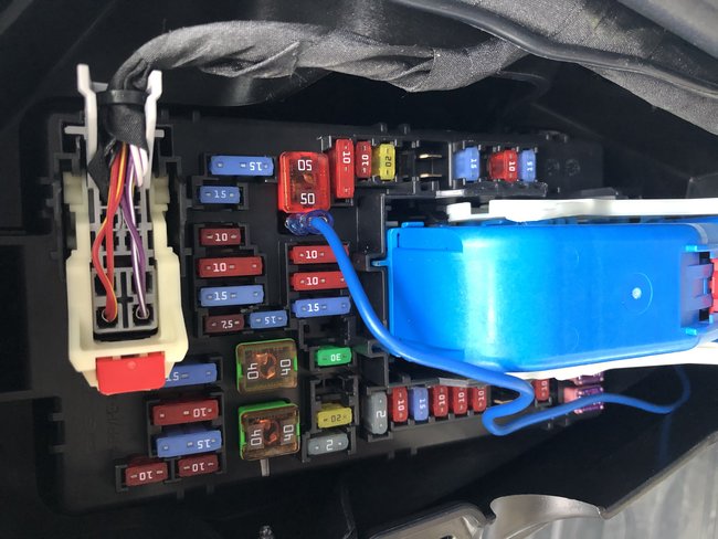

See pic for reference. I will explain exactly how this installed. All is GM factory harness to make this as true plug and play there is. Power wire from battery plugged into main harness. Ground attached per GM instructions. Tapped into the speaker wire per instructions. Ran harness from front to back and plugged harnesses into sub and amp per instructions. Reconnected negative battery terminal and climate control section did not work. Next day, removed negative battery cable for 2O minutes and reinstalled. Climate control worked properly, and this error message starting coming up.

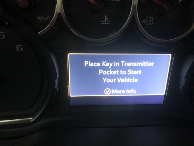

COOTERBROWN
  • 14 POSTS
It does indeed say the key is “not detected” and then the image below pops up. The key is in my lap at that time. Once I put it in the cup holder, the truck will start. The truck is under warranty, I just purchased it new in July ‘20. It has 5,000 miles on it. I guess my only option at this point it to take it into the dealer. Oh yeah, should I try and replace the battery in the fob? Both fobs are getting the same message. but I guess it doesn’t hurt to try.

It is highly unlikely in your situation that this is a battery issue in the fob not only because those batteries have about a 7 year life span on them but as you said, both are doing it.
You have most likely an antenna issue. One more question, when you installed the sub, where did you put it and did you happen to take any connectors apart? I am wondering if we didn't get one of the antenna connectors completely snapped back together.
The reason I ask, is there is no question that at this point the vehicle is not able to locate the key as being inside the vehicle so it gives you this message. So that means we have either an antenna issue or module issue and it would make sense if we unhooked one and didn't get it back together.
Let's chase this down before you go to the dealer because if they find it, they will charge you as that is not a defect. So let's go from there and if this is not it then I am sure it would be warrantable.

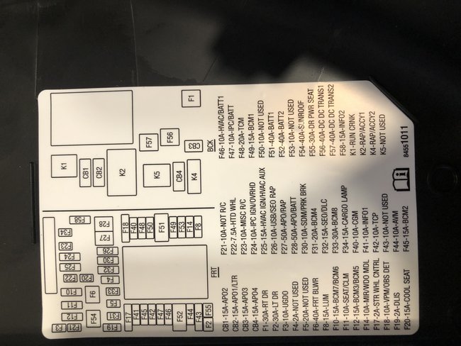

COOTERBROWN
  • 14 POSTS
Think I’ve narrowed it down. I’ve noticed my dash cams have not been coming on. They are powered by an expansion battery which is on a switched fuse. The plug on the battery to the camera comes unplugged rather easily and I’ve not checked until today. The camera is not unplugged which means I am not getting power from the switched fuse. After checking the fuse location with my voltmeter, I am not getting a voltage reading. See attached picture, it is F27&28 (50A-APO rap/batt). I do not know where the power for this fuse originates but it surely has to be the issue. Any ideas?
Edit: If looking at F27/F28 the far right pin does have voltage but the middle and far right do not.
Dec 19, 2020 at 1:34 PM

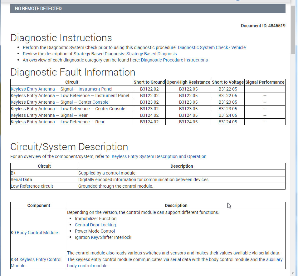

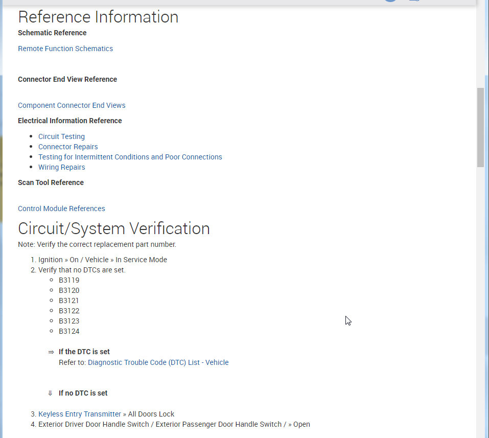

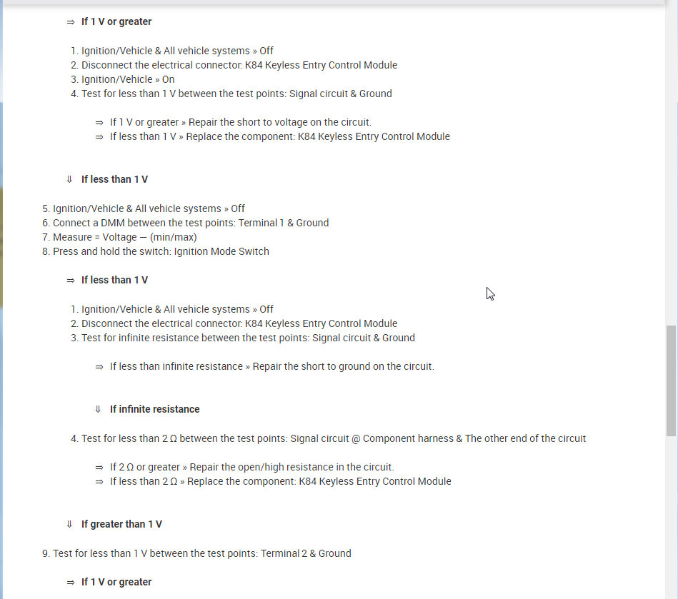

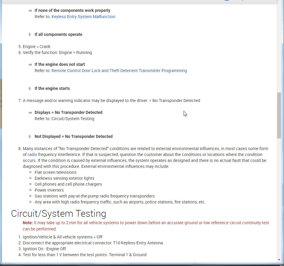

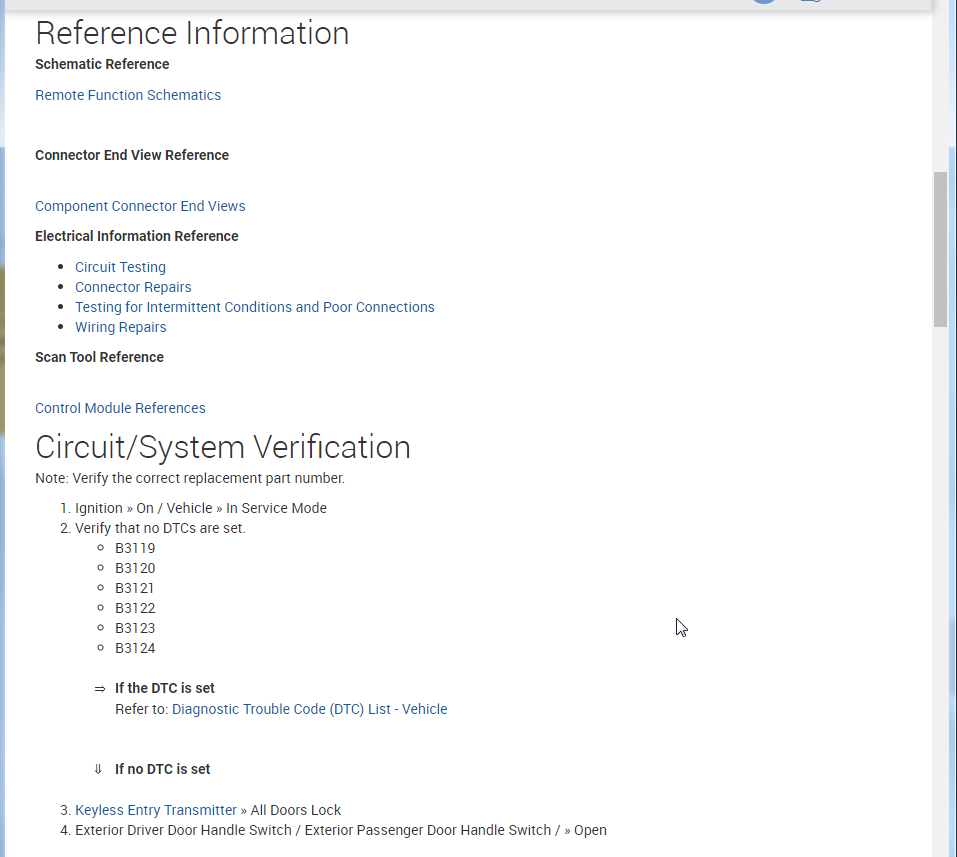

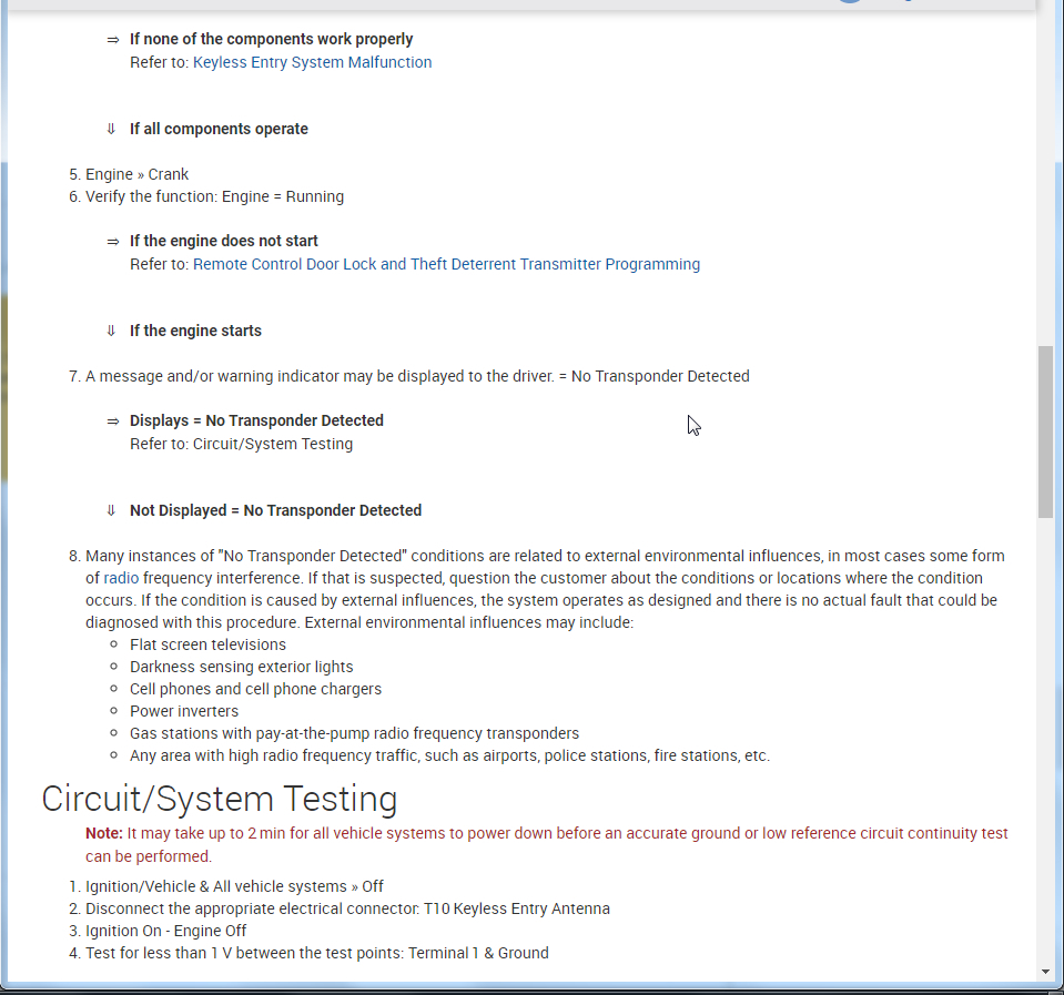

Okay. If that is the case, let's start at the very beginning of this issue because at this point we are going blind trying to figure out possible issues. if you have no power there, then I suspect you have a code that will point us to where we need to go. Specifically a B code if I am correct that this is an antenna issue.
Here is the testing for your issue of No Key Detected. As you can see with this testing there are codes that go with it so let's see what we have in the truck and then we can continue to with that specific testing.

How do I figure out if there is a B code? Have to use a scanner?
Dec 20, 2020 at 9:57 AM
Yes. Sorry meant to include a guide that will help with that.
If you don't have one, most parts stores will do this for free. Some have stopped offering a free service but I am sure there are some that do in your area.

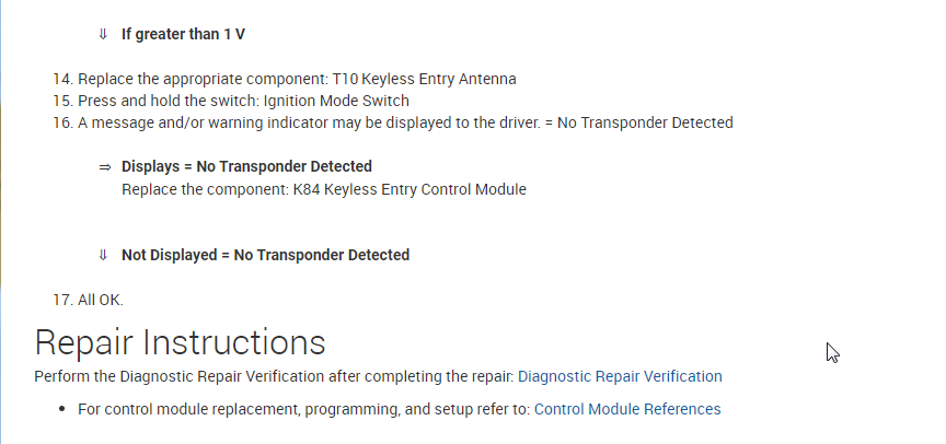

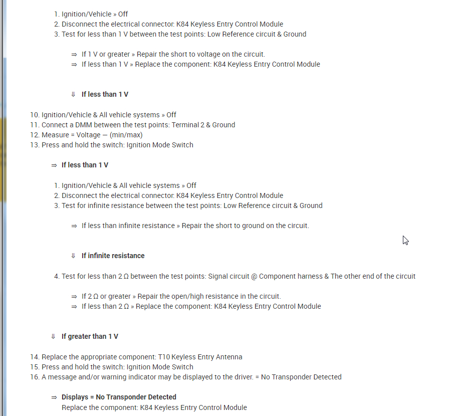

Okay. I don't have any question at this point that this is not related to what you installed. However, if you look at the second page I attached before and you will see where it says if there are no DTCs to proceed with testing. Basically it is asking to check key fob operation. Does it lock and unlock? If so, try to start the vehicle. If it does not start then it wants you to program the keys again. You need a scan tool that can do that so it may need to go to the dealer if your tool doesn't do that.
