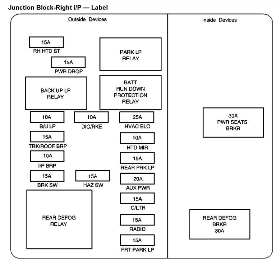

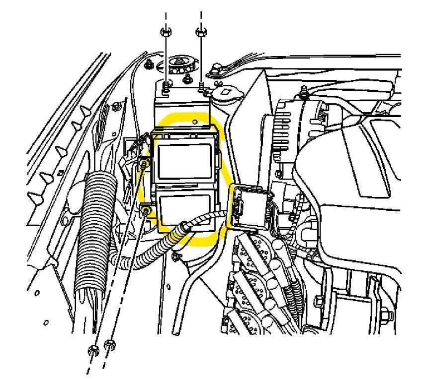

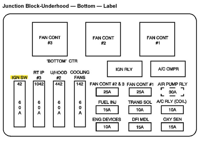

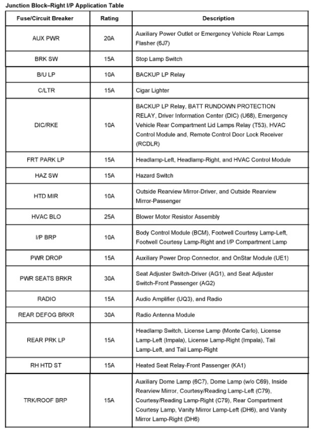

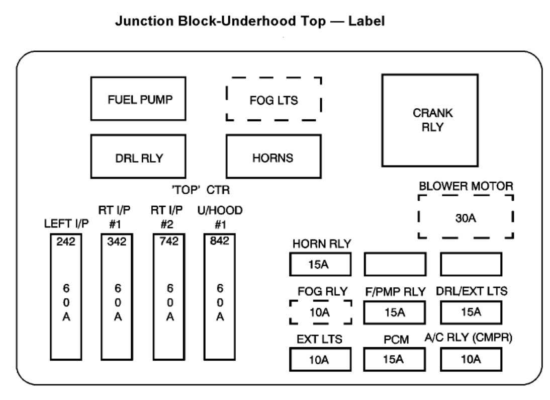

I replaced my heater core and when the dash was put back the fuel gauge, radio, climate control, interior lighting, and brake lights were not working.
Apr 12, 2022 at 9:07 PM
WENDY W
  • 86 POSTS

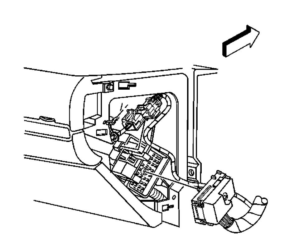

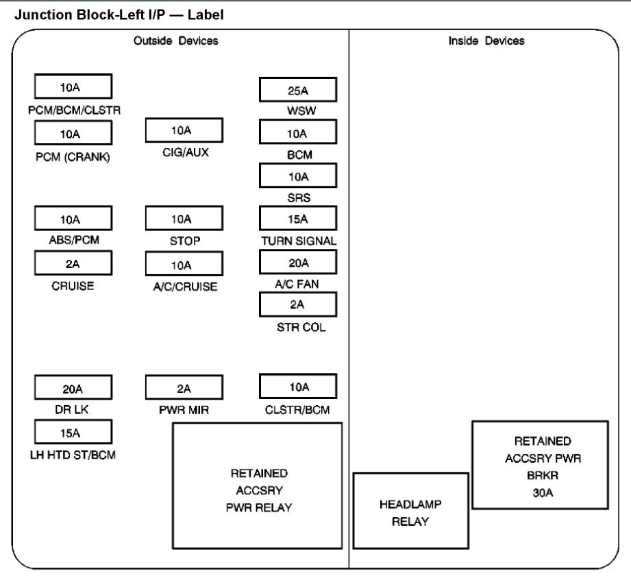

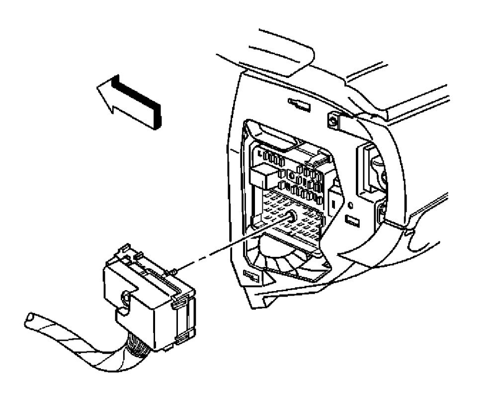

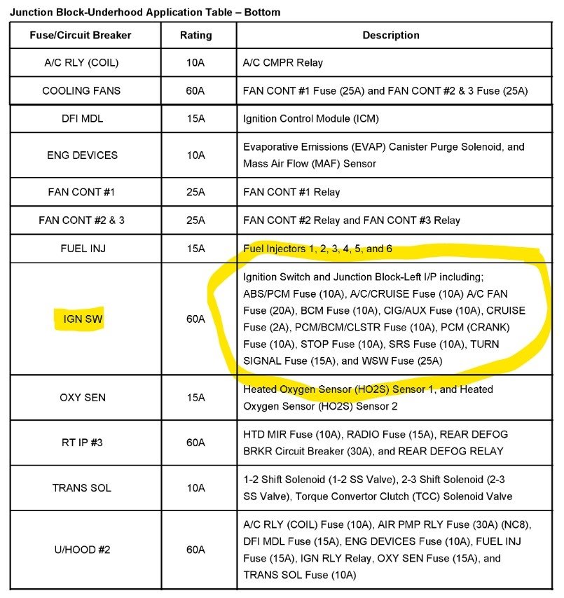

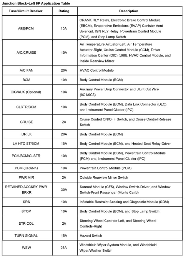

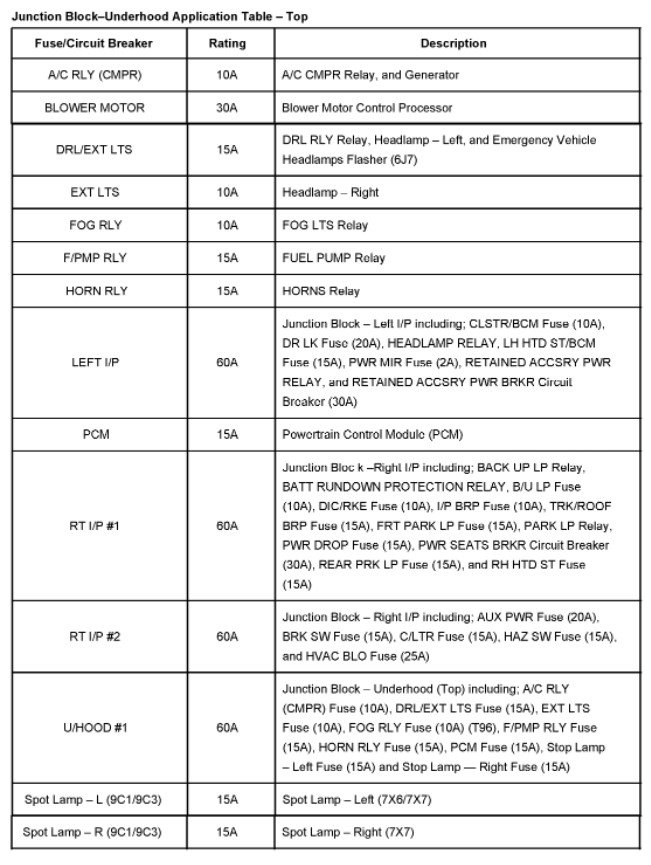

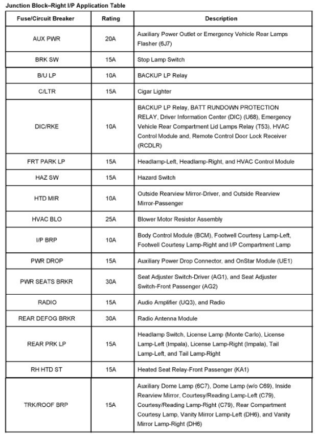

It sounds like maybe one or more of the fuses have blown. I've attached the fuse block locations and fuse identification below. The bottom under-hood fuse block contains a 60amp fuse, labeled IGN SW, for many of the systems you're describing that are not currently working.
These guides provide some helpful tips on checking fuses and wiring:
If there are any blown fuses, the next step is to find out why that happened.
Please let us know what you find, and we'll be happy to offer further assistance.
