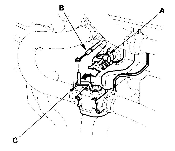

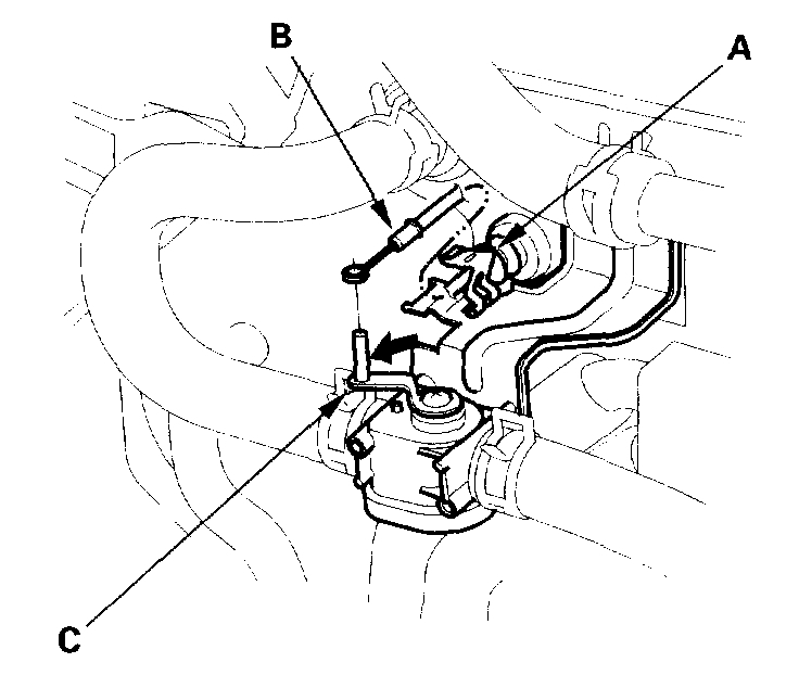

3. From under the hood, open the cable clamp (A), then disconnect the heater valve cable (B) from the heater valve arm (C). Turn the healer valve arm to the fully opened position as shown.

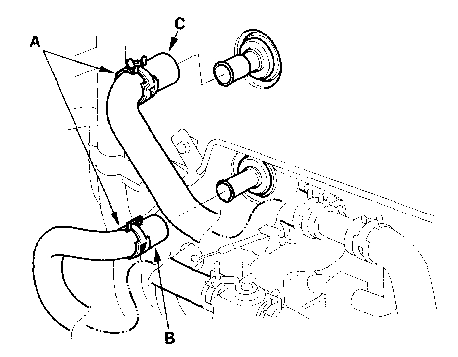

5. Slide the hose clamps (A) back, then disconnect the inlet heater hose (B) and the outlet heater hose (C) from the heater unit. Engine coolant will run out when the hoses are disconnected; drain it into a clean drip pan. Be sure not to let coolant spill on the electrical parts or the painted surfaces. If any coolant spills, rinse it off immediately.

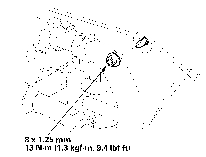

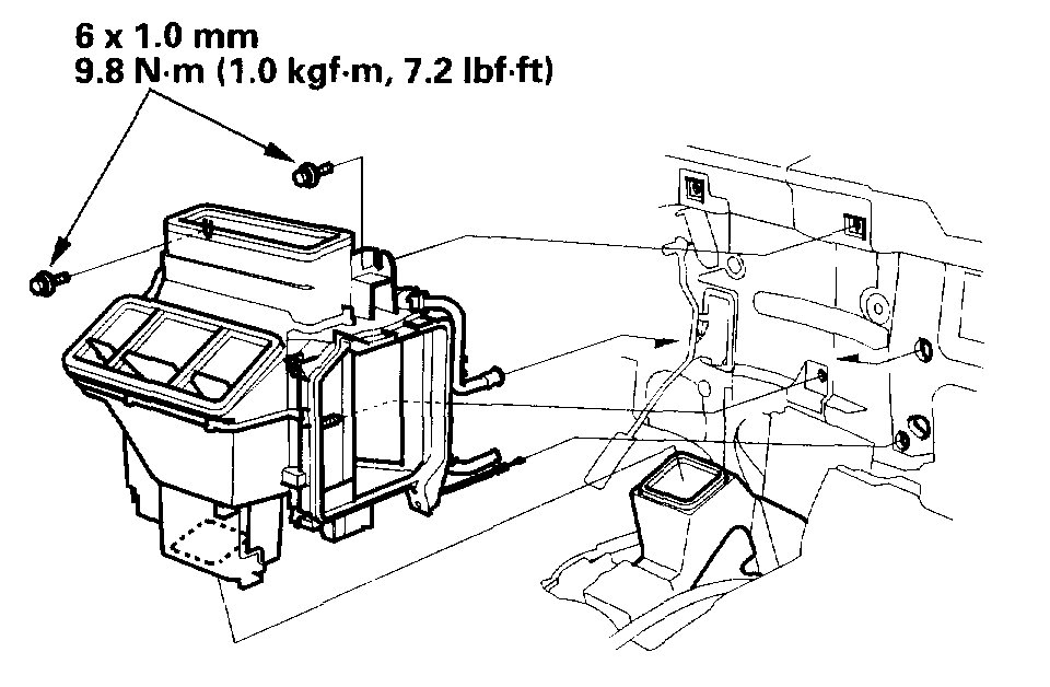

6. Remove the mounting nut from the heater unit. Take care not to damage or bend the fuel lines and the brake lines, etc.
7. Remove the dashboard.

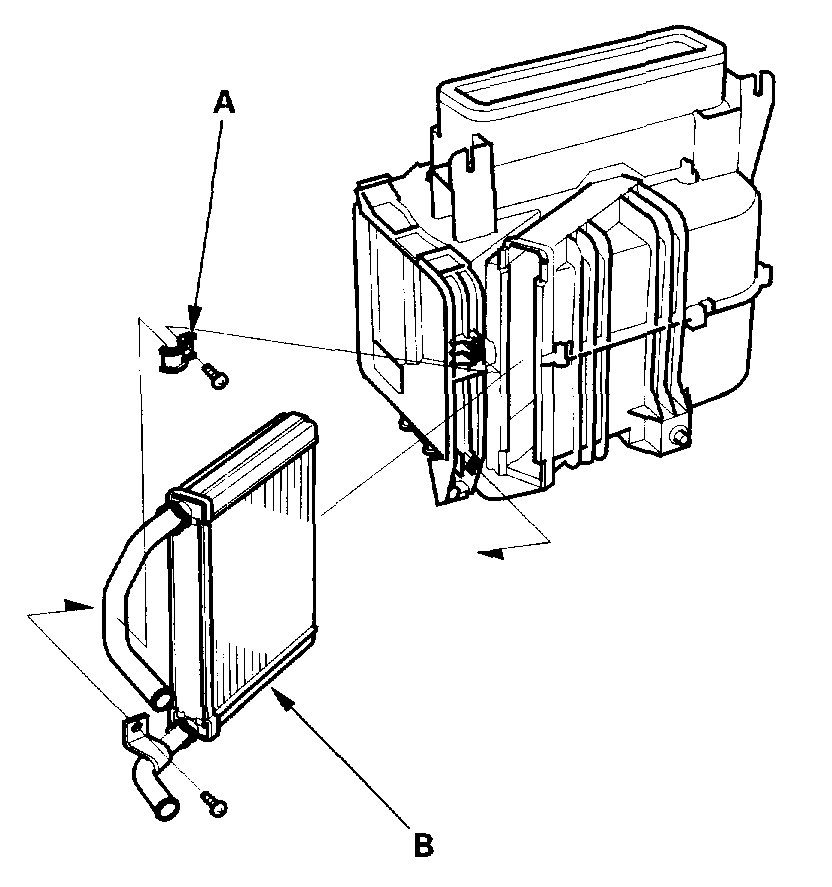

9. Remove the mounting bolts and the heater unit.
pic 5
10. Remove the self-tapping screws and the clamp (A), then carefully pull out the heater core (B) so you don't bend the inlet and outlet pipes.
