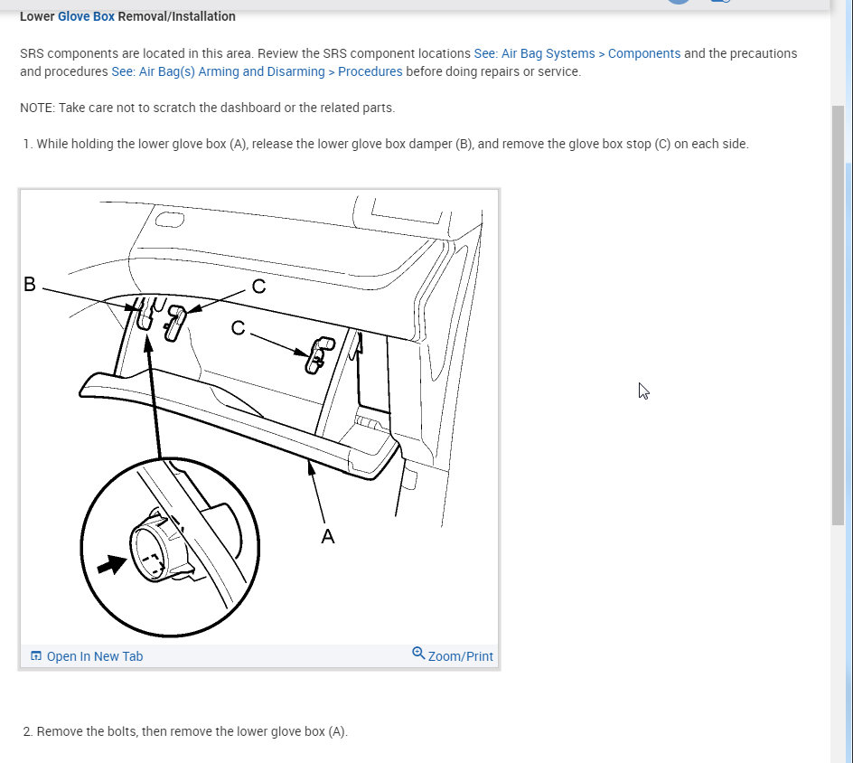

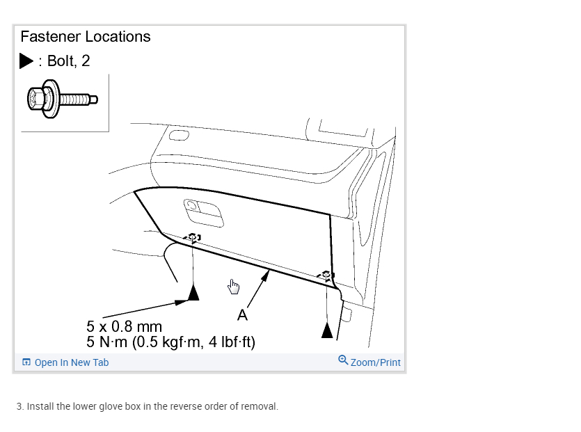

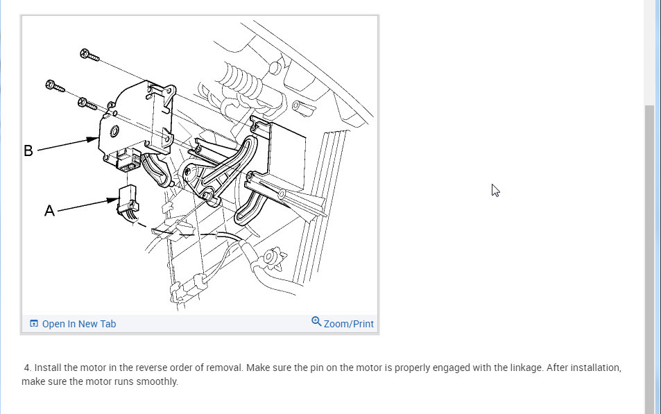

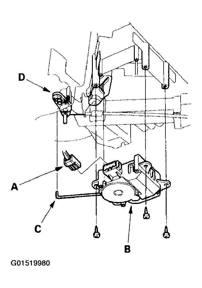

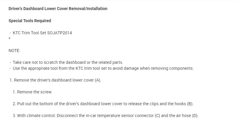

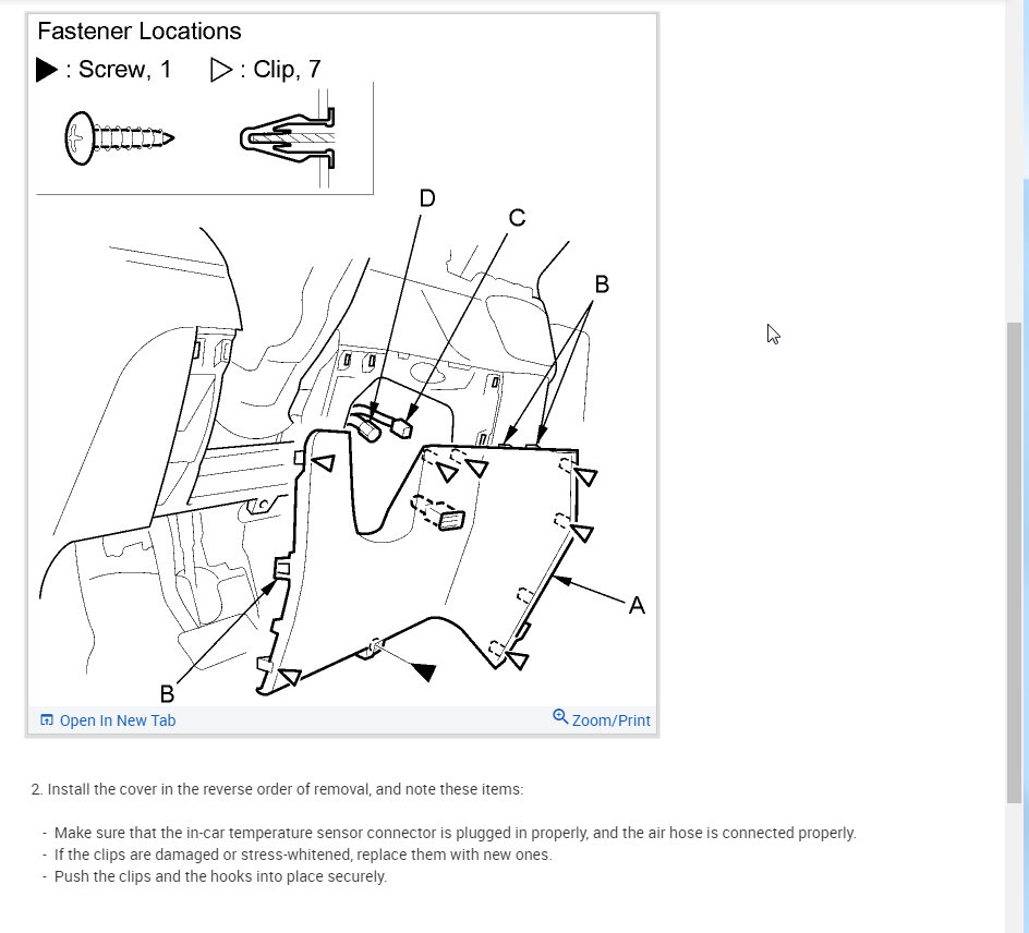

Air coming from vents is very cold, coolant is full, temperature needle in middle where it should.
Nov 10, 2019 at 11:15 PM

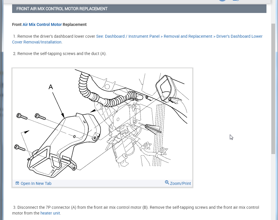

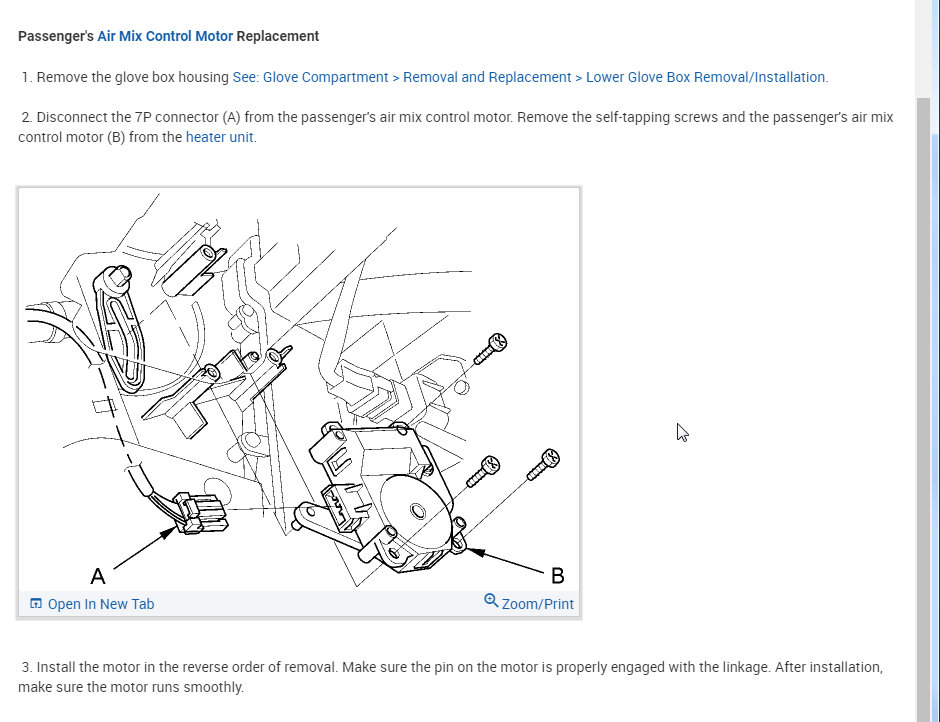

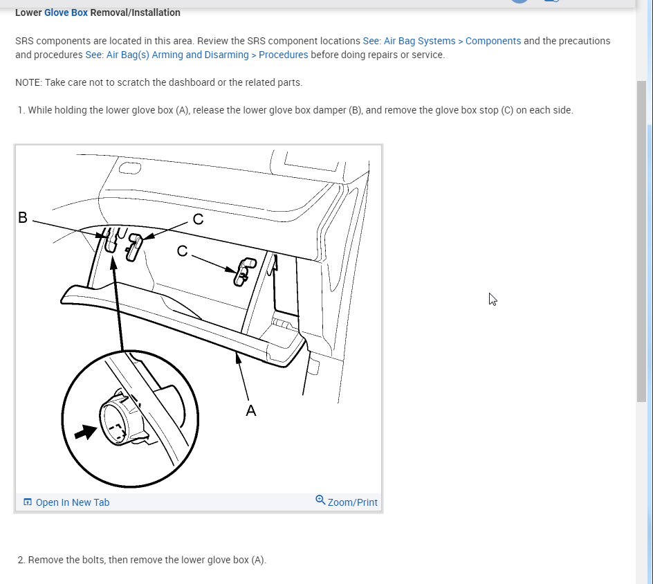

This sounds like the blend door is not allowing the air to go over the heater core. There is a chance that the heater core is plugged but I would suspect the actuator first.
I attached the process on how to replace the front and rear one as you did not say if it was all vents or just the front or rear.
Let me know if you have questions.

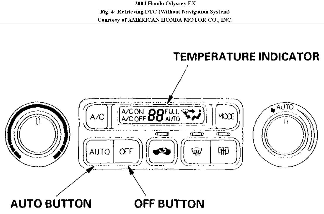

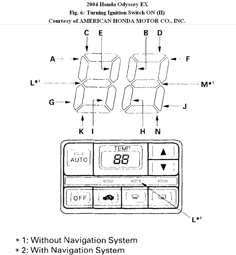

Here is more information I found that will help
HOW TO RETRIEVE A DIAGNOSTIC TROUBLE CODES
The climate control unit has a self-diagnosis function. To run the self-diagnosis function, do the following:
1 Turn the Ignition switch ON (II).
2. Press the AUTO button and then press the OFF button. Continue to hold both buttons down for 1 minute.
If there is any abnormality in the system the temperature Indicator will light up the segment (A through N) corresponding to the error. The temperature indicator will then alternate every second between displaying "88" (all segments lit) and the error code segment (A through N).
NOTE:
The system will only display the DTC when the AUTO and OFF buttons are pressed if you release the buttons the display will go blank. To return the display, simply press the AUTO then the OFF buttons again.
To determine the meaning of the DTC, refer to the DTC Troubleshooting Index . If there is no abnormality the segment will not light up.
Cancelling the Self-diagnosis Function
3. Turn the ignition switch OFF to cancel the self-diagnosis function. After completing repair work run the self-diagnosis function again to make sure that there are no other malfunctions.
(Check the diagrams below)

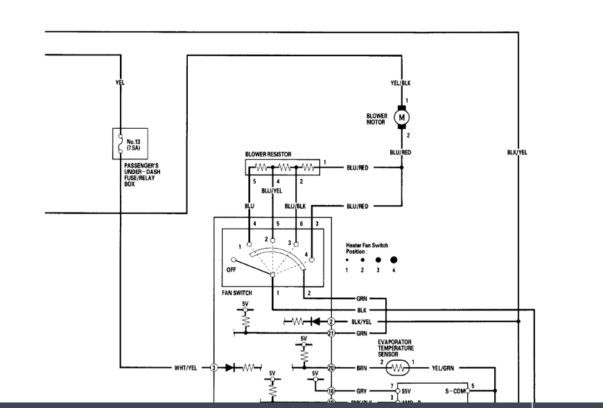

Heater not working, no heat at all and fan not working. I hear a click when I turn the blower on. It is coming from under the glove compartment.

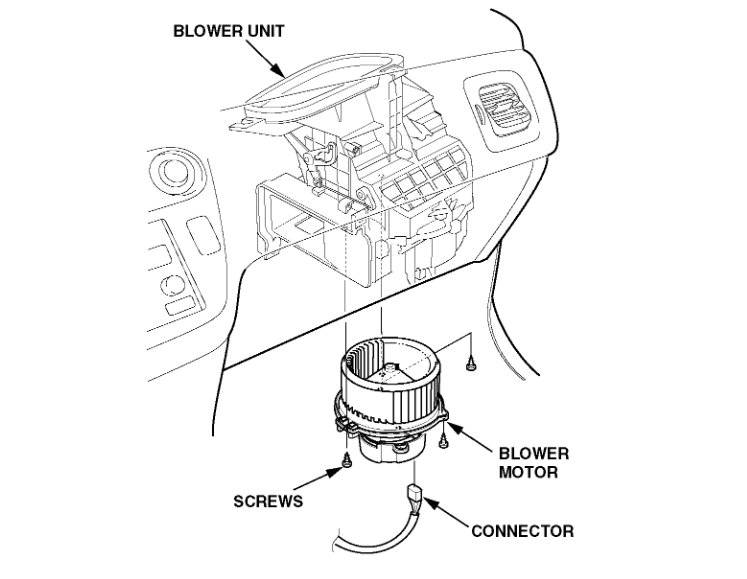

Good evening,
It may be the blower motor that may be the issue.
I will attach a wire diagram for you to view. You can check for power to the blower motor. It is a very common failure.
https://www.2carpros.com/articles/low-or-no-air-flow-from-vents
Service and Repair
1. Remove the right front door sill, the door opening trim, and the kick panel; pull the carpet aside.
2. Disconnect the connector from the blower motor.
3. Remove the three screws that secure the blower motor to the blower unit; remove the blower motor.

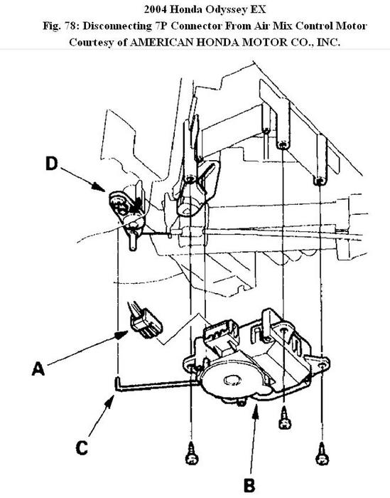

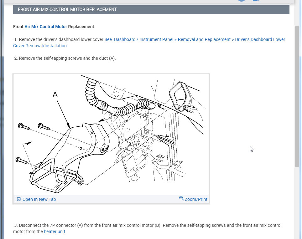

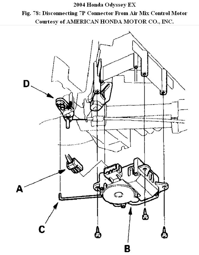

Yes, the control panle controls the air flow and if it is faulty, the air mix motor would not movde the blend doors to the correct position.
Remove the air mix motor and manually move the blend door linkages to the heater position to test if the heater works.
When you said no heat, it it blowing cold air as if the A/c Is being operated instead of the heater or there is insufficient heat?

Check the heater hoses leading to the core. Both should feel hot to the touch with a warm engine. They connect to a control valve that opens/closes to allow coolant through. If it is bad you get no heat. If both are warm and the valve opens, then it is likely to be the air mix door or it is actuator that are faulty and not directing the air through the heater core.
The air mix door and motor are under the heater plenum toward the floor in the passenger foot well. You can watch it as you select hot/cold. If the linkage is moving but no heat it is probably a bad door, if the linkage is not moving it is a bad motor.

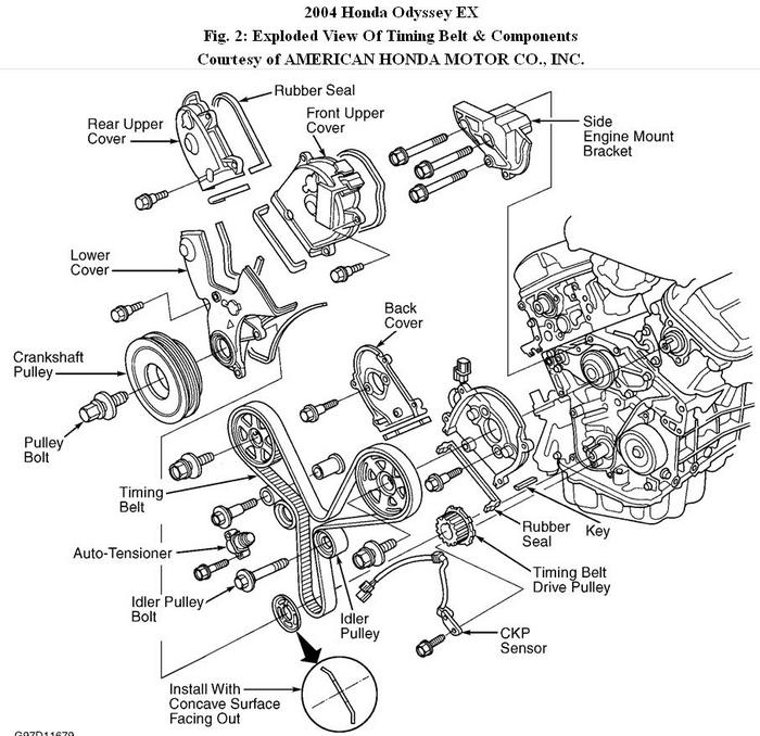

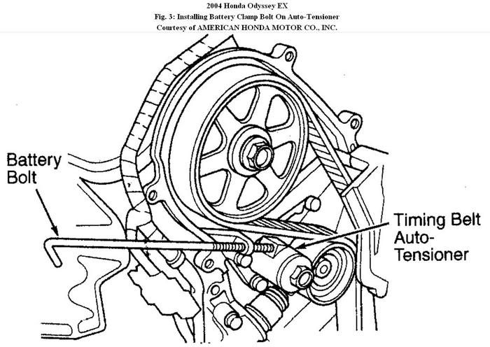

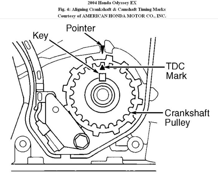

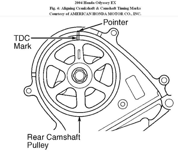

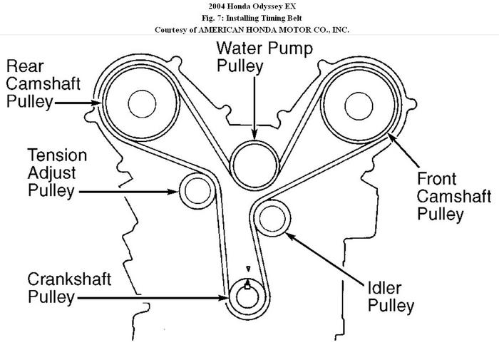

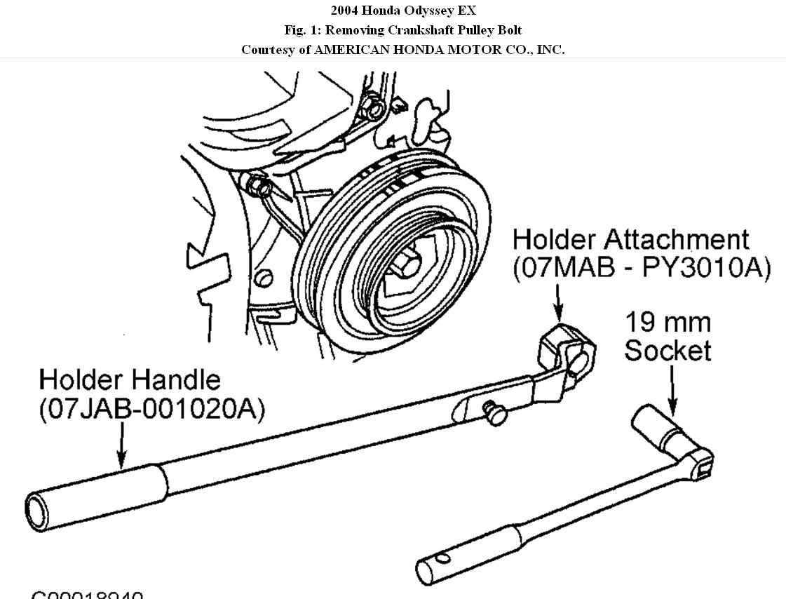

Here is a guide for what you are in for when doing the job less the timing belt.
https://www.2carpros.com/articles/water-pump-replacement
TIMING BELT
Removal

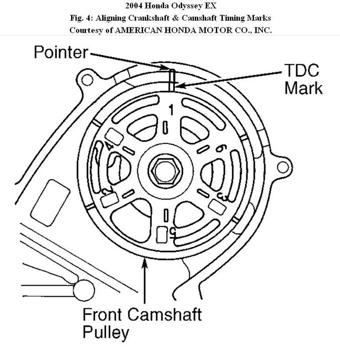

1. Disconnect negative battery cable. Turn crankshaft pulley so that No. 1 piston is at TDC on compression stroke. White mark on crankshaft pulley should align with pointer on front cover. Remove right front wheel. Remove lower engine splash shield. Move auto-tensioner to relieve tension, then remove the generator and power steering pump drive belt(s).
2. Support engine with a jack and wood block under the oil pan. Remove ground cable (if necessary), then remove engine side mount bracket. If necessary, remove dipstick tube from front of engine (discard "O" ring). Remove crankshaft pulley. See Fig. 1. ( A high toruqe impact wrench works but at times it might be rather stiff.
3.Remove upper and lower timing belt covers. See Fig. 2. If reusing timing belt, mark direction of belt rotation for installation reference.
4. Remove one of the battery clamp bolts from battery tray. Grind threaded end of bolt to a partial point (about 45-degree chamfer). Thread battery bolt as shown to hold timing belt adjuster in installed position (hand tighten ONLY). See Fig. 3.
5. If applicable, remove timing belt guide plate from front of crankshaft sprocket. Remove engine mount bracket from front of engine.
6. Remove idler pulley bolt and idler pulley, then remove timing belt.
Installation (New Belt)
1. Ensure that engine is at TDC. Align dimple on timing belt drive pulley with pointer on oil pump. See Fig. 4. Align camshaft pulleys with pointers on back covers.

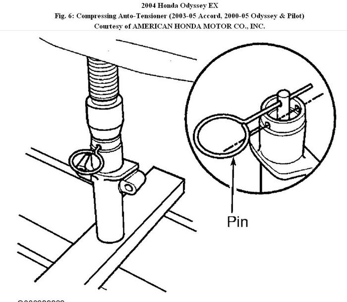

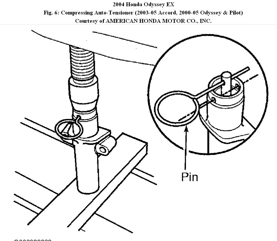

2. Remove battery clamp bolt from back cover. Remove the timing belt auto-tensioner.
NOTE:
When compressing sealed auto-tensioners, compression pressure should not exceed 2200 lbs. (9800 N).
3. Place sealed auto-tensioner in press. SLOWLY compress tensioner until pin can be inserted through tensioner body, and insert pin. See
Fig. 6. Install auto-tensioner onto engine.
4. Install battery clamp bolt into back cover. Apply liquid thread lock to idler pulley bolt and loosely install idler pulley.
5. Install timing belt in counterclockwise direction in the following sequence:
Crankshaft pulley, idler pulley, front camshaft pulley, water pump pulley, rear camshaft pulley and tension adjust pulley. See Fig. 7. Ensure crankshaft and camshaft pulleys remained aligned with marks on back cover. Tighten idler pulley bolt to specification.
6. Remove stopper or pin from auto-tensioner. Remove battery clamp bolt from back cover, if necessary. Install engine mount bracket to the front of engine. If applicable, install timing belt guide plate with concave surface facing out. Install lower cover, then upper front and rear covers. Clean, then install crankshaft pulley. Lubricate crankshaft pulley bolt threads and install bolt. Tighten crankshaft pulley bolt to specification.
7. Rotate crankshaft about 5-6 turns clockwise to position timing belt on pulleys. Ensure crankshaft and camshaft pulleys are aligned at TDC. Crankshaft pulley White mark should be aligned with pointer on front cover. Remove rubber plugs from upper covers to check camshaft pulley positions.
8. If either camshaft is not at TDC, remove timing belt and readjust position. To complete installation, reverse removal procedure. Tighten all fasteners to specification. Adjust drive belts to proper tension.

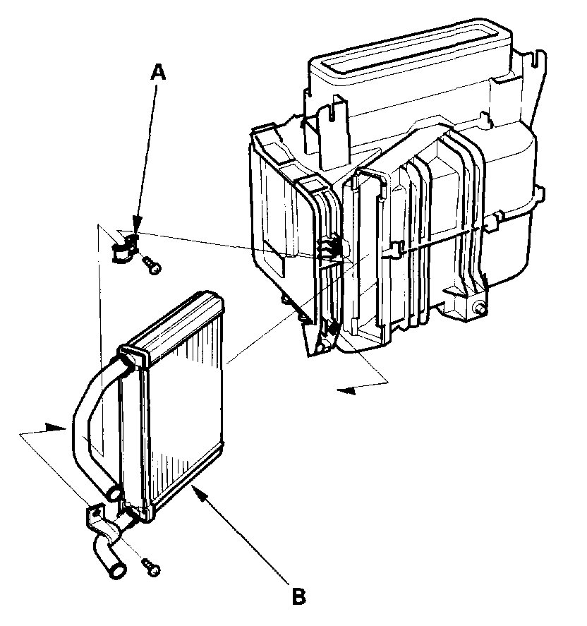

I have checked the DTC code and it says there is an error K air blend motor, door. I have checked the air blend motor on the drivers side and it is functioning. I checked the motor on the passenger and it is opening the heater hose valve. I checked the radiator fluid and it is at the proper level. I have checked the fuses and they are working. Thermostat is functioning as normal. Can you suggest something that I am missing?
Dec 14, 2020 at 11:52 AM (Merged)
  • 110,241 POSTS
It sounds like you have checked nearly everything. If the blend air doors are working, the coolant if full, and the engine is at normal operating temperature, the next thing I would suspect is the heater core is plugged.
Take a look through this link and see if it helps.:
Do me a favor. Start the engine, turn the heater on high, and allow the engine to reach operating temperature. Next, feel both heater core hoses. Both should be hot. If they are, then the problem is in the vehicle (likely blend air door). 4
If only one is hot, then the core is likely plugged. Here is a link that shows in general how one is replaced:
https://www.2carpros.com/articles/replace-heater-core

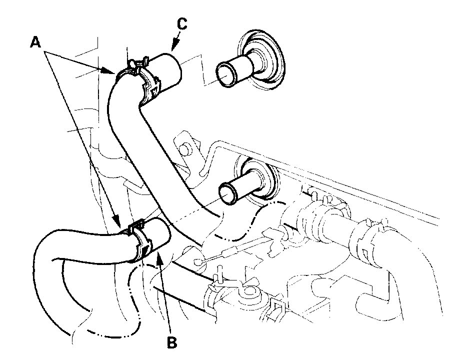

Here are the directions specific to your vehicle. The directions below correlate with the directions.
____________________________________
2004 Honda Truck Odyssey V6-3.5L
Heater Unit/Core
Vehicle Heating and Air Conditioning Heater Core Case Service and Repair Procedures Heater Unit/Core
HEATER UNIT/CORE
Heater Unit/Core Replacement
SRS components are located in this area. Review the SRS component locations, precautions, and procedures in the SRS section before performing repairs or service.
1. Make sure you have the anti-theft code for the radio and the navigation system, then write down the frequencies for the radio's preset buttons.
2. Disconnect the negative cable from the battery.
pic 1

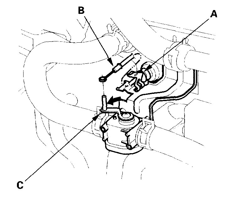

3. From under the hood, open the cable clamp (A), then disconnect the heater valve cable (B) from the heater valve arm (C). Turn the healer valve arm to the fully opened position as shown.
4. When the engine is cool, drain the engine coolant from the radiator.
pic 2
5. Slide the hose clamps (A) back, then disconnect the inlet heater hose (B) and the outlet heater hose (C) from the heater unit. Engine coolant will run out when the hoses are disconnected; drain it into a clean drip pan. Be sure not to let coolant spill on the electrical parts or the painted surfaces. If any coolant spills, rinse it off immediately.

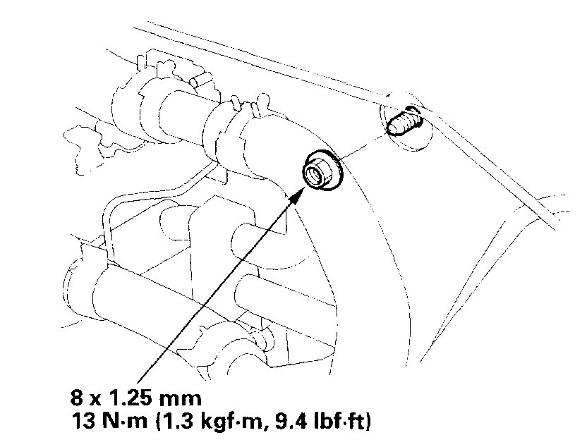

pic 3
6. Remove the mounting nut from the heater unit. Take care not to damage or bend the fuel lines and the brake lines, etc.
7. Remove the dashboard.
8. Remove the evaporator.

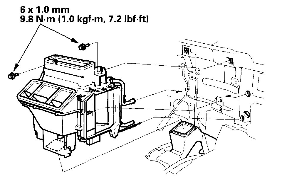

pic 4
9. Remove the mounting bolts and the heater unit.
pic 5
10. Remove the self-tapping screws and the clamp (A), then carefully pull out the heater core (B) so you don't bend the inlet and outlet pipes.
11. Install the heater core in the reverse order of removal.
12. Install the heater unit in the reverse order of removal, and note these items:
- Do not interchange the inlet and outlet heater hoses, and install the hose clamps securely.

- Enter the anti-theft code for the radio and the navigation system, then enter the customer's radio station presets.
