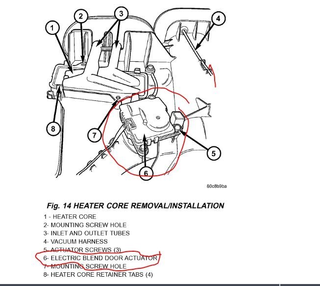

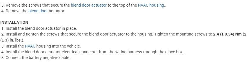

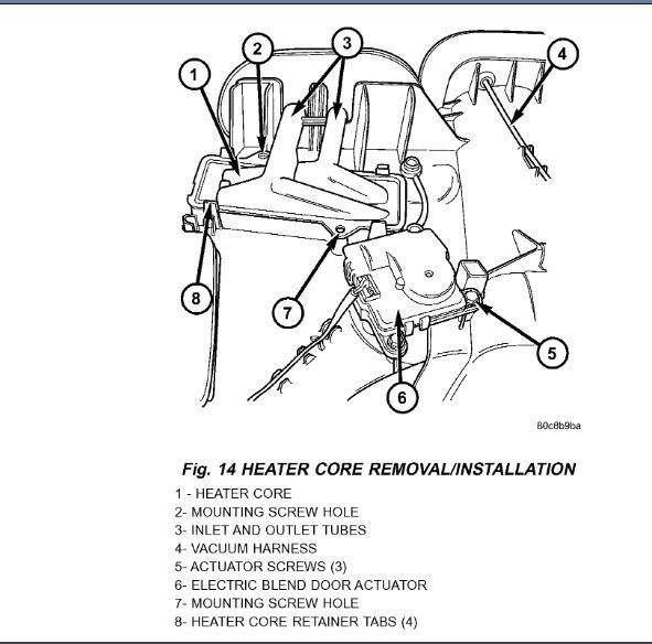

This points directly at the heater core as the failure.
You have hot hoses and heat above idle. You have a clog in the core that slows the circulation.
WARNING:
- ON VEHICLES EQUIPPED WITH AIRBAGS, DISABLE THE AIRBAG SYSTEM BEFORE ATTEMPTING ANY STEERING WHEEL, STEERING COLUMN, OR INSTRUMENT PANEL COMPONENT DIAGNOSIS OR SERVICE. DISCONNECT AND ISOLATE THE BATTERY NEGATIVE (GROUND) CABLE, THEN WAIT TWO MINUTES FOR THE AIRBAG SYSTEM CAPACITOR TO DISCHARGE BEFORE PERFORMING FURTHER DIAGNOSIS OR SERVICE. THIS IS THE ONLY SURE WAY TO DISABLE THE AIRBAG SYSTEM. FAILURE TO TAKE THE PROPER PRECAUTIONS COULD RESULT IN AN ACCIDENTAL AIRBAG DEPLOYMENT AND POSSIBLE PERSONAL INJURY.
- IF THE VEHICLE IS EQUIPPED WITH AIR CONDITIONING, REVIEW THE WARNINGS AND CAUTIONS IN THE FRONT OF THIS SECTION BEFORE PERFORMING THE FOLLOWING OPERATION. See: Heating and Air Conditioning > Technician Safety Information
1. Remove the HVAC housing. Refer to Housing Assembly HVAC/Service and Repair/Procedures See: Housing Assembly HVAC > Removal and Replacement > HVAC Housing - Removal and Installation
Fig.14 Heater Core Removal/Installation
2. Remove the two heater core retaining screws (if equipped)..
3. Gently push back on two of the heater core retaining tabs and pull up on heater core to remove.
INSTALLATION
WARNING: IF THE VEHICLE IS EQUIPPED WITH AIR CONDITIONING, REVIEW THE WARNINGS AND CAUTIONS IN THE FRONT OF THIS SECTION BEFORE PERFORMING THE FOLLOWING OPERATION. See: Heating and Air Conditioning > Technician Safety Information
1. Install the heater core into the top of the HVAC housing.
2. Push on top of heater core until all for tabs are locked into place.
3. Install the two heater core retainer screws.
4. Install the HVAC housing. Refer to Housing Assembly HVAC/Service and Repair/Procedures
Sep 21, 2020 at 3:14 AM

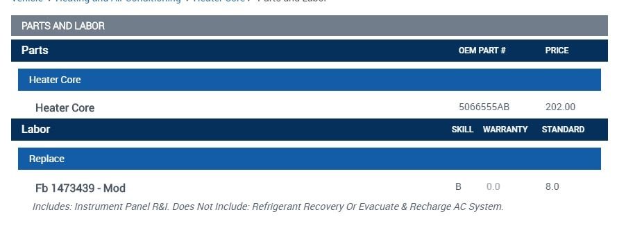

I have never used any product that breaks up clogs from rust. You could try doing it again with shop air and a garden hose. I think I would give it a second shot before pulling the trigger on a heater core. These are a pain to replace. I have bad memories doing these.

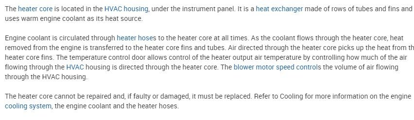

Okay, if both hoses are hot, the blend door is working back and forth, the only thing left is the core itself.
https://www.2carpros.com/articles/replace-heater-core
https://www.youtube.com/watch?v=-xnM-K5A3ow

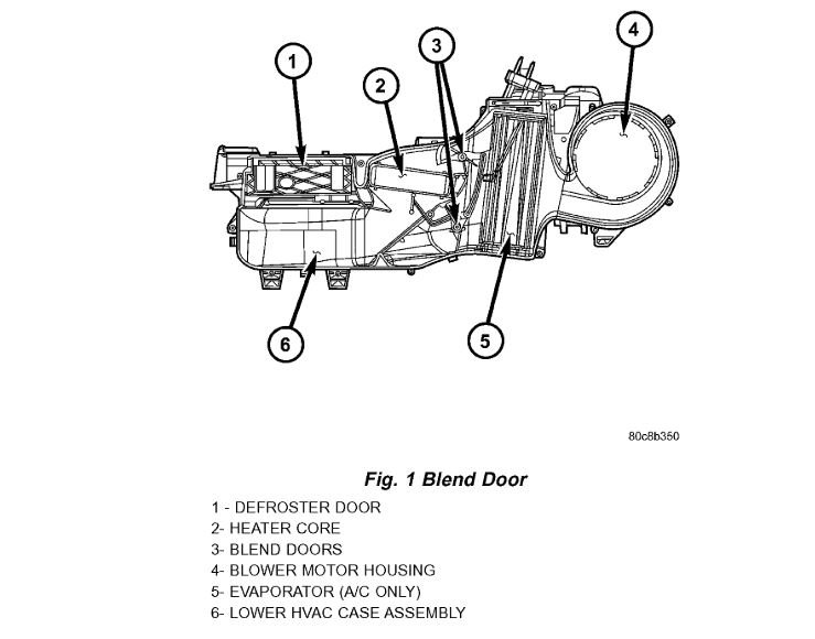

There is no heater control valve in the hoses as in the older days. The heat control is handled by an actuator or door that allows heat or shuts it off.

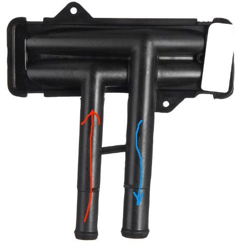

Heater was over to max on the control dial some heat not much. had heater core flushed out twice. no overheating. light does not come on when car starts. the thermostat goes to the middle of the gauge and stays there. Have pulled out the glove box door and listened to hear if the bend door actuator is working and it does. Does my vehicle have a heat control valve on it? the shop that was working on it is stumped as to what is going on. Should I have the thermostat valve replaced anyway?
Jan 21, 2021 at 3:04 AM (Merged)
MARILYN MILLER
Top hose running hot. the bottom hose is running cold that runs to the heater core.
STEVE W.
  • 15,295 POSTS

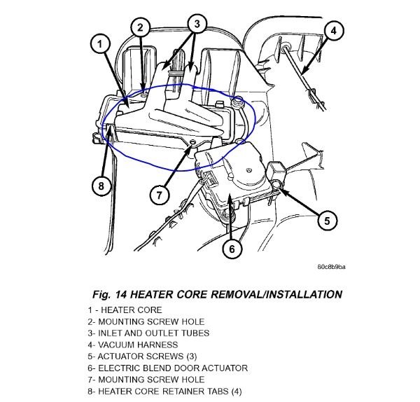

Sounds like the core is plugged. The Liberty uses a parallel flow design instead of the older single loop. When you flush them you could be pushing water through two of the paths but the rest are blocked. The picture shows the coolant flow and how flushing doesn't really work on that style core.
