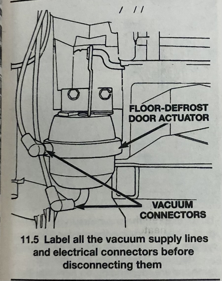

Trying to change things in order of cost/simplicity. It was overdue for flush/fill, so I did that first, hoping that anything clogging the system would get flushed. I replaced the thermostat/housing next. Still no dice. I was going to change the Blend Door Mechanism (Haynes Manual calls it the "Floor-Defrost Door Actuator), but I cannot find the part anywhere online: RockAuto, usual parts stores, Amazon, etc. I have not pulled the lower dash yet, to see if there is more than one actuator, but one online source said--given the year/make/model--there is typically only one. Again, finding that one has been a challenge.

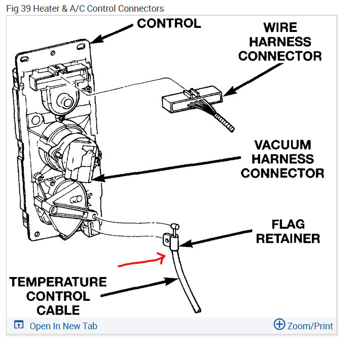

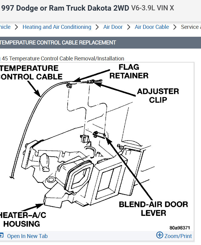

There is no temperature blend door actuator, there is a control cable what may have gotten loose or broken, here is the location so you can check it out. Check out the images (below). Please let us know what happens.

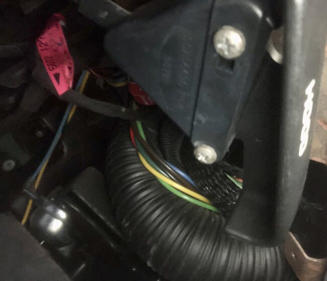

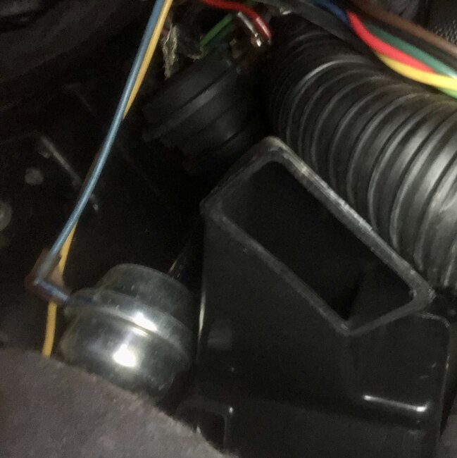

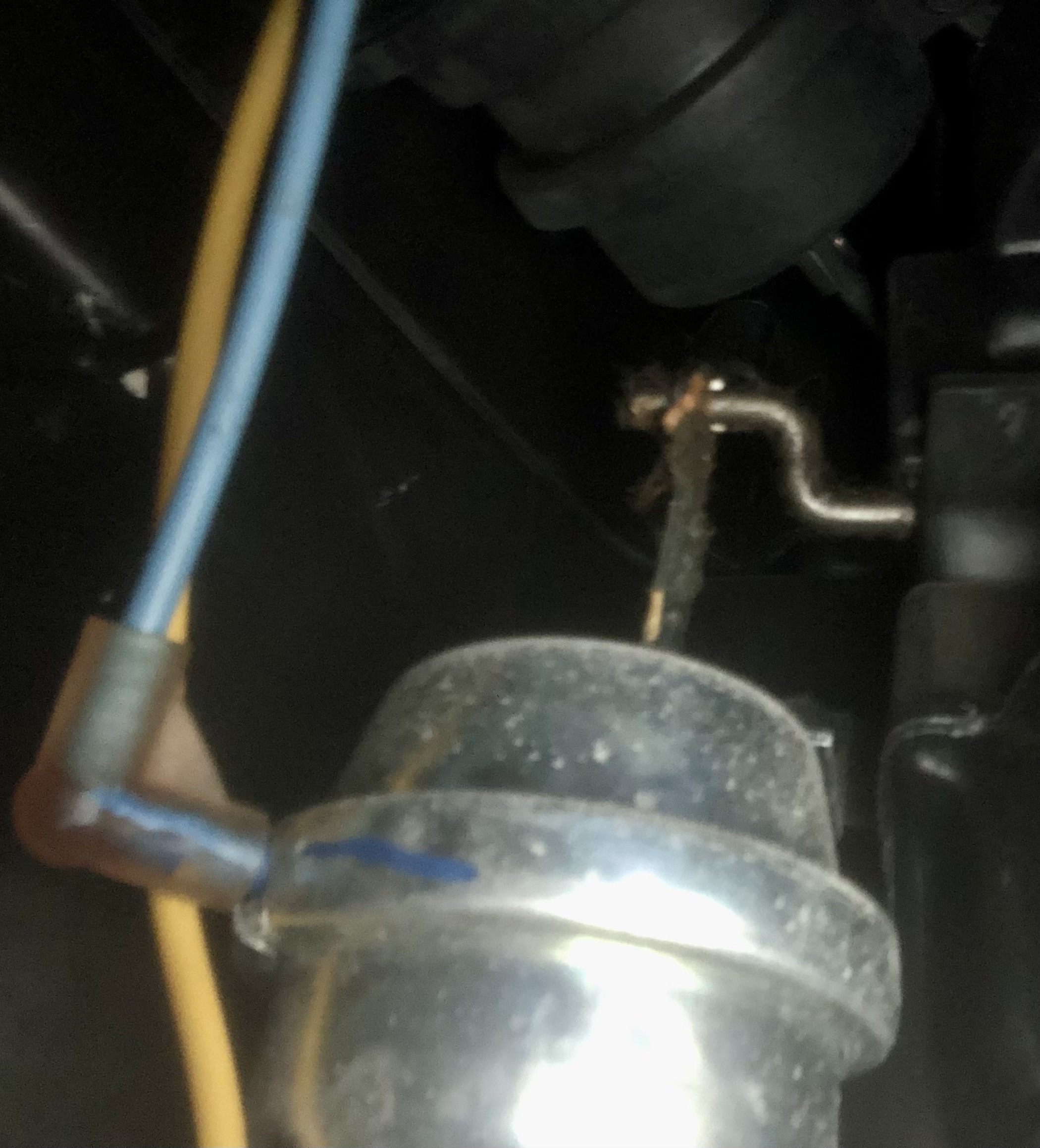

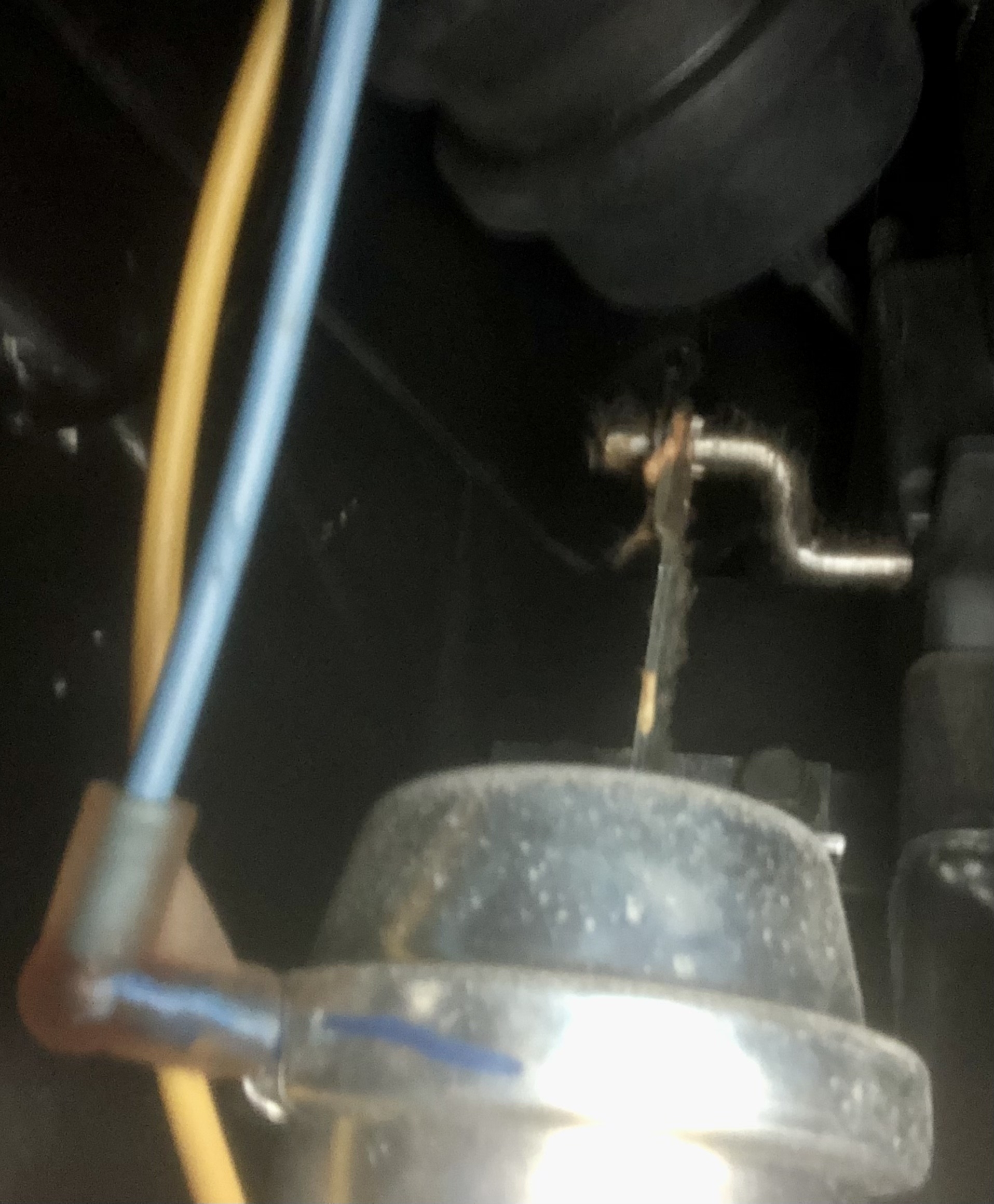

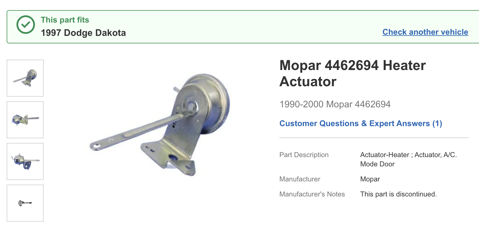

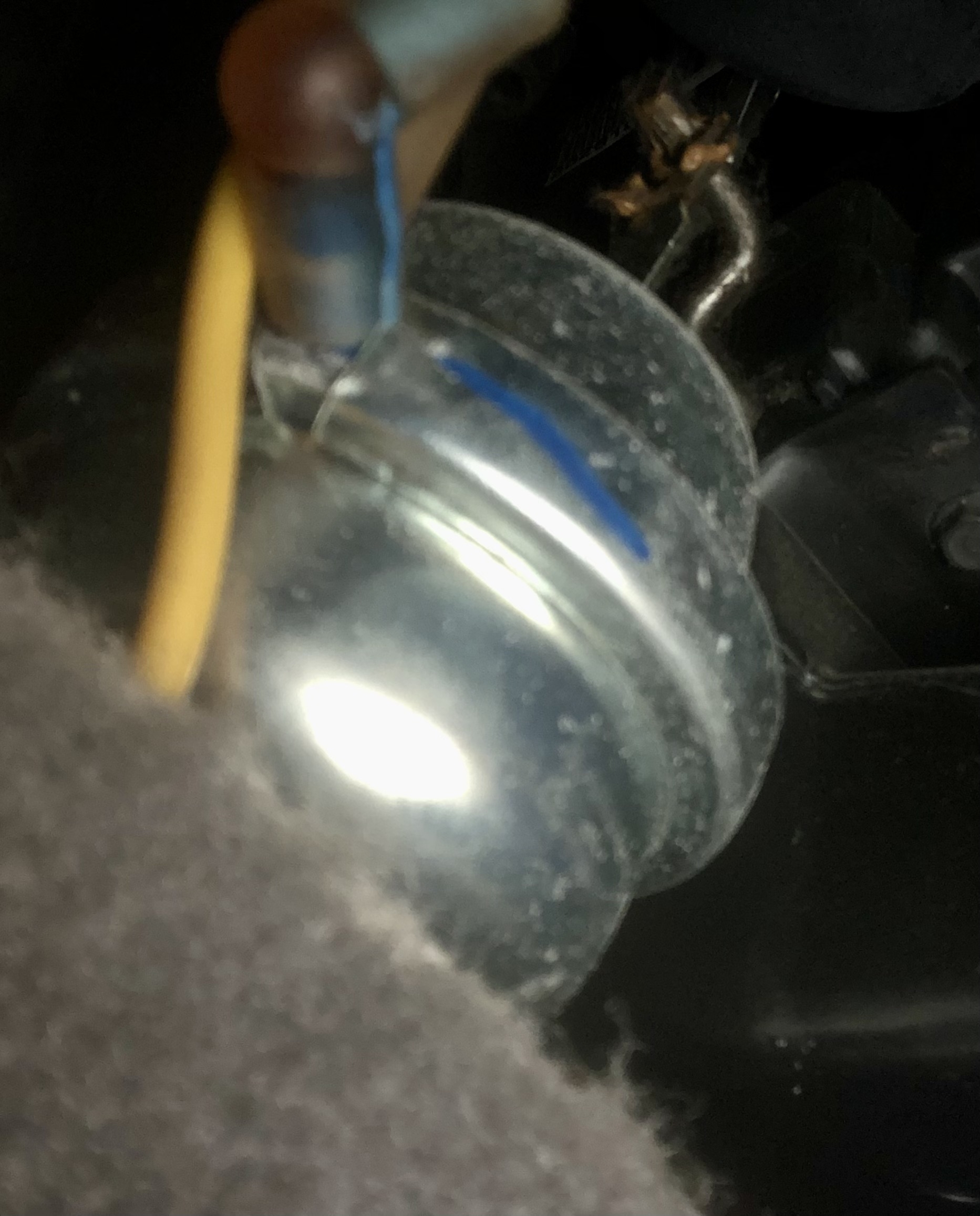

In the meantime, here are some photos of my own. One is from my Haynes Manual; another is a screenshot of the part from Mopar; the rest are from the underside of my dash (note the silver metallic part that matches the manual and the Mopar part). Are you saying that this part is not an actuator?
From the looks of your images, the Temperature Control Cable might originate at the top of the part that I have pictured. I have no idea what the guts of the Floor-Defrost Door Actuator looks like, but I wonder if what is inside is mechanical and has somehow failed.

Yes, that is the actuator for the mode operation, the temperature door is controlled by a cable. Does the engine overheat? The lower hose will be cooler than the top hose but not cold. You may have a water pump issue not circulating the coolant, but the engine should overheat if this was true, can I ask if both heater hoses are hot?

As for the actuator, when I switch from defrost to vent to floor, the air successfully blows through the desired openings. It is curious to me, however, that the air coming out of those openings differs in temperature. The warmest setting is defrost, the second warmest is floor; the vent blows cold air. Odd.

Good morning, Ken. I tried the trick to burp the heater core. It didn't work. I watched the fluid carefully the whole time--no air bubbles when I turned on the heat, when I adjusted the blower fan, when I accelerated, when I raised the front of the truck, or when I raised the back--I mean, I watched as best I could from the rear position and in between pushes on the jack's lever. More notably, there is no difference in the vehicle's performance.
I guess I'll have to check that cable next. Could I ask you where you got those pictures? The one in which you drew the red arrow is exactly like a pic from my Haynes manual, but the other one I cannot find in my manual. From the looks of it, I'm going to have to take apart the whole stinkin' dashboard in order to get to that cable, so if there's another resource out there with some additional pics and information, I'd love to have access to it.

With the truck off, you should be able to work the temperature controls and hear the door working.

Yes, I can hear movement when the truck is off. When it is on, the airflow goes through the proper path, according to the mode-selector.

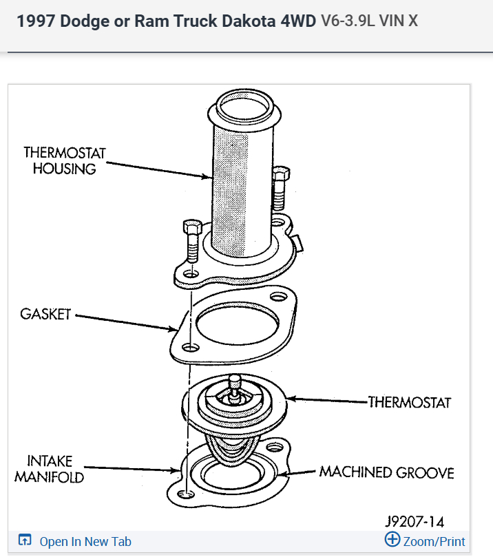

It seems like the cooling system does not have a thermostat, to be clear this is what you replaced, correct? Check out the images (below).
Feb 25, 2025 at 1:53 AM
TRAVBARRETT73
  • 14 POSTS
The truck most definitely has a thermostat. Yes, I replaced both the thermostat itself, along with the housing (because doing the latter seemed easier than trying to scrape the old gasket off the existing one).
