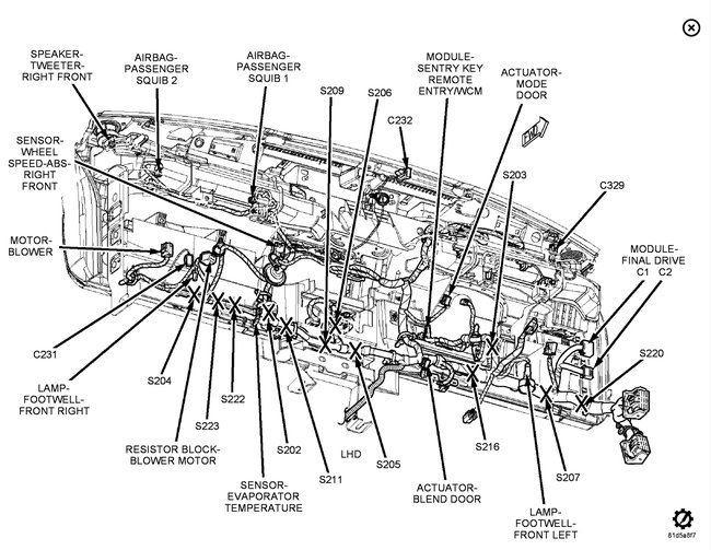

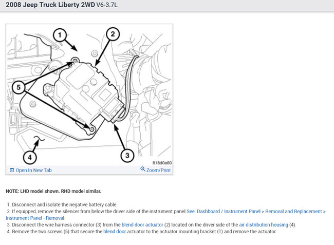

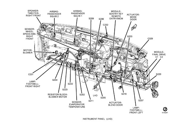

This sounds like a programmatic error which could be caused by a shorted blend door actuator I know you said you replaced some of them can I ask which ones?
Below is a diagrams to help us get on the same page.
Please let us know. I am interested to see what it is.
Nov 2, 2017 at 10:42 AM

  • 55,433 POSTS
I would replace the mode actuator which is on the passenger's side.

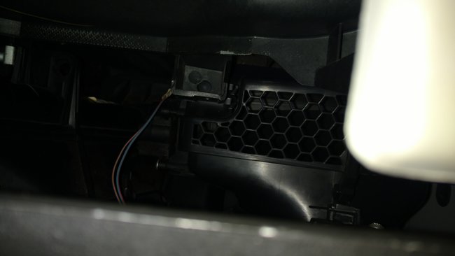

Ken, here is an image if what I think is the mode actuator. This is right above the blower motor which is working on the passenger side. I can see it through the glove box. Is this it? Thank you so much for the help.
Nov 3, 2017 at 9:06 AM
  • 55,433 POSTS
It is kind of hard to tell but it should be, It look like the same area the diagrams shows. When you remove the actuator manually move the door with the HVAC running that way you can tell which actuator does what.

Can you grab onto the heater hoses after the engine is warmed up you see if they are warm? Here is a guide to help. Can you check the coolant level as well?

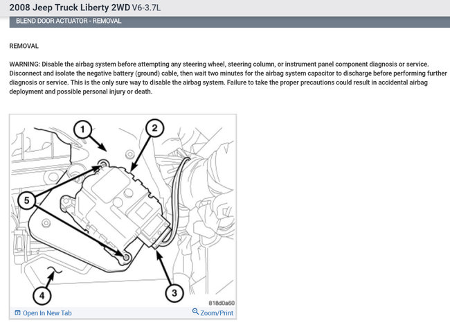

That could be. I would try to reset the system by removing the negative battery cable from the battery and holding it to the positive battery terminal for 5 minutes to discharge the system and let it relearn. If that doesn't work here is the reset guide from the manual.
Below
CAUTION: Do not exchange A/C Heater Controls from vehicle to vehicle. Software versions differ between models and model years. Installing an A/C Heater Control with software that is incompatible for a given vehicle can result in either improper or failed HVAC system operation.
A/C Cooldown Test
The A/C Cooldown Test:
is actuated with a scan tool.
tests A/C system performance based on evaporator temperature sensor input.
will fail if evaporator starting temperature is below 18°C (65°F) when initiating the test.
will pass if the evaporator temperature drops 11°C (20°F).
indicates test outcome by displaying one or more test status messages on the scan tool. These messages will clear after paging back out of this test function. Therefore, is it important to note all of the messages before doing so.
will cause the A/C status indicator to flash while the test is running.
Actuator Calibration Function
The Actuator Calibration function:
homes and repositions door actuators.
monitors for door span faults. Door span faults (XXX Door Travel Range Too Large or XXX Door Travel Range Too Small) will only display after calibration.
will cause the electric backlight (EBL) status indicator to flash while the test is running.

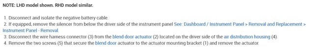

Ken, thanks for all the help. We now have heat. The top actuator on the driver's side that attaches to the blend door was out of calibration.

Ok here we go, my step grandpa and his son replaced the blend door. Still no heat. I flushed the heater core, replaced the thermostat, flushed the radiator and replaced the actuator on the passenger side above the blower. Still no heat. I then replaced the control panel and still no heat. My ex father in law looked at it while I was out of town and found the wires for the two actuators on the driver's side were crossed up. I guess when they replaced the blend door, they got the wires crossed. Wires were switched and now we have heat. Thanks for all the help.

heat at last finally heat at last! i had a feeling we still had air in the system, so we jacked the car up and bled the damn thing all day and night. you have to put the jeep on a tilt to get it all out. we did that before and it didn't work. i guess just didn't get it all the first time. it's working but really not sure how it keeps getting air in.

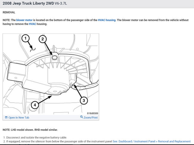

Okay, it sounds like the blower motor might be going out which is common. here is a guide to help test the motor and show you how to check the power and grounds. The heat will still be the actuator.
https://www.2carpros.com/articles/blower-fan-motor-works-on-high-speed-only

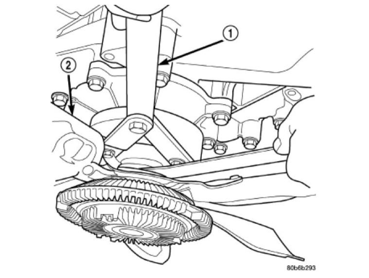

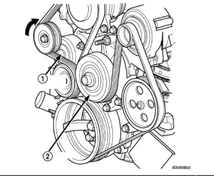

Good afternoon,
If you have no flow to the core, then you either have clogged hoses or a bad water pump.Was the coolant level topped off when you removed the hoses?
Does the car overheat?
1. Disconnect negative battery cable.
2. Drain cooling system See: Cooling System > Procedures > Cooling System - Standard Procedures.
3. If water pump is being replaced, do not unbolt fan blade assembly from thermal viscous fan drive.
4. Remove two fan shroud-to-radiator screws. Disconnect the coolant overflow hose.
5. Remove upper fan shroud and fan blade/viscous fan drive assembly from vehicle.
6. After removing fan blade/viscous fan drive assembly, do not place thermal viscous fan drive in horizontal position. If stored horizontally, silicone fluid in viscous fan drive could drain into its bearing assembly and contaminate lubricant.
7. Remove accessory drive belt (1) See: Drive Belt > Removal and Replacement > Accessory Drive Belt - Removal.
8. Remove lower radiator hose clamp and remove lower hose at water pump.
9. Remove seven water pump mounting bolts and one stud bolt.
CAUTION: Do not pry water pump at timing chain case/cover. The machined surfaces may be damaged resulting in leaks.
10. Remove water pump and gasket. Discard gasket.
