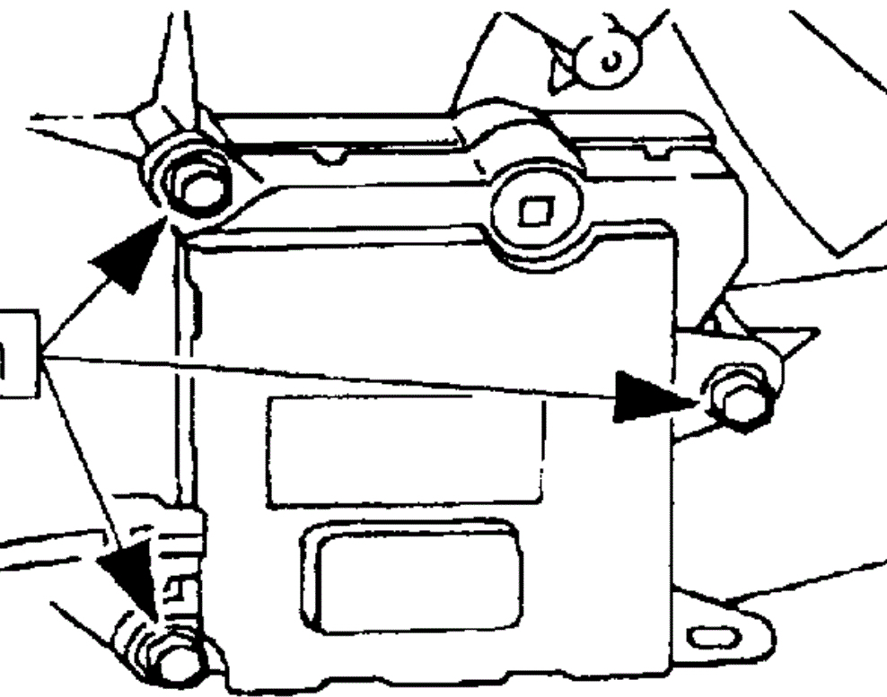

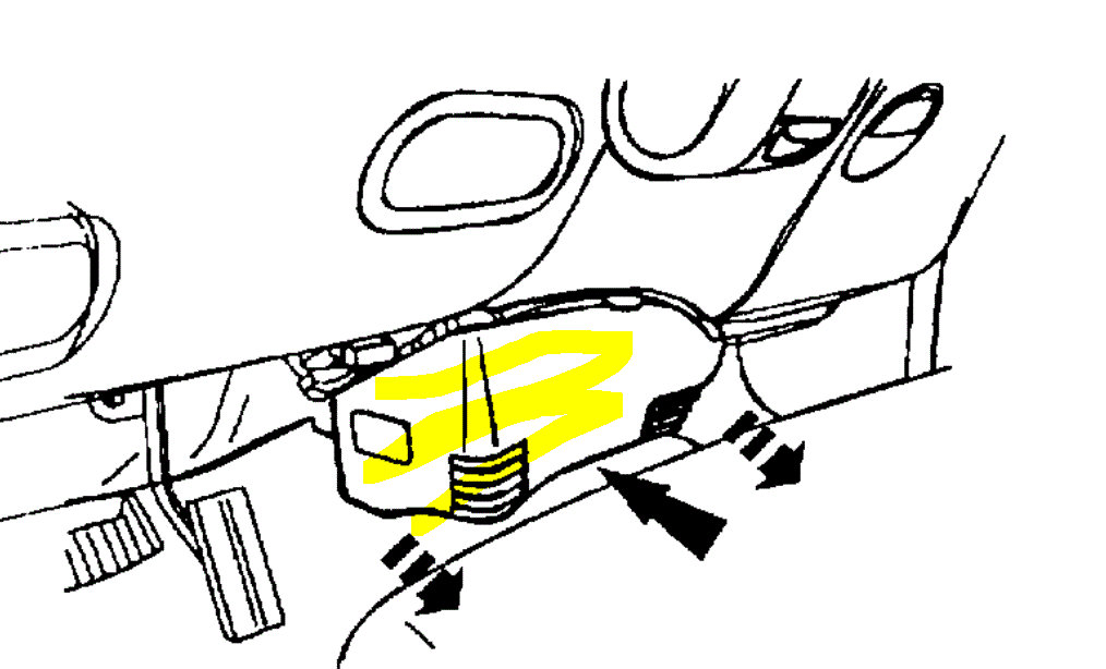

My truck has no heat. Blower motor works fine. I've flushed heater core, flushed and changed coolant, changed thermostat, checked blend door and actuator. they are in working order. Burped system. Still no heat. Heater core is not leaking or showing any signs of wear or breakage. All hoses are good. And yet I still have no heat. Please help.

Also, take a look at pics 1 and 2 below. Is that the actuator you checked behind the floor duct panel? I ask because there are a few different actuators. Let me know how you checked it as well.
Take care and let me know what you find.

Neither hose is hot. I disconnected both hoses from heater core stuck hose in overflow reservoir and coolant came out of both hoses that are connected to engine. Checked blend door and actuator both are work as they should. I put hose in heater core itself and back flushed. Some rust and other stuff came out then eventually clear water came through. I have no heater control valve on this model year f150. Still no heat. I even tried reversing hoses. Still no heat.
