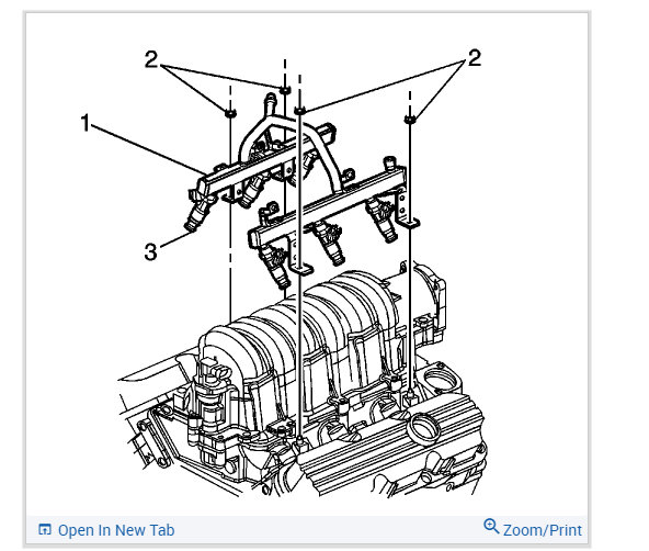

Fuel to rail but injectors and plugs are dry.
Nov 3, 2019 at 12:16 PM

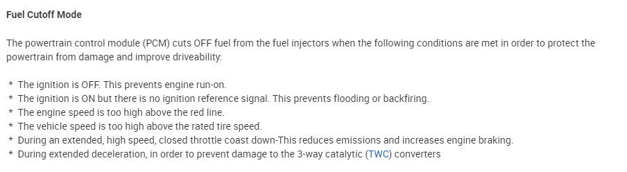

Okay. How do you know you are getting fuel to the rail? The only reason I ask is because the only thing that would make sense for this to happen is the PCM is not pulsing the injectors and is in cutoff mode.
The other possible cause is there was some fuel in the rail but the pump is just not supplying the proper amount of fuel which is why we need to know how you checked for fuel.
