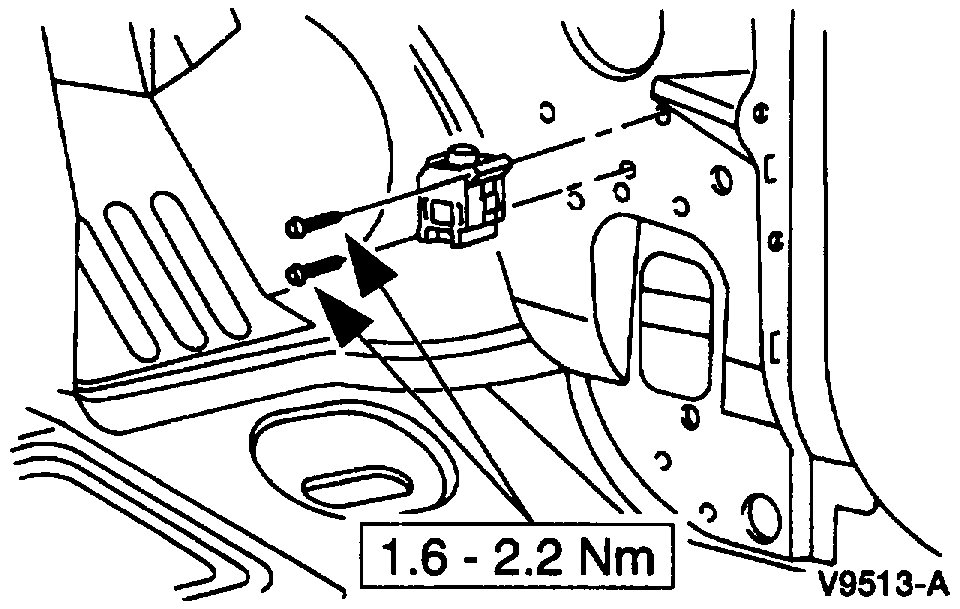

was running fine. All of a sudden it shut off and won't start. Very low pressure at fuel rail but pressure is there and getting no spark. Fusses are all good. No codes, i'm out of ideas.
Aug 5, 2020 at 12:52 PM
  • 110,248 POSTS

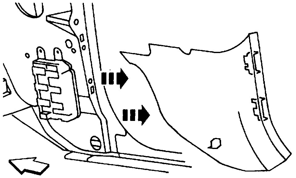

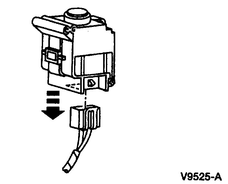

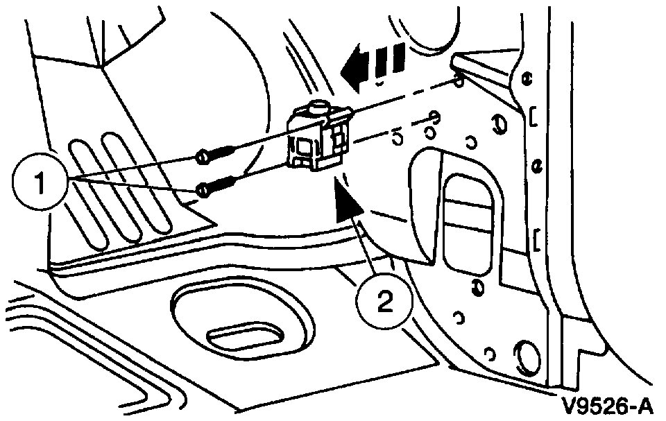

Since fuel pressure has been lost as well, lets start by resetting the inertia switch. It is designed to shut down the fuel system if there is an accident. Here are the directions for replacement. I'm providing them to help you locate it. There will be a reset switch to press. Just do that and not the removal process. Check out the diagrams (Below).
1. Disconnect the battery ground cable.
NOTE: When the battery is disconnected and reconnected, some abnormal drive symptoms may occur while the vehicle relearns its adaptive strategy. The vehicle may need to be driven 16 km (10 mi) or more to relearn the strategy.
2. Remove the RH cowl side trim panel.
3. Disconnect the inertia fuel shutoff switch electrical connector.
4. Remove the inertia fuel shutoff switch.
1 Remove inertia switch bolts.
2 Remove the inertia fuel shutoff switch.

Check out the diagrams (Below). Please let us know what you find. We are interested to see what it is.
