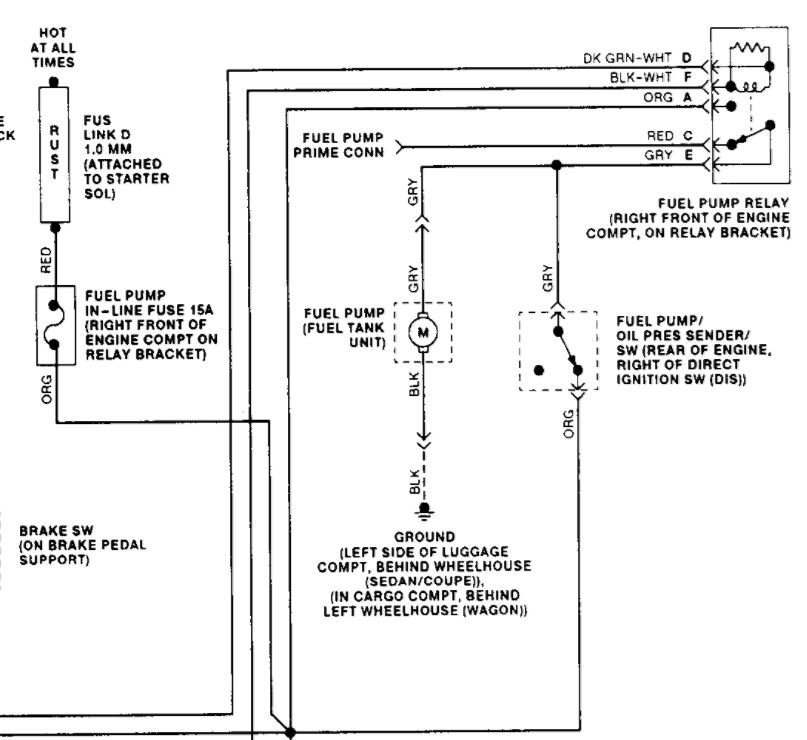

Yeah, that just about proves the fuel pump is not running. Check the fuel pump fuse and if it is okay, try a new fuel pump relay or swap one in if you have another of the same type.
both the fuse and the relay are on the relay bracket shown here.
I do see this has an oil pressure switch override, which means after cranking the engine over enough that the oil pressure builds up 4 psi, it should override the switch and power the fuel pump. If that wire is hot going to the fuel pump but it still does not run, check the fuel pump ground before condemning the fuel pump itself and begin draining the tank to replace the fuel pump.

I did read in one the other posts on here about a wire that i can connect to the positive battery post with a fused jumper wire to test the pump without all that other noise from turning the key. thoughts on this?
Apr 28, 2018 at 9:39 AM
PATENTED_REPAIR_PRO
  • 1,853 POSTS
I see a prime connector wire, a red wire coming off the fuel pump relay that you can jump twelve volts to in order to see if the fuel pump will run.

Well the deluge finally ended long enough for me to find out i cannot hear anything from my fuel tank when using the prime connector wire. Fuse is good, swapped the relay out with its twin 2ed in from the passenger front fender (same number). How loud sounding is this pump? I am a little hard of hearing but far from deaf. I could hear the pump in my Suburban easy and my Dodge cargo van both from the drivers seat? I am thinking maybe it is the pump after all. Would my tuneup have triggered this in some "electronic" way ? I am really beginning to miss my ole 1970 3/4 ton Chevrolet truck lol. One wire and fuel line, run forever.
Your thoughts fellas please.
Apr 29, 2018 at 9:48 AM
PATENTED_REPAIR_PRO
  • 1,853 POSTS
I do not think doing the tune-up did anything to the fuel pump. I think you should begin with a fuel pump replacement, but once you locate I believe it was the gray wire as close to the fuel pump, check it again there by either testing it for voltage or since you have no one to help you. just jump twelve volts to the wire and listen if the fuel pump runs then and if not still, check the ground wire and if okay, start to drain the tank for replacement of the fuel pump.
