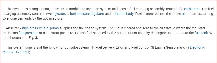

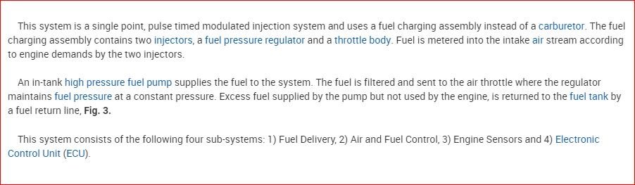

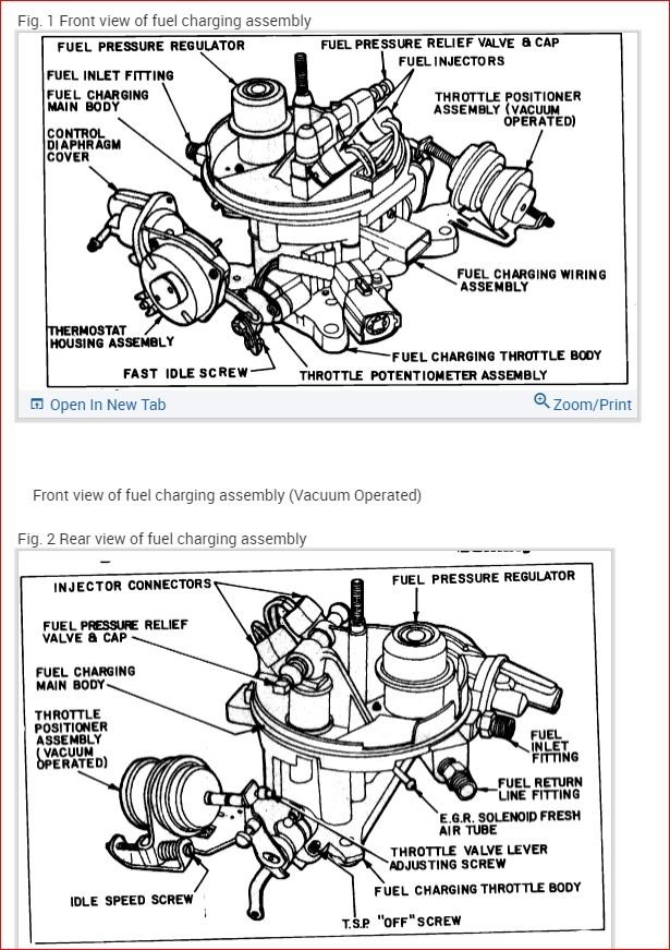

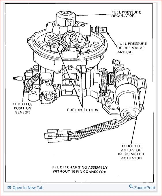

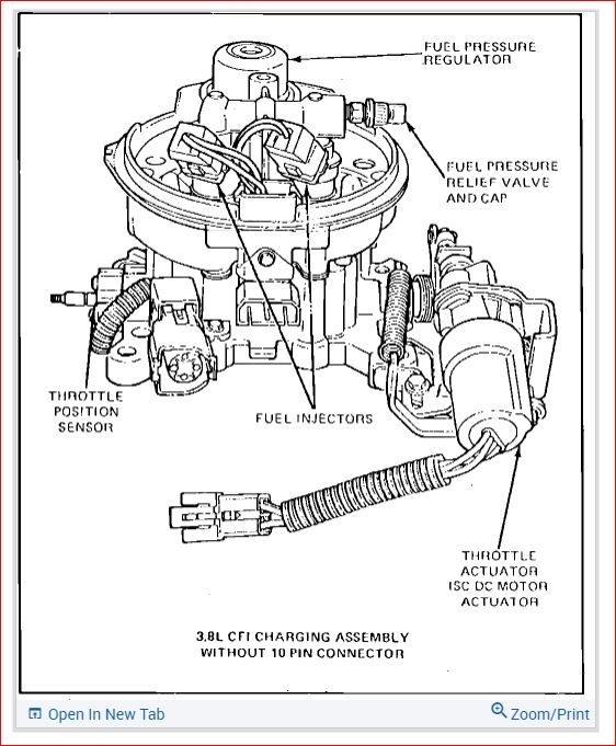

That is good that you are getting fuel to the engine however, do you know if it is getting to the combustion chamber? If the engine starts with using a starter fluid then clearly your fuel delivery is the issue. These cars use what is called a fuel charging assembly. I attached the detail about it but basically you want to make sure your regulator is not preventing fuel from entering the engine.
If you look at the fuel pressure relief valve and cap, this should be a schrader valve where you can screw on a fuel pressure gauge. Also, this should be after your regulator, so if you have low or no pressure then the regulator is your issue.
Start with getting a fuel pressure and we can go from there. Thanks
