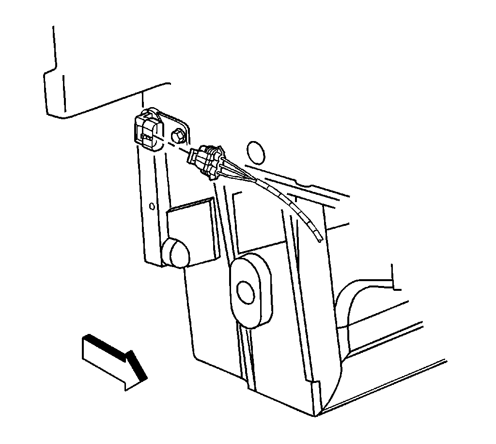

pic 1
1. Remove the starter.
2. Disconnect the crankshaft position (CKP) sensor electrical connector.
pic 2
3. Clean the area around the CKP sensor before removal in order to avoid debris from entering the engine.
4. Remove the CKP sensor bolt.
5. Remove the CKP sensor.

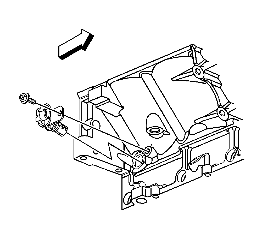

pic 3
1. Install the CKP sensor.
NOTE: Refer to Fastener Notice in Service Precautions.
2. Install the CKP sensor bolt.
Tighten the bolt to 25 N.m (18 lb ft).

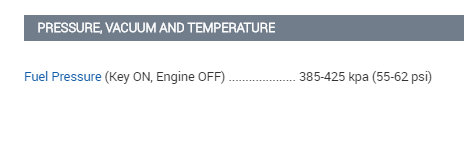

Let me know if this helps. Also, if there are new codes set, let me know what they are. One last thing. The rotten egg smell, like you already know, is related to the catalytic converter. However, often the smell is a result of a rich fuel mixture damaging the converter. Once it is up and running again, make sure the fuel pressure is within spec.
