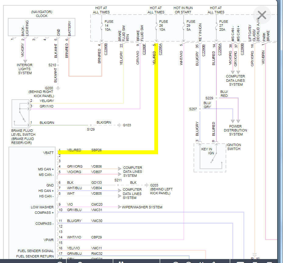

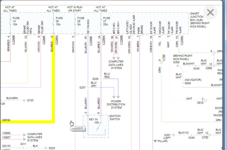

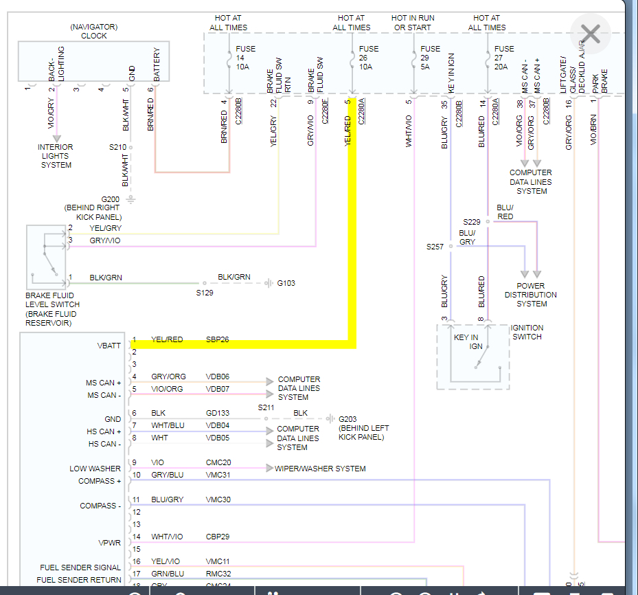

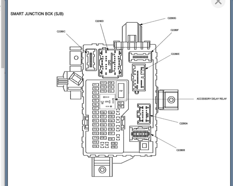

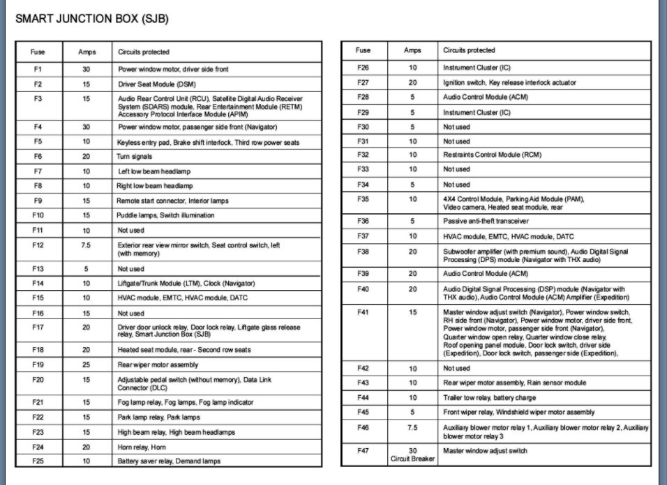

I understand you checked fuses but we need to double check fuse 26 and 29 in the smart junction box. These are what feed the cluster so if the fuses are fine, we need to check power on these two wires at the cluster.
You should have 12 volts when the key on. However, I am thinking the SJB is the issue with the key not coming out as well.
Let's start with this before you replace the SJB because we need a little more proof first.

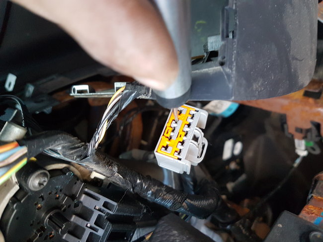

I did check the fuses 26 , 29 they are good. I have opened ignition panels and took out the connector that goes to the ignition lock and there is power in 2 of the points. I will attach the picture. I will need further assistance.

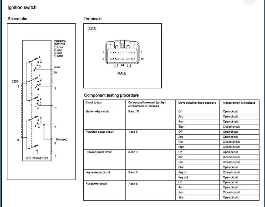

I am not sure I understand why you are checking power at the ignition. Is the ignition switch operating? I thought the issue was just all these other components were not operating. If they are not, then we need to go to something that is not working and check power. I suspect you will not have power and if not, then we need to trace it back to find where there is power or to the SJB.
I still think there is an issue with this as it is what supplies the power to these components. Let me know what you find with one of these things that is not working or let me know if I am not understanding the issue. Thanks.
Apr 7, 2021 at 7:03 PM
KAYMANN1
  • 12 POSTS
Thank you for replying back to me. Ignition switch doesn't work. Key in the ignition turning it nothing happens. I checked the fuse 26 and 29 they are good. Do you want me to get sjb?
Apr 7, 2021 at 11:23 PM
Not if you have power to it. The SJB would be if all these items did not have power but if you checked power and it is there at the ignition switch then we need to do this testing. Please see the attached. Basically you are putting your test meter or test light in these pins and putting the key in each position. The light should light or have resistance (ohms) when the chart says closed circuit. All open circuit rows on the chart the light should be off or your meter should say OL.

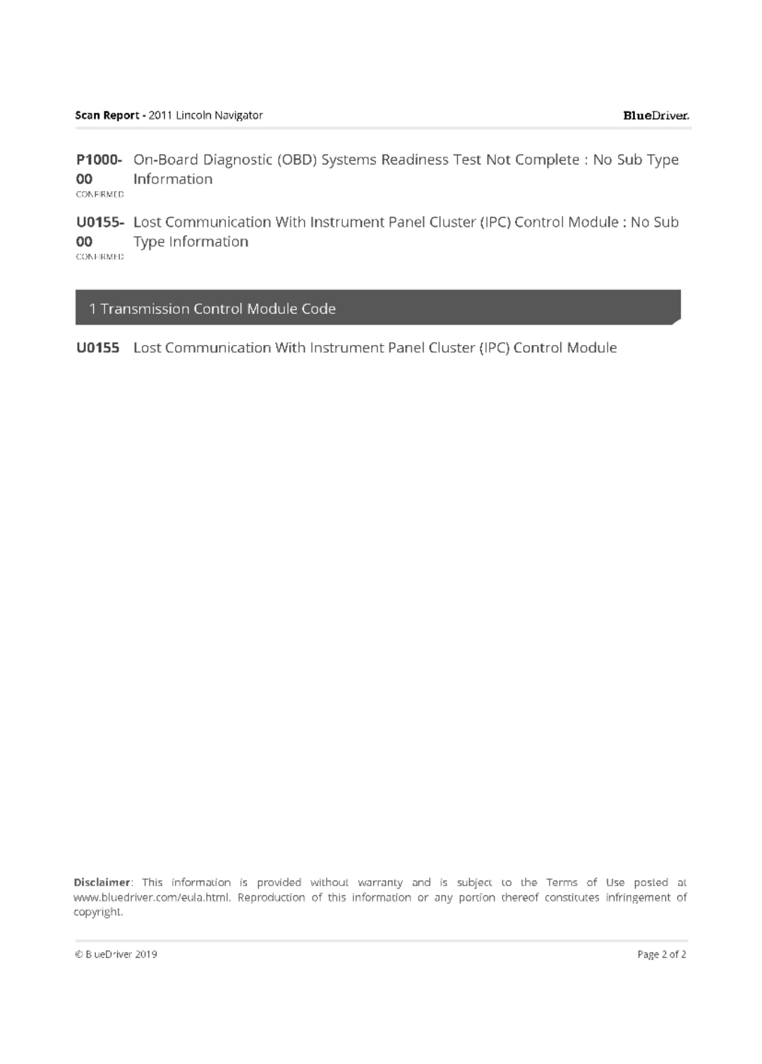

I was able to put my blue driver in the code reader and so many codes popped up. Can I send you pdf please let me know.
Thank you,

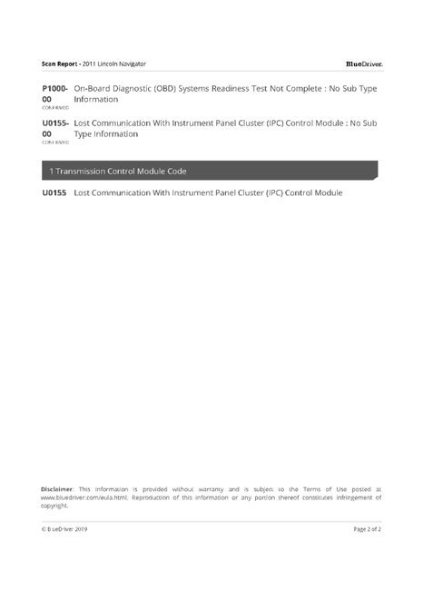

Apr 20, 2021 at 6:58 PM
KAYMANN1
  • 12 POSTS
I am attaching list of the codes I got while scanning it.
Thanks
Apr 21, 2021 at 1:46 PM

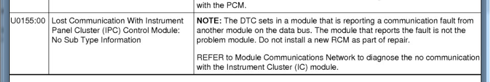

Okay. Those are all pointing towards a loss of communication issue. However, that many codes may be due to unhooking some connectors for testing.
It appears this issue happens enough that I would suggest clearing all the codes and then getting it to act up again just to see which of these codes come back. The reason is, you have airbag codes in there as well and that is most likely a wiring issue but would make more sense as they set when you had some connectors unhooked.
Let us know and we can go from there. Thanks

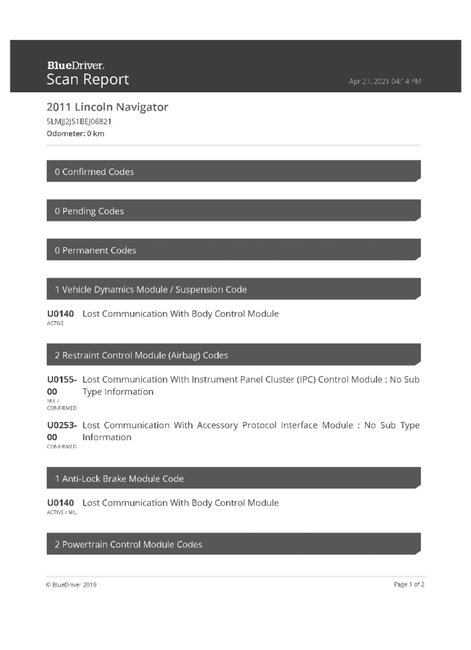

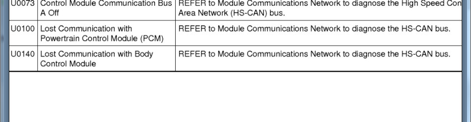

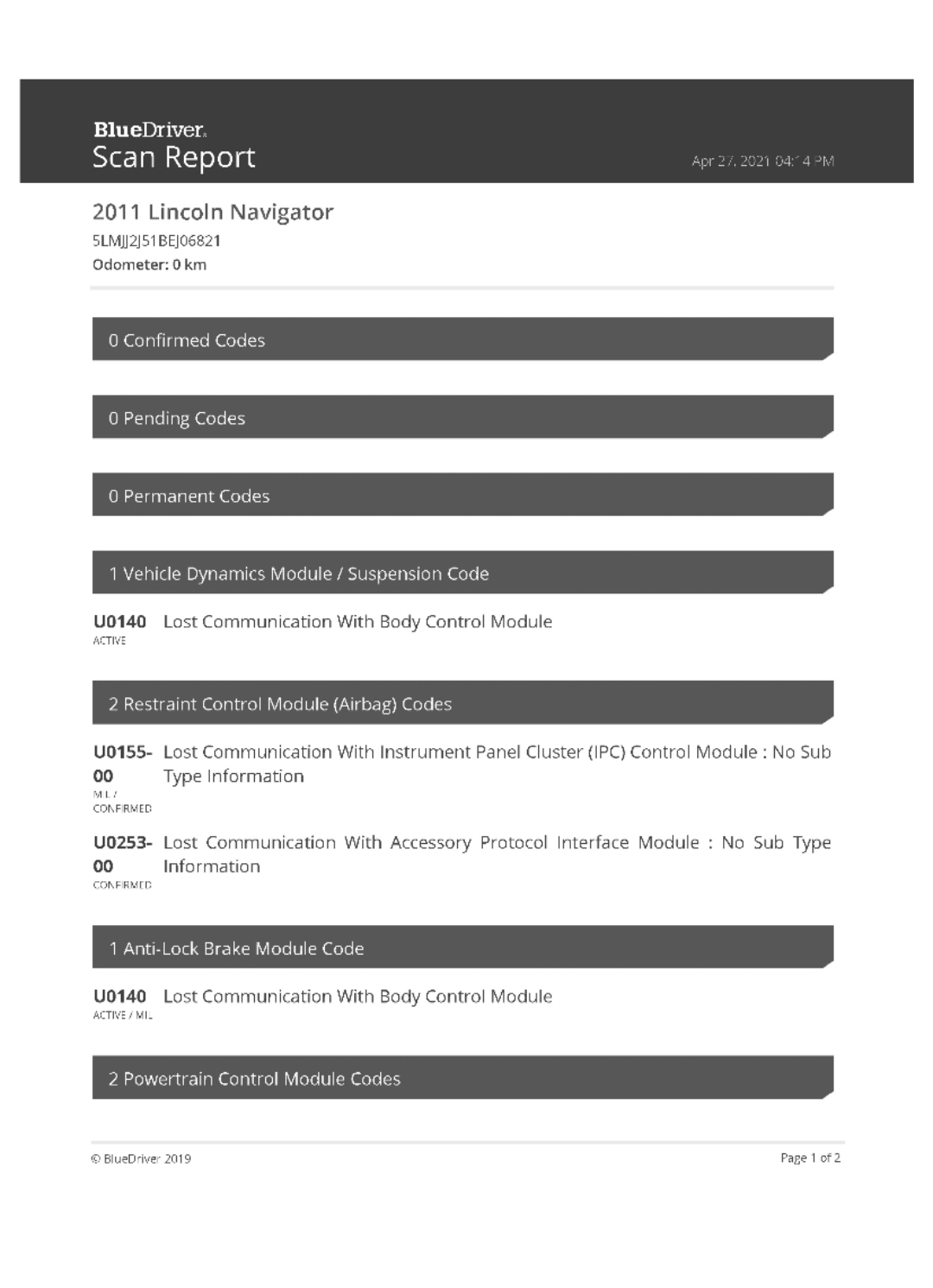

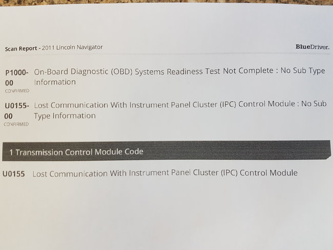

Hi.
I have cleared the codes and scanning it afterwards it showed few codes and I will be attaching the pictures with this message. Please advise me the next steps. Thank you for your guidance.
Apr 27, 2021 at 9:06 PM
KAYMANN1
  • 12 POSTS

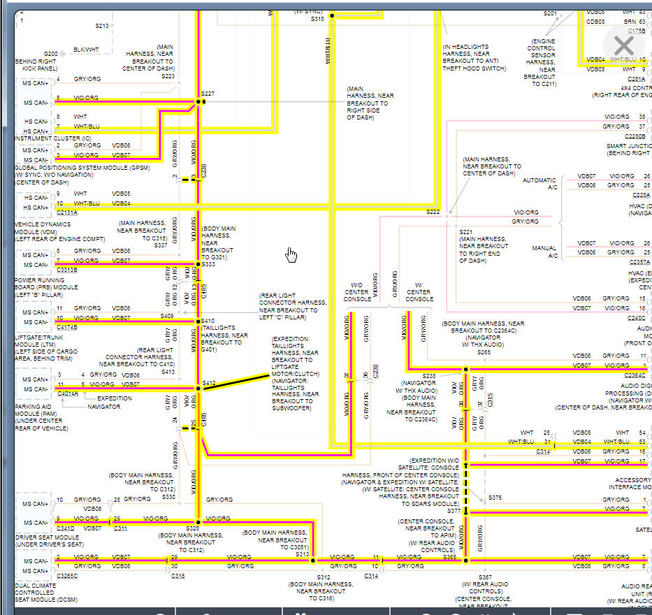

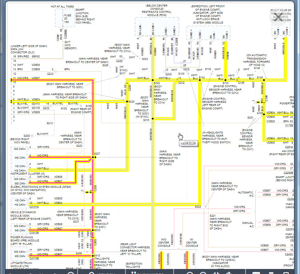

This is a network issue as I suggested above. Here is a guide that talks about this:
These are very difficult to figure out but we need to start with checking voltage at the DLC on pin 6 and 11. This is the high speed network and it has two legs. When those voltages are added together they should be 5 volts. However, they are split and will be around 2.7 and 2.3 volts.
I attached the wiring diagram for this. Depending on the voltages we will need to remove each of these modules one at a time until the voltage returns to normal but let start with finding out what they are.
Thanks

I checked the pins on dlc below are the volts multimeter showed
Pin 6 0.01 or 0.00
Pin 11 1.52 or 1.53
With kzyee super probe
Pin 6 0.00 volts
Pin 11 1.3 volts
May 1, 2021 at 8:03 AM

Unfortunately it appears the CAN + is shorted to ground and that would explain most all your issues.
These voltages need to be 2.7 and 2.3 volts so in order to find the short we need to prove that out first.
These for continuity to ground. You do this by taking your meter and putting it on resistance (ohms) or if you have a continuity selection then that is what we need to test. This will tell us if this circuit has a path to ground. It should not have continuity or any resistance. Just let me know what this measurement is and we can try to narrow it down but it is not going to be easy.

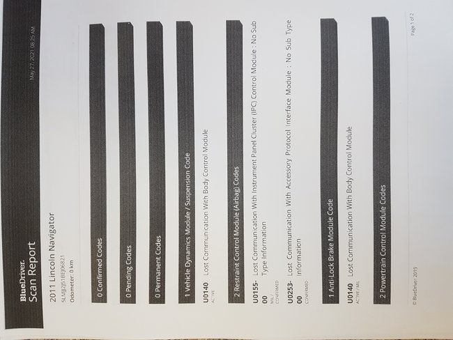

I did a scan again and I am going to attach the results. The attachments you sent does make a sense about BCM . Let me know about the network tests you want me to do . Seems interesting something new to learn.
May 27, 2021 at 3:42 PM

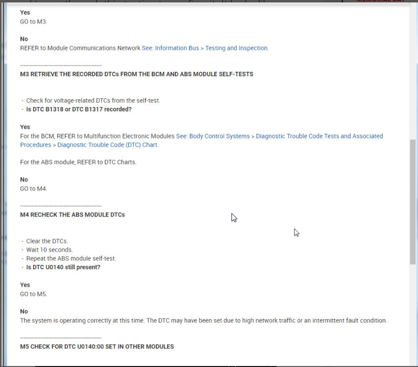

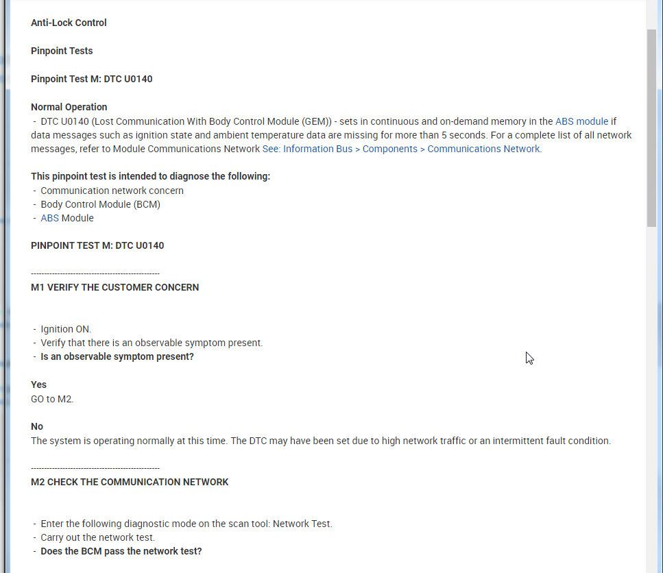

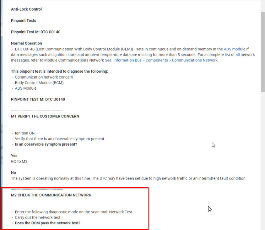

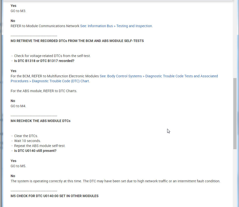

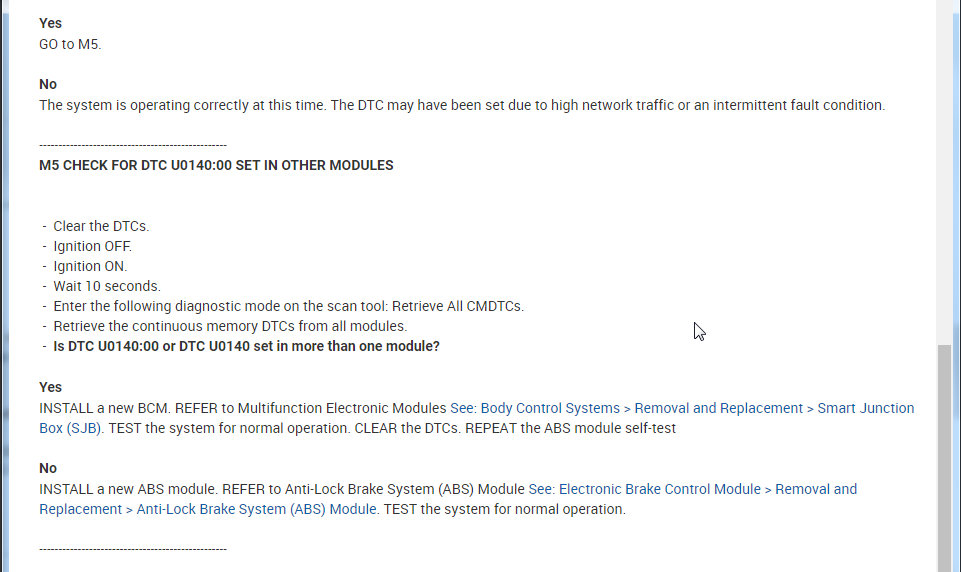

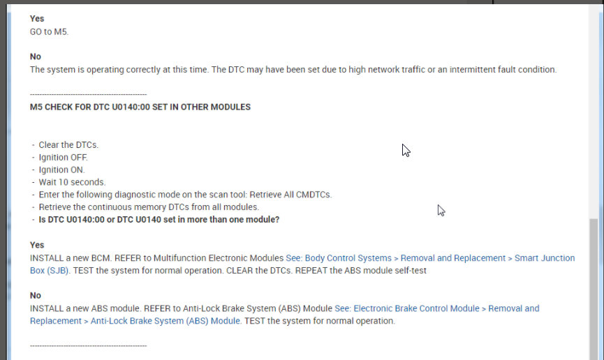

Okay. That is good that it is the same codes. So the network test is not something that we can do. It is a scan tool function but it is not something that the generic scan tools will do. This is an OEM or equivalent tool.
Take a look at the attachment below and it is M2 that talks about it. What I would do is just check around for a shop that has a tool that can do it and just have them run through this testing and pay the diag charge rather then buying the tool. Unless you are going to be doing this type of diagnostic work more frequently it really is not worth buying. They are normally a few hundred dollars at a minimum and you will pay less to have a shop do it as you will likely not need to do it again.
If you want to purchase one, then just make sure it is capable of running CAN network testing. You may want to call the company and ask just to make sure.
Let me know if you have questions on this.

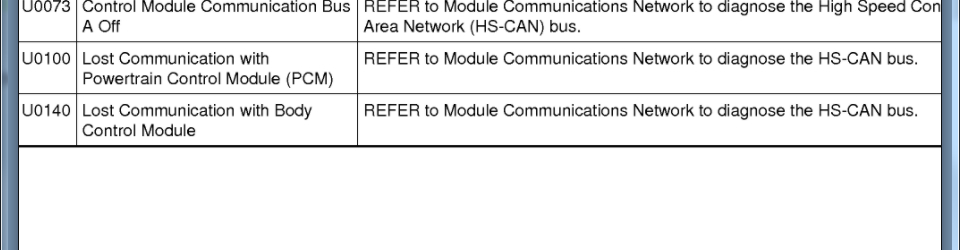

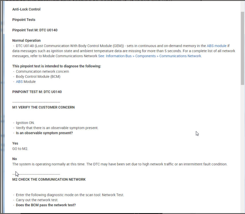

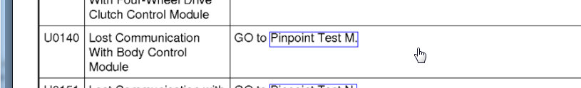

However, based on your codes, I am not sure you need it. Basically what the U0140 in the ABS is saying is that it is not getting the proper message from the BCM.
This could be due to the communication network, the BCM, or the ABS module.
If you read through the test and make the assumption that the BCM will pass the network test which means it is not a wiring issue or other network issue then it leads you to replacing the BCM after you answer the remaining questions.
So you can get this tool as it does a lot but replacing the BCM may be the solution to these codes. Depending on the price of the BCM, I may just go with that rather than a scan tool that you may not sure all the time.
Run through the testing and confirm you are seeing the same thing.

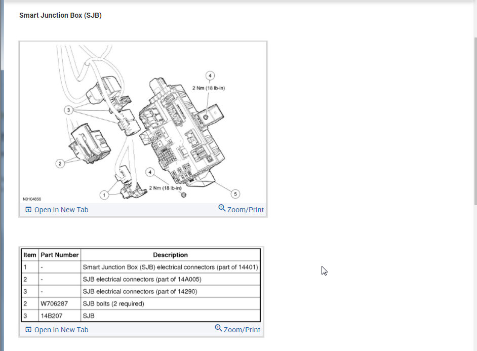

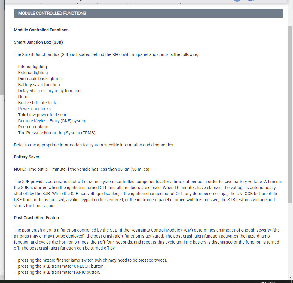

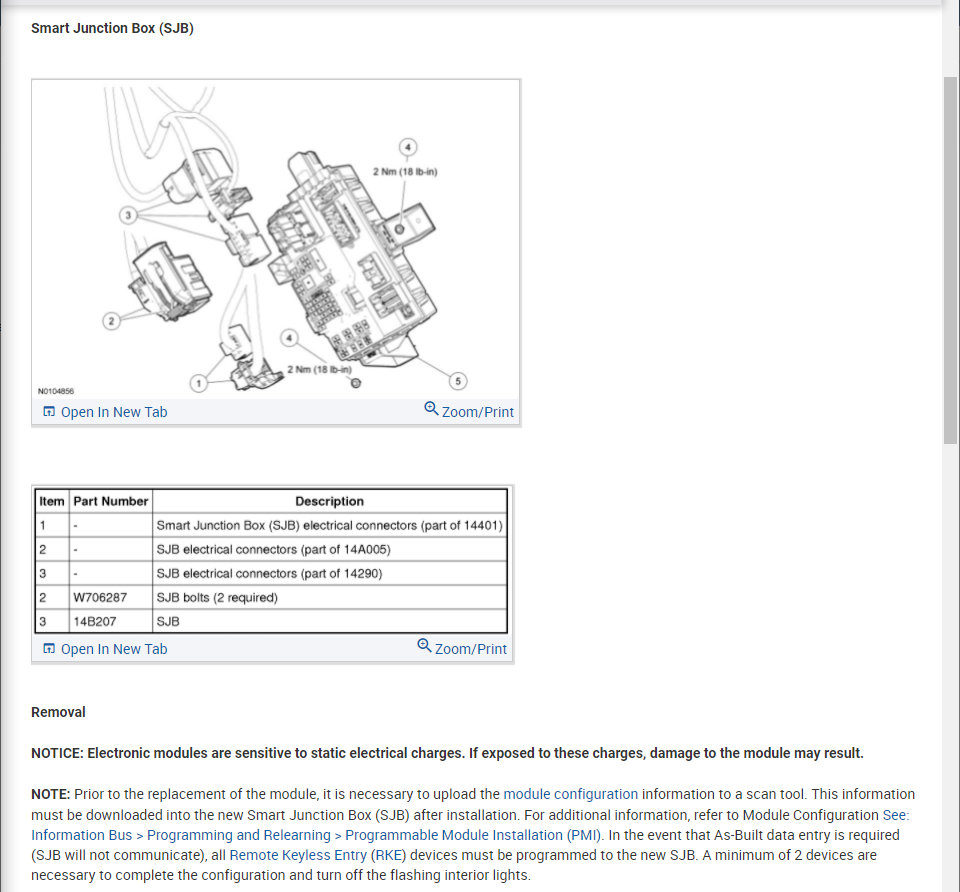

I think the issue you are having is the body control module is a pretty generic term. On your vehicle it is called the smart junction box.
Take a look at the info attached that gives more detail on this.

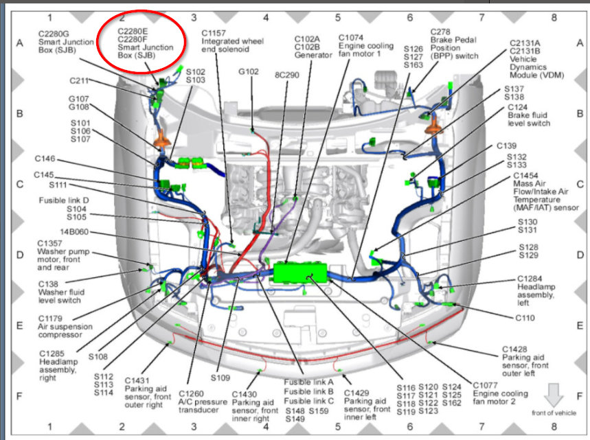

Jun 24, 2021 at 1:30 PM

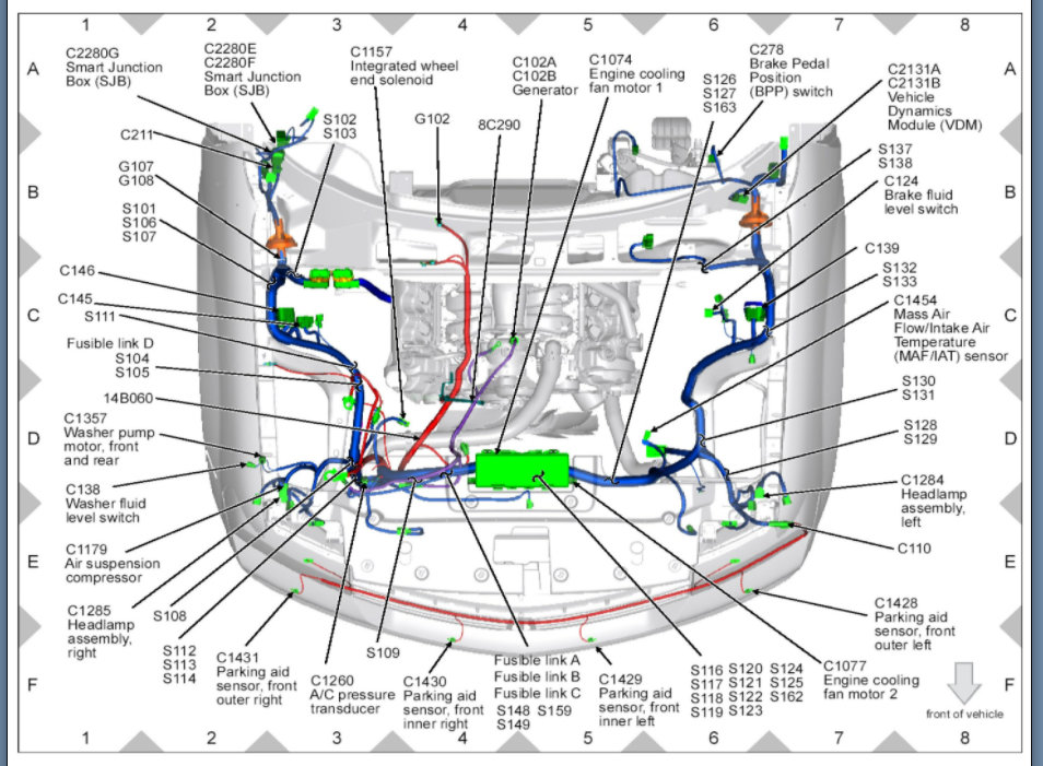

Those are not identical part numbers but more than likely there was change made to the part and when that happens they change the part number slightly.
I suspect they are correct that they are interchangable. However, they should be able to confirm that by checking that part number.
Take a look at the diagram for the location of this. Thanks

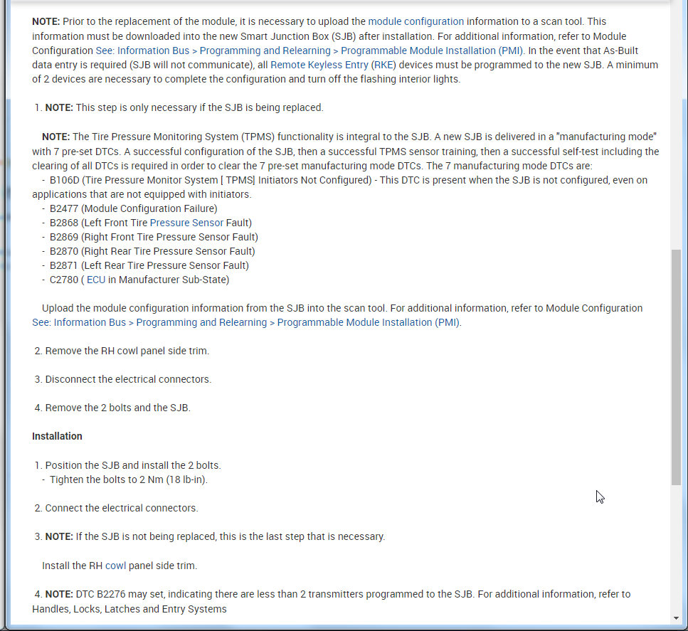

KAYMANN1
  • 12 POSTS

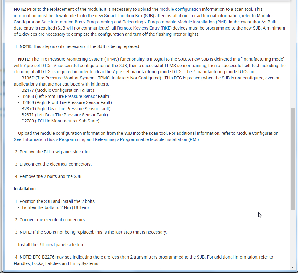

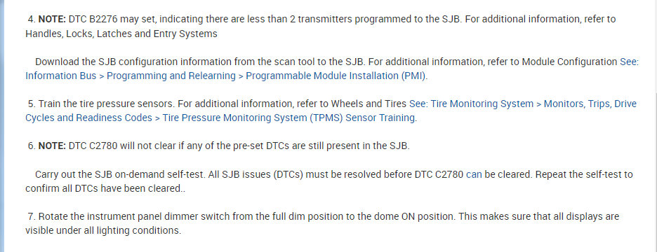

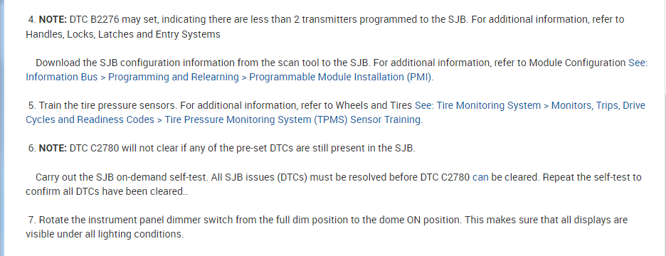

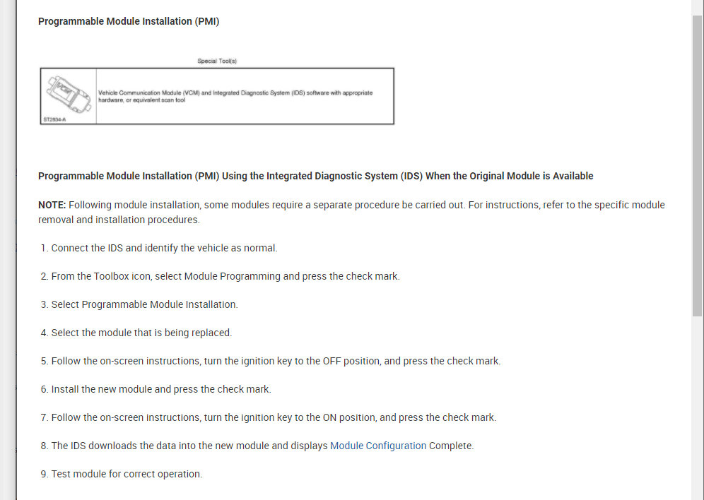

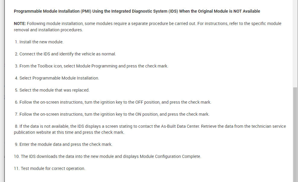

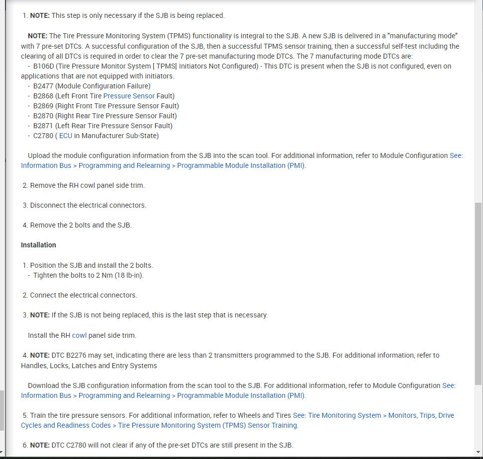

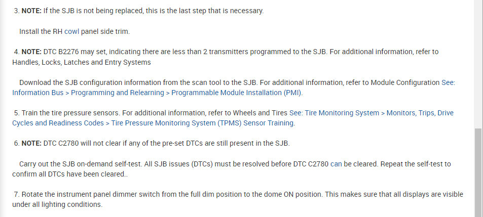

I just bought brand new SJB . Is it complicated to copy data from old SJB and transfer to new SJB? What kind of equipment do I need to do it?
Thank you
Jul 6, 2021 at 5:58 PM
There is a process. You need to upload the current SJB info and then put it into the new one. You can do it when without uploading the info but either way it requires a scan tool that is capable of performing this function.
Attached is the process that you will need to follow. If you don't have a scan tool then we will need to find a shop that can perform this for you.
Jul 7, 2021 at 5:39 PM
