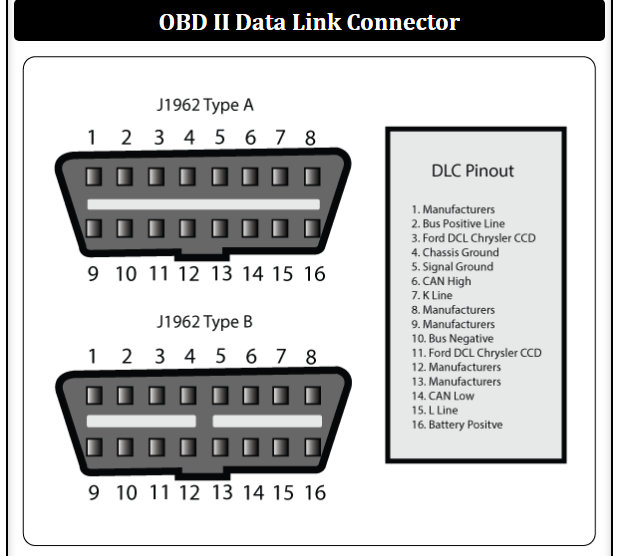

When I hook up my Actron scanner tool to my obd port, it comes back with a No Data Link
1999 DODGE TRUCK
274,000 MILES • 5.2L • V8 • 4WD • MANUAL
KARTZ
  • 6 POSTS
message. My scanner works on all my other vehicles, (except my 1991 Bronco-that needs it's own scanner).
I changed the dashboard completely about 3 years ago because they all fail in Dodge trucks but I also had other issues with the HVAC that I won't go into except to say that the previous owner did a real hack job on an attempted repair of the heater core and blend door actuator. They cut the shell in half at the bottom and tried to reassemble everything with foil tape. Didn't realize any of this until after buying it. Just wondering if I missed a wire, connector.. Can't remember if I ever scanned it before replacing dash. Haynes Manual shows diagram that says pin 45 is data transmission, pin 46 is data rec. I'm guessing that the PCM is receiving data as all the idiot lights go on in key on mode and I have a check engine light on-just no communication to obd port. Should there be voltage signal on that terminal at the port? If so, how much and which terminal at the port would be the one to get the data for the scanner at the obd connection?

Good afternoon,
There is a serial data lines at the connector that need to be checked. I attached a picture of the connector and need you to test the ohm reading at pins 6 and 14. Red end in 6 and black lead in 14.

Hey Roy. Thanks for getting back with me. So after hooking up my leads every way I could think to try, direct probe, back probe, pin probe, key off, key on, I get no resistance readings. Stays on "1" which with my meter is over range or not connected.
Sep 4, 2019 at 8:32 AM
If you do not get a reading of 57 to 60 ohms on those 2 pins, going in from the front, there is an issue with the serial data line.

Thanks. So my 6-pin is green. The 14-pin is white with light purple. I've been looking for schematics to see where I can do a continuity test on those wires. There must be other connections in line to the PCM because nothing matches there. Do you know if that is correct? Also, in my initial contact to you, I was wrong. The manual actually has pin 45 at the PCM as data link rec. and pin 25 as the data link transmission. I was just writing it at first off the top of my head. So yea, I'm not getting any read from those two pins, 6/14, that is. As far as the troubleshooting goes, I'm guessing that's what you're suggesting is to trace the wires? I hate doing that! I mean I can, I'm just not good at it.
Sep 4, 2019 at 11:04 AM
Those wires go to all the modules that communicate by serial data.
The fact there is no ohms reading indicates an open circuit somewhere with the modules. It is not as easy as ohming out wires at all.

I would inspect the harness for any damage. Finding wiring issues is time-consuming and frustrating. Try disconnecting the modules and retest to be sure one of the modules is not pulling down the signal.
