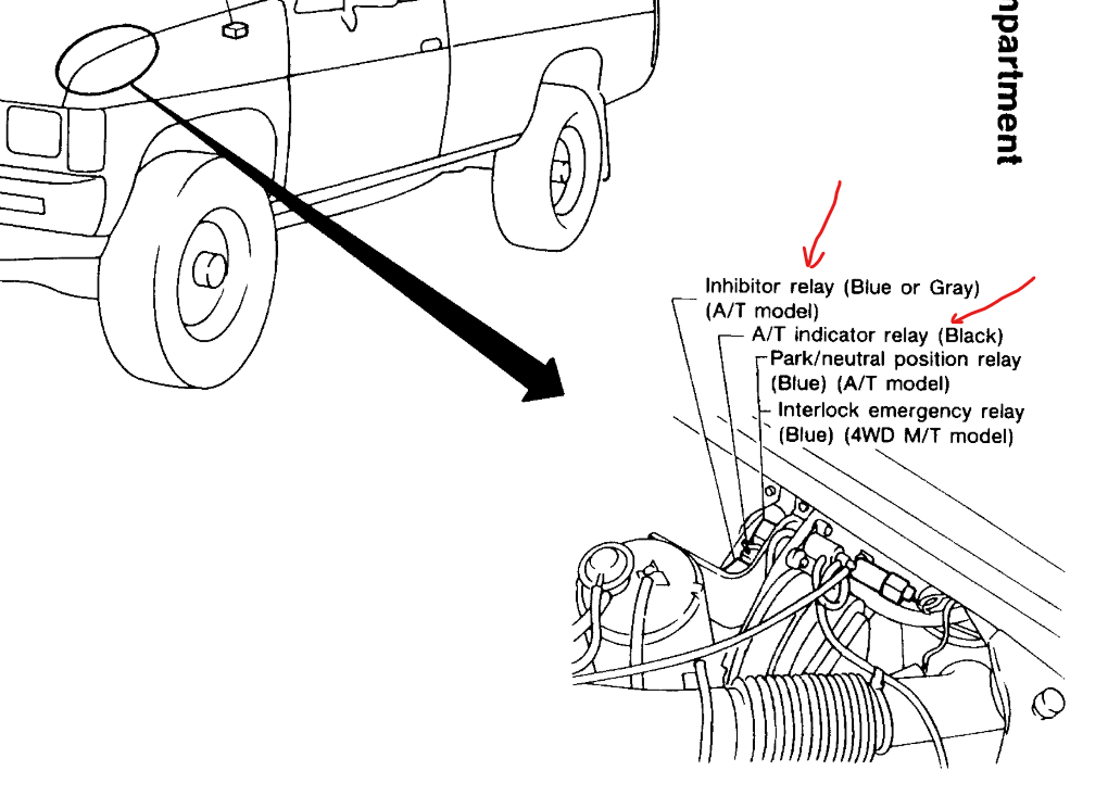

No crank, no start location of starter relay?
1995 NISSAN HARDBODY
68,737 MILES • 2.4L • AUTOMATIC

Yep, I got you covered, here is the location of the starter relay which is called an inhibitor relay. Let me know how it goes.

Yo, thank you strailer. The relay labeled inhibitor is on the passenger fender wall. None of the relays elsewhere have any label. The relay you point out always seemed to be the likeliest. I will use the info you thoughtfully provided to me and I will keep posting progress
