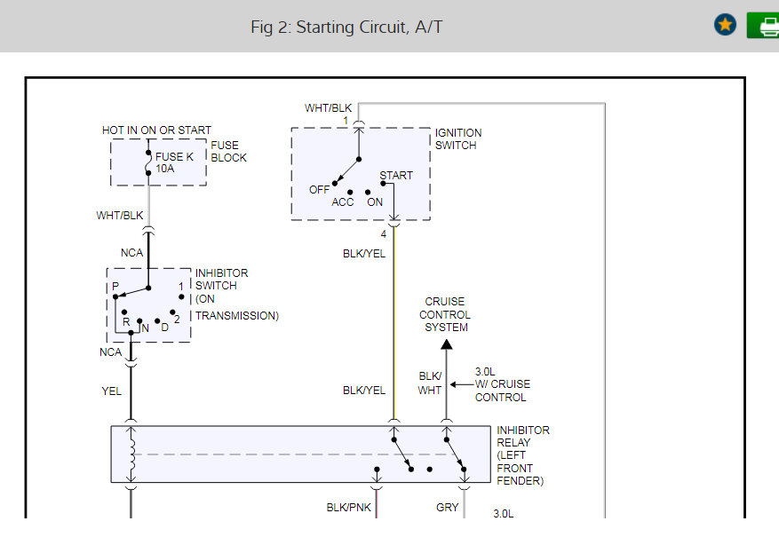

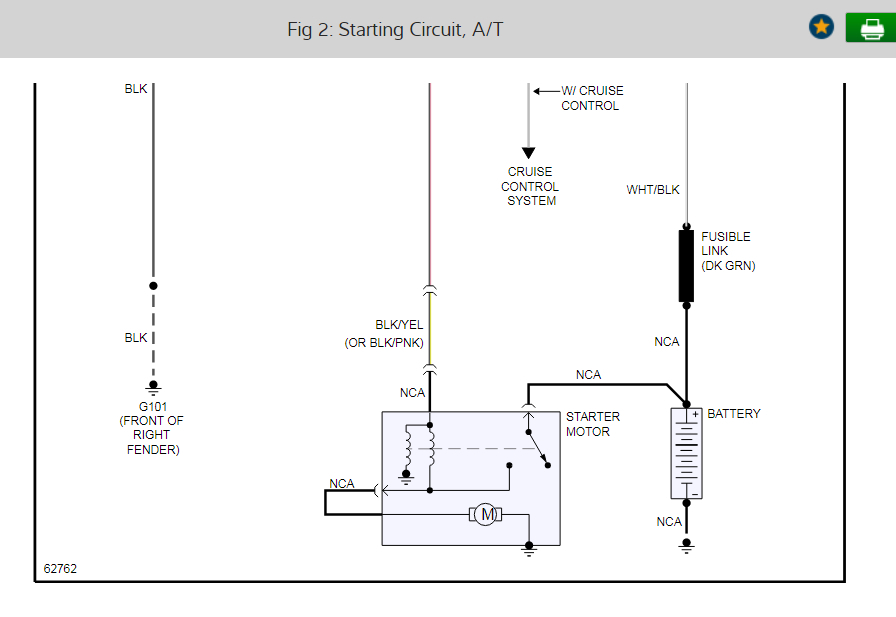

No crank no start no click power to everything else
240,000 MILES • 2.4L • 4 CYL • 2WD • AUTOMATIC
DARREN DESOTO

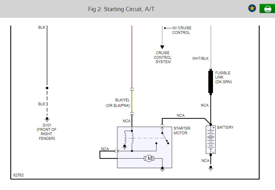

This is an automatic on the column. All electrical works but no power to starter solenoid. Won’t turn over, relay won’t engage. Bendix won’t engage while in truck. Removed starter and tested and it is good. I removed the neutral inhibitor switch to see if I had power at the switch but the color code was different than on the wiring diagram I have. It’s all solid colors. The diagram I have shows 2 colors on most wires. So the correct starting system wire diagram would definitely help along with the correct location of the inhibitor relay. Any other input would be deeply appreciated. May be also the diagram for the ignition switch because I am thinking that would be my next guess.
Sep 6, 2019 at 11:55 AM
SCGRANTURISMO
  • 4,897 POSTS

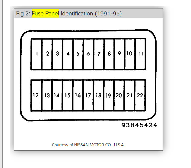

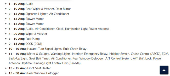

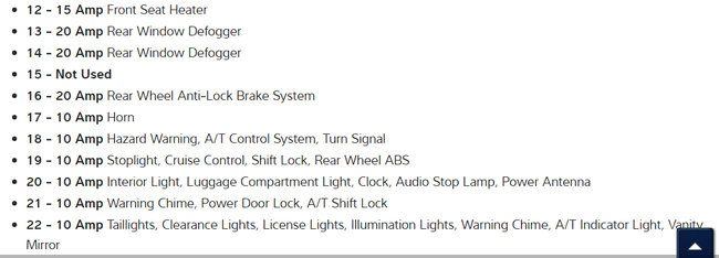

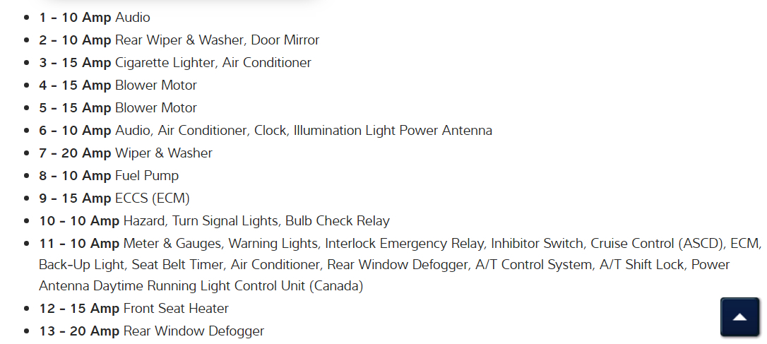

I have included the wiring diagram for your vehicle's starting circuit in the diagrams down below.I have also included a diagram and callout for your vehicle's fuse panel as well. Please check Fuse #11(10A) in the fuse panel. Here is a link if you are unfamiliar with how to do that:
Please go through these guides and get back to us with what you are able to find out.
