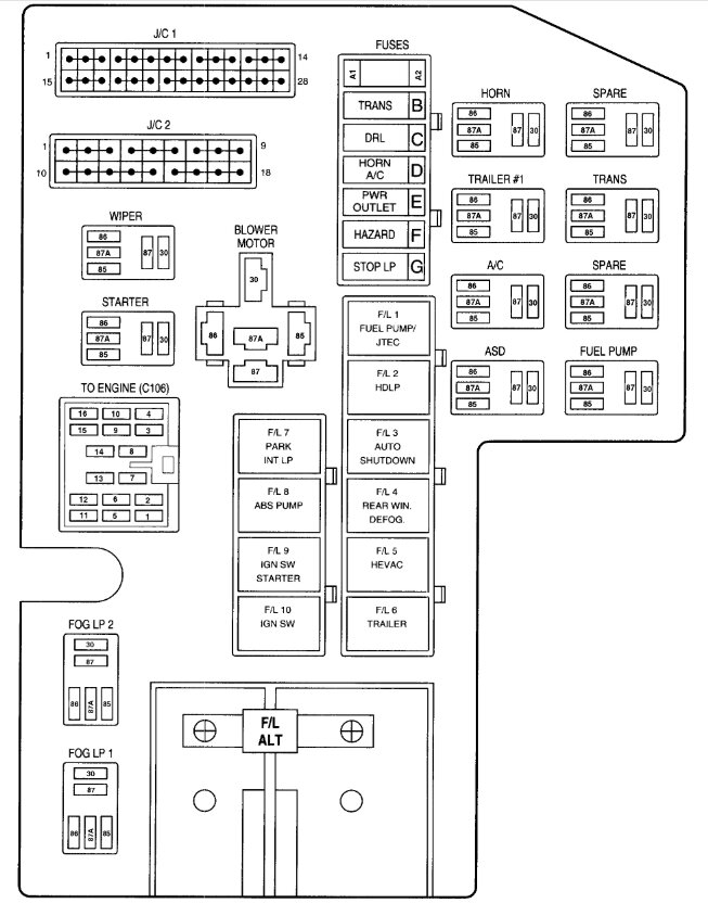

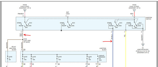

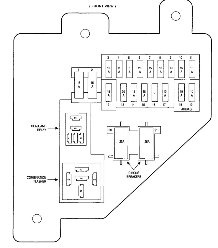

will not crank or start, interior accessories are nonfunctional like windows won't roll down, HVAC is nonfunctional, auto interior lights are nonfunctioning, and now recently reverse lights quit working. the vehicle will run if key is turned on and starter jumped, but none of the above still won't function.
Nov 30, 2024 at 2:23 AM
  • 55,443 POSTS
Most of the time when this happens the ignition switch has gone out, which is common, but we should check the fuses and the power going to the fuses with the key on.
Here is a guide to help and the fuse locations:

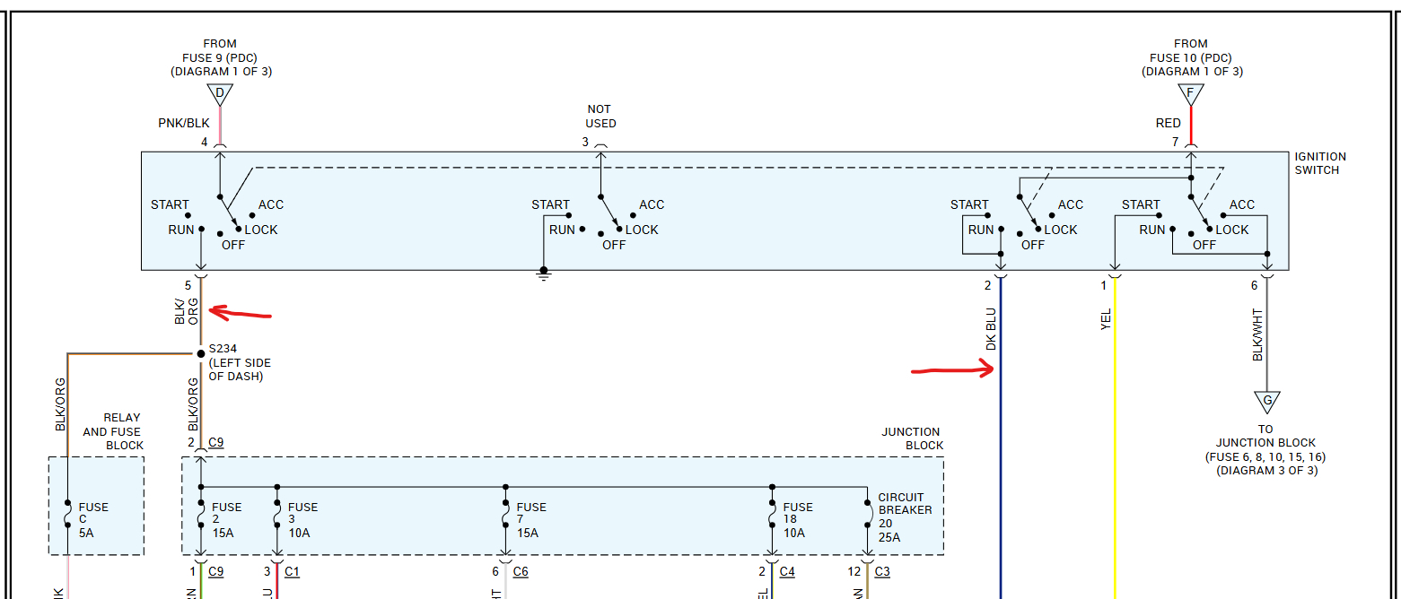

If most of the fuses do not have power let's check the ignition switch which I have marked the wires that should have power with the key on.
Check out the images (below). Please upload pictures or videos in your response of any problems so we can see what to help you with.
